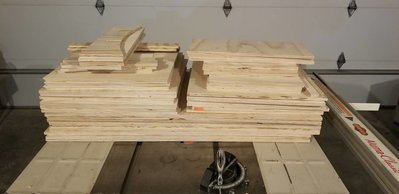

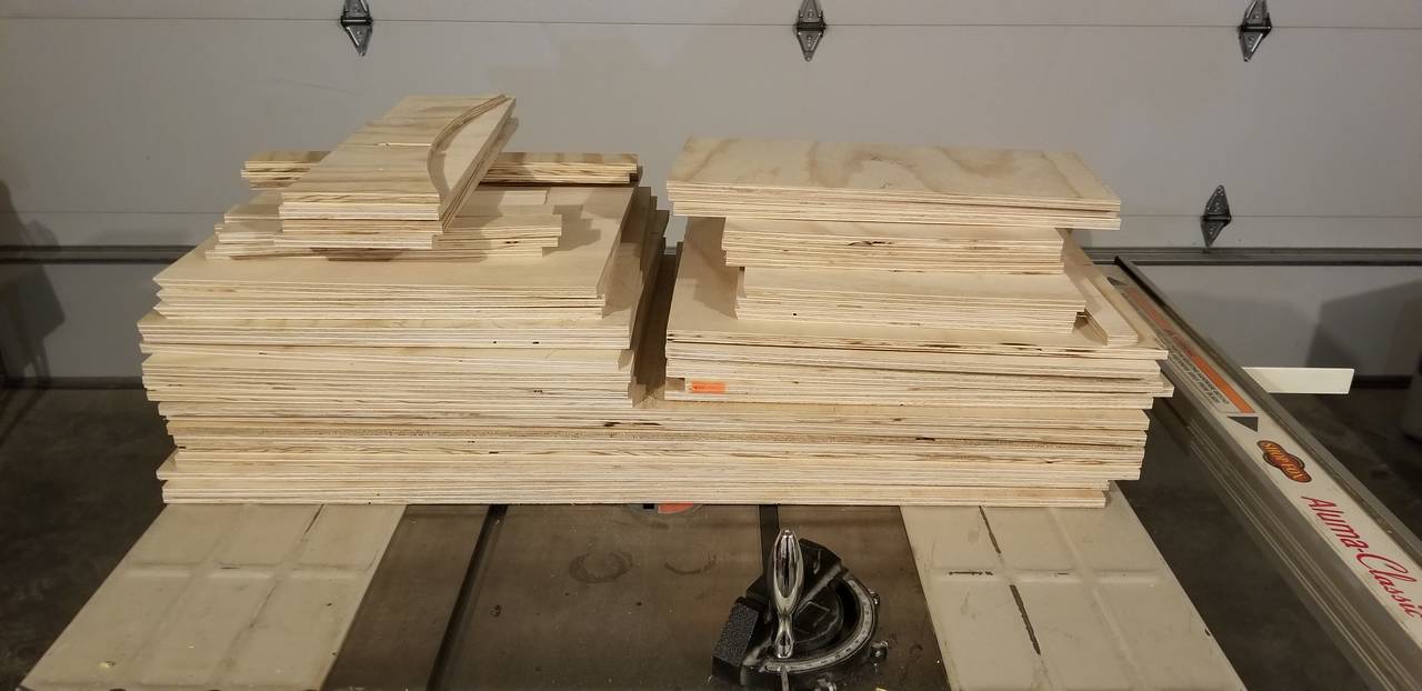

That means I'll be away from the family....and my tools for a year. I don't leave until next spring but I wanted to get a jump start on the other three T39s. Last night and today I just cut all the panels. I still have to cut the holes in the baffle and driver anchor, finish shaping the mouth braces, and cut panels 7 and 9. I can't make panel 9 per the plans because the handles I'm using require more space so I'll have to figure that out as I go along.
My top and bottom bearing trim bits pissed me off though. I cut one mouth brace and was using it as the template. The bottom bearing router bit had to be set so low that it dug into my work bench. And the top bearing router bit had the same issue: it had to be set so low that it would've traced the outline into my workbench. WTF am I missing? Are these supposed to be used exclusively with router tables? I'm sure there is a simple fix, I'm just having a damn blonde moment.
Fun fact, ACX up here in Minot, ND is severely warped when you buy it. I've had to spray hot water on the concave side and lay it convex side up over night so that it will straighten. I did that with all 4 sheets stacked, then sat all the heavy shit I could find on top. By morning, they were much easier to work with. Matter of fact, I didn't notice any warp at all the next day.
Anyway, here's where I'm at so far...

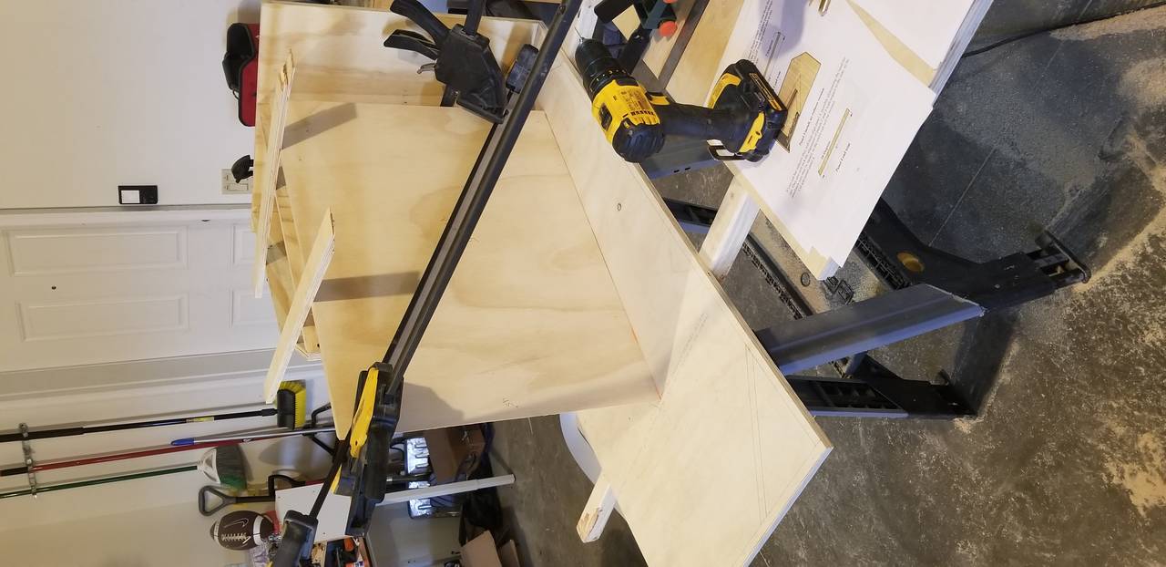

I didn't have carpet tape so I did what Bill said: I screwed the template and a 2" x 4" to my workbench and traced the pattern with a bottom bearing router bit. I didn't take photos of the vertical mouth braces because they're nothing spectacular. Matter of fact, I'm wondering why I made the curves in the first place since I cover it all with a grill.

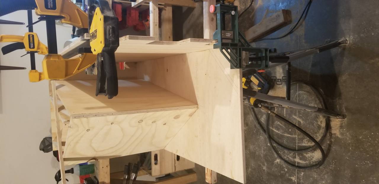

I didn't get as much done this weekend as I wanted. The spousal unit kept me pretty busy putting summer stuff in storage and cleaning. However, I did get the baffles and driver anchors cut and mated. Then I started constructing the first of three cabs.

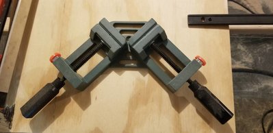

Also, I got some corner clamps from Harbor Freight that made my life really easy when installing panel 1. I'm sure they will be equally helpful with the back, bottom, side.

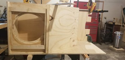

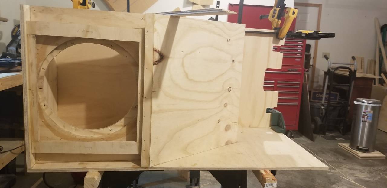

Re: Titan 39 Build
I know I said I was gonna batch build these....and I am. But I decided to do the one first to remind myself of the build process, then I'll batch the last two. It has been 6 months since I built the first one so I'm a little rusty on the process. And I'll tell ya, those damn HF corner clamps are saving my ass. They take mild warp out and ensure a perfect joint almost instantly.

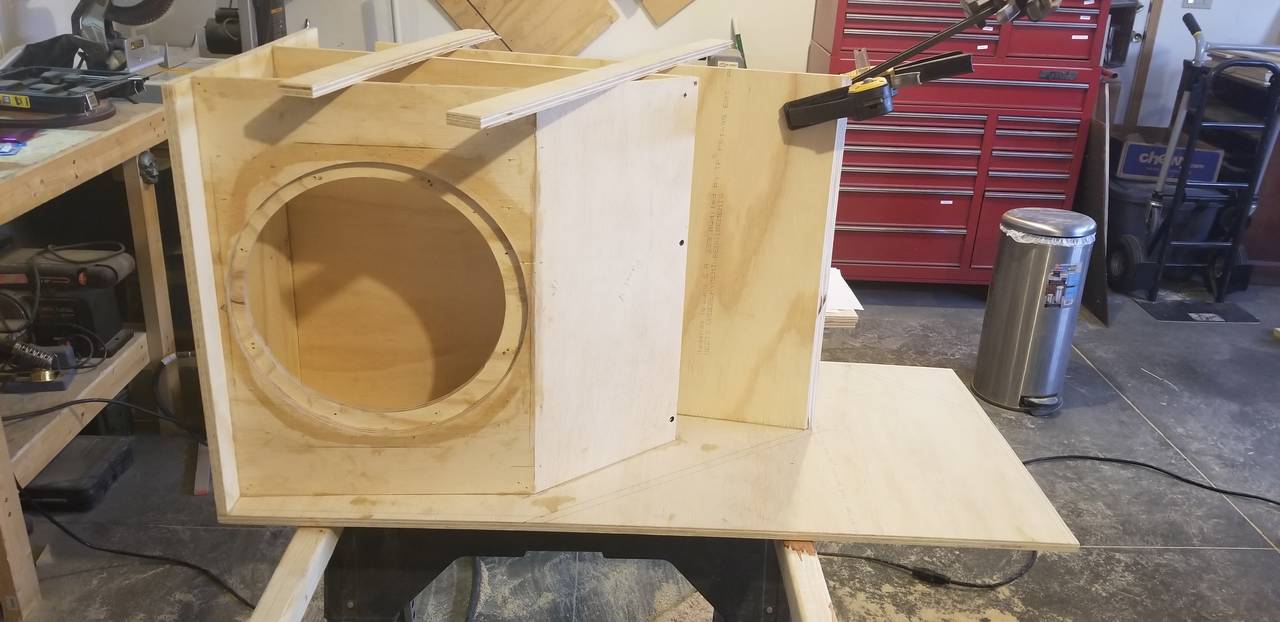

I got a few hours to myself today so I routed the cavities for the handles and casters. Then I installed panel 5, 6, 3/5 braces, 4/6 braces, panel 8, panel 6 extension, vertical/horizontal flanges, and the flange/baffle braces.

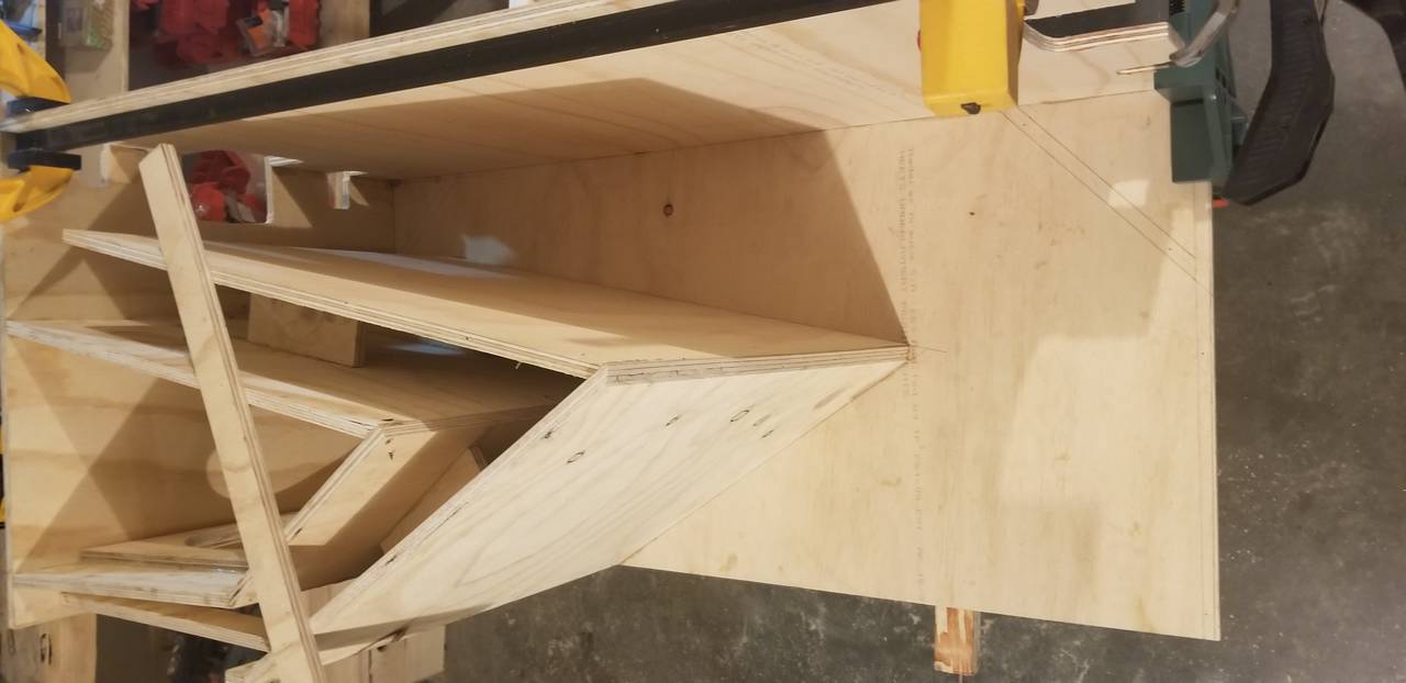

Re: Titan 39 Build

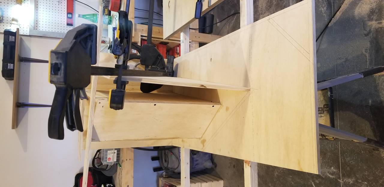

Before it is mentioned, I know I messed up that vertical brace.
I haven't investigated why I made such a boneheaded mistake but I will as soon as I get more garage time. Luckily, this is a lesson I can afford to learn. The mistake can be easily covered by panel 7 and I will have ample space to mounter the driver cover.
