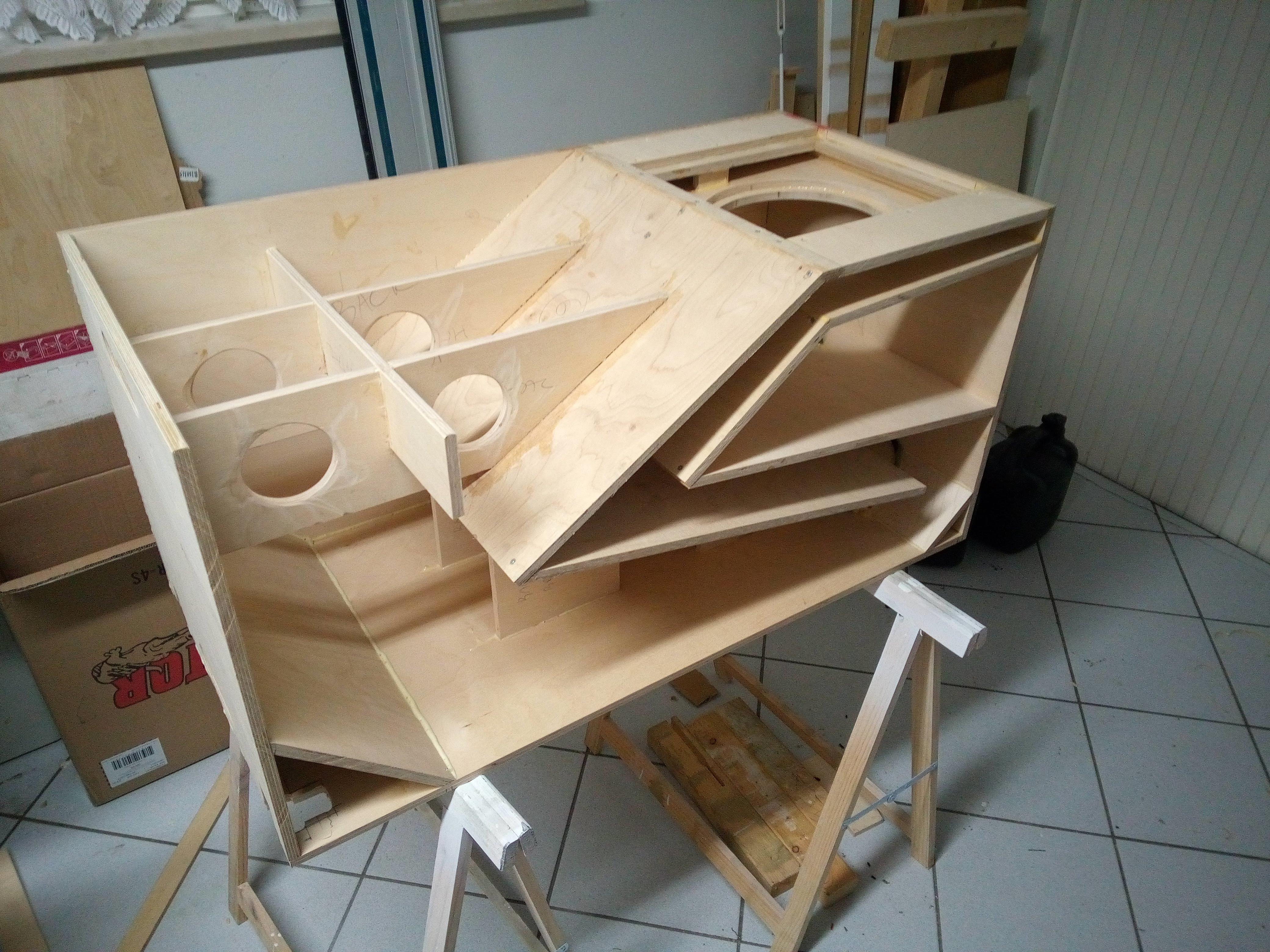

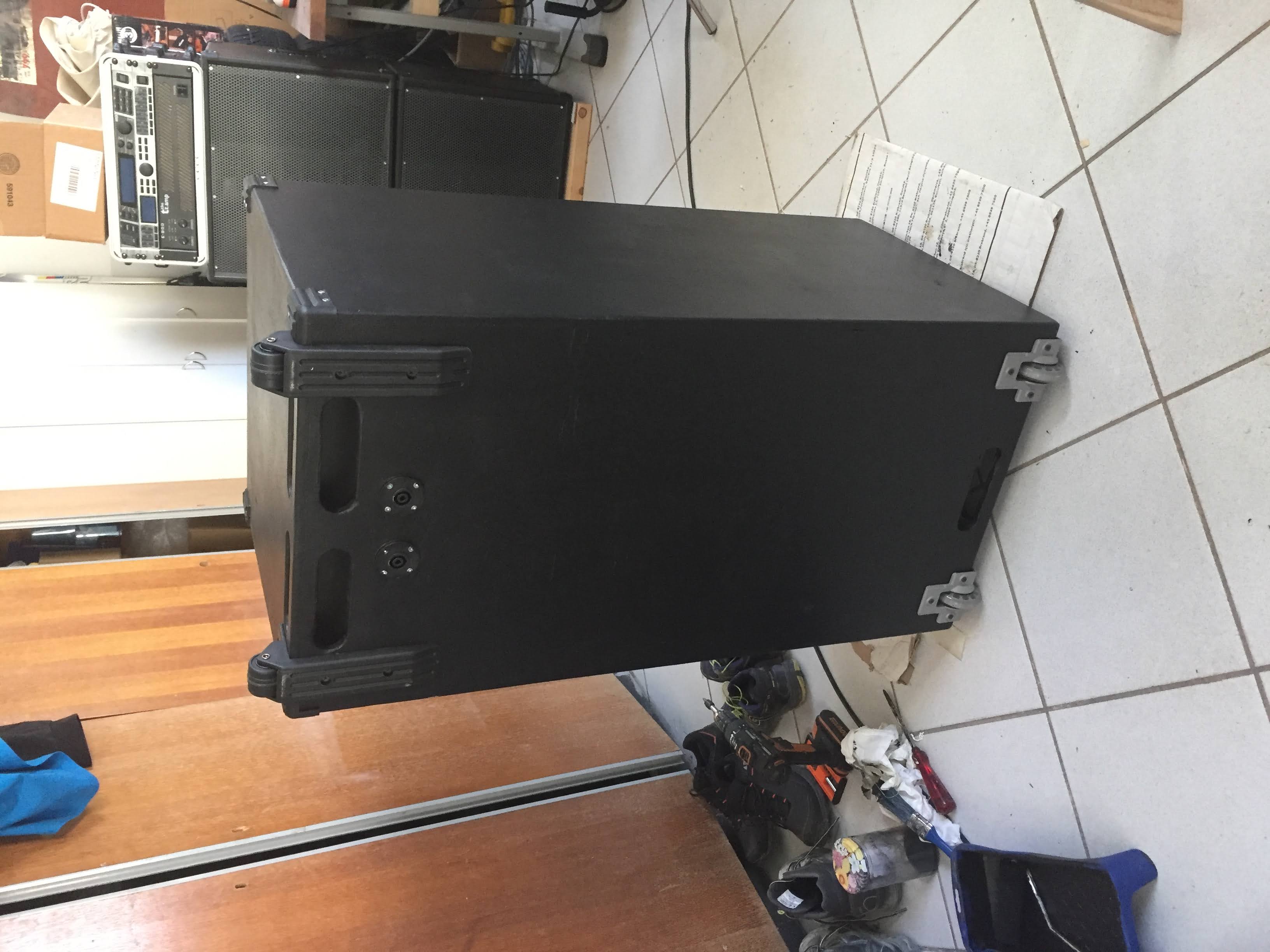

UPDATE:
Hello all,
Already in 2020 I have finished my build of 1x Titan 39, 20" wide, with Eminence Legend BP 102-8 - 200W/8ohm, to go with my 2x Jack 12
I must say it was a FUN build, as far as I remember
But since than I havent really used it properly, and didnt even setup it as it needs to be
Now I would like to setup crossovers and limiters... and then I hope they get some party time
I got a bit rusty in this field, but I hope to get around it again

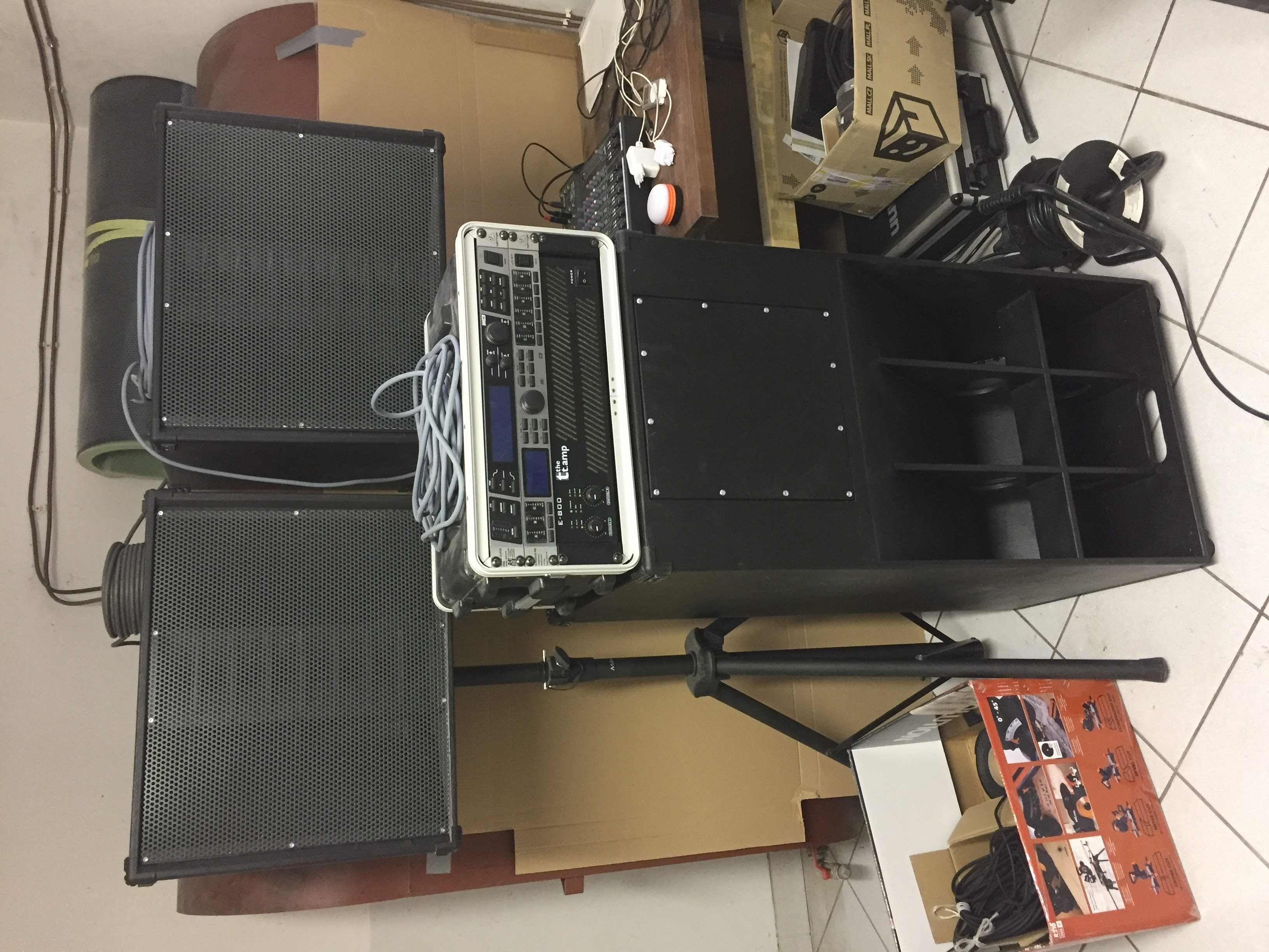

System info:
2x Jack 12 (Eminence Beta-12A-2, 12" speaker, 250watts/8ohm (RMS) with Monacor MPT 016 piezos)
1x Titan 39 (Eminence Legend BP 102-8 - 200W/8ohm)
the t.mix xmix 802 USB, 8 channel mixer
Behringer DCX2496 Ultradrive Pro
Behringer DEQ2496 Ultra Curve Pro
the t.amp E-800 stereo amplifier - output power: 2x 500W into 4 Ohms, 2x 350W into 8 ohms
and bunch of cables, microphone, Gator case...
Now I go and study "How to set up a DCX 2496" viewtopic.php?f=4&t=20833
Hello all,

Re: First Build 2x Jack 112 pics and questions UPDATE: Titan 39
Looks beautiful! I"ll leave setup questions to the veterans here, i'm clueless myself...
Good job on building your cabs.
In your BFM plan of the T39, there are details on where to set the limiter and hi pass for each suggested driver, at the bottom two pages. In your case, 35 volt limit, and hi pass of 45hz.

Hi all,
After some time I have a chance to run my system at some outdoor picnic/party, mostly playing electro music. I havent really took time to setup DCX correctly as I only played some youtube music in my garage, where I didnt need any power for the system.
Yesterday I tried to setup the DCX as in Grant Bunter tread: https://billfitzmaurice.info/forum/post ... ly&t=25148
I did it in MONO, to have less things to worry...
2x Jack12 are daisy chained.
Channel 1 is SUB:
HIGHPASS cutoff is set to 45Hz
HIGHPASS filter type I choose BUT48 and all other filter type are also BUT48
LOWPASS freq is set to 90Hz
Limiter is set to - 24db (max possible) this way I get about 34V (sine wave 60Hz) on output Channel 1 from amp If I max out everything
Channel 2 in Mid-High:
Filter type is same BUT48
HIGHPASS is set to 90Hz
LOWPASS freq is 20kHz
Limiter is also set to - 24db, I think It gets about 22V with same sine wave 60Hz on amp output (but this is probably wrong test). If I put values in ohmslawcalculator I get 31V. I put 250W and 4ohm as start values, but dont know if this is correct and what to do with 31V value?
I am not sure if this setup is OK. Probably 2x Jack12 are more powerful than 1xT39. Maybe I will need to balance that, the easiest I see is on the AMP power buttons.
Is there any sense to HIGHPASS Jack12 at lower freq (mybe 60Hz?!?), to get some more low end out of them?
The Jack12 cabs are EQ with the DEQ unit, I didnt EQ the Titan 39. Is it neccesary?
Thanks for any input!

- Posts: 29056
The absolutely are. For equal output indoors the subs to tops ratio should be 1:1. Outdoors it's 2:1, as there are no boundaries outdoors to reinforce the sub.
