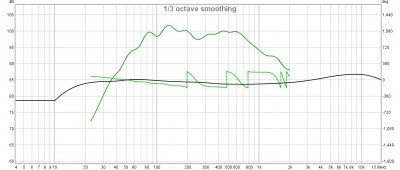

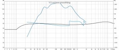

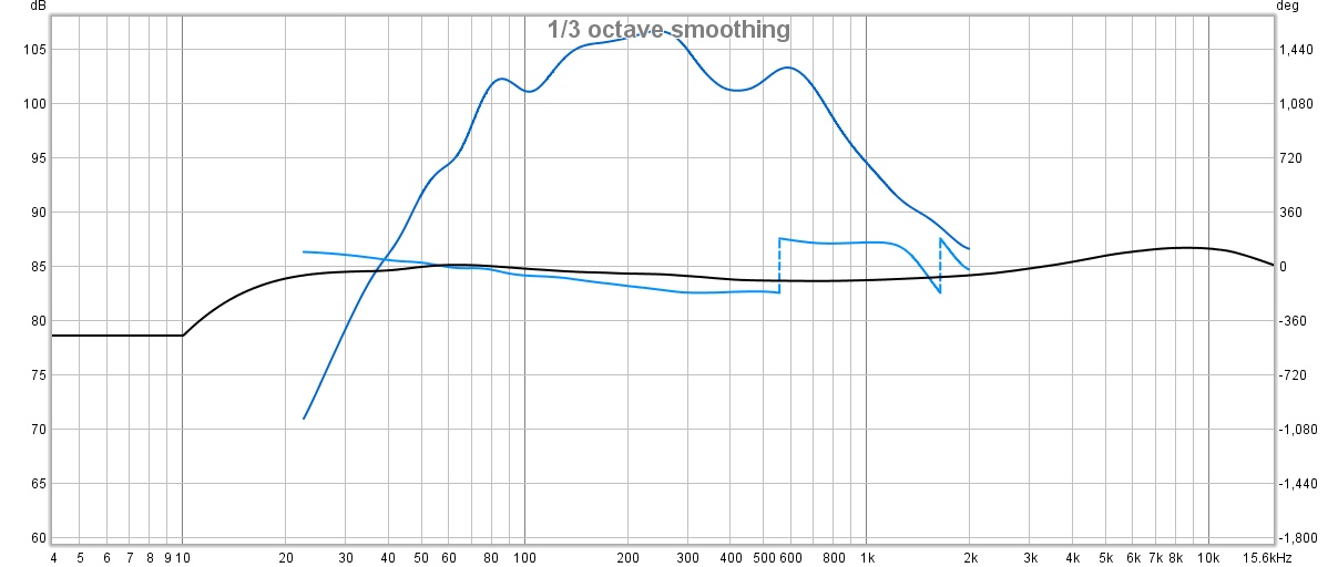

Re: Otop 8
Hi Guys,
Otops built and tested.
See attachments. I did mostly get my 6Db and as an added bonus, a flat phase response in the target frequency band. The Otop is a bit lumpier in the response, but nothing APO equalizer can't fix. Measurements are 1W/1Meter (2.0volt rms). Being winter here I had to do it indoors, so some of the lumps and bumps may be the room. But they are worth painting and keeping!

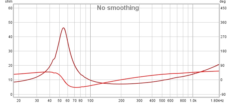

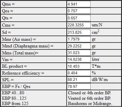

The acoustic box are Dayton Hifi woofers. The Otop are cheap Chinese speakers, 250W rms. The measured SPL of the speakers is the same. But the Dayton's would not be suitable for this enclosure. Even the cheap speakers are marginally suitable, but you can see the results. The Dayton Audio PA200-8 would be better, at least 3Db more and probably flatter response. Fairly cheap in the US. Measured properties of the Chinese speakers attached. Measured after a night on 50Hz and cooled down again.
