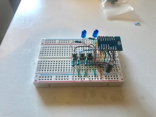

Got my amazon order a couple of days ago, esp8266, antennas, and arduino starter kit. Never realized how small this little guy is. Started piecing things together on the breadboard, using the node_dmx_and_pix_v2.png schematic and adding the optoisolators. Glad I got the starter kit as it comes with leds, buttons, and resisters. I used the leds and resisters from my arduino kit, the resisters were about 100 ohm lower than the schematic, but I assume that won't be a big deal?
Hopefully my mouser order will be there when I get home today, then I can get it finished up and start learning the programming side of things
Re: Wireless DMX :0
Posted: Fri Oct 19, 2018 9:58 pm
by J_Dunavin
Hey, looking really nice!
Seriously, keeping things nice and tidy will help.
The resistor thing... ah it depends, which resistors are we looking at? The hold up ones for the switches? Ya a few hundred off is ok.
The ones on the output of the max485, those need to be closer.

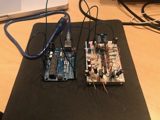

got everything assembled on the breadboard except for the optoisolators, I ran out of room on the breadboard. So its exactly like the node_dmx_and_pix_v2.png schematic. I powered it up, and no magic smoke :) also got a little red light on the esp. So I think I'm ready to try to flash the code. Ive got the tx and rx connected to the arduino. Ive got the reset on the arduino shorted to ground so the program will be sent to the esp and not the arduino. I'm powering the breadboard with a 12v power supply and the arduino with usb, should I connect the grounds of the arduino and the breadboard?
I found this online:
Manual reset and manual program
This only applies to boards without an on-board USB-to-Serial converter.
If you don't have a USB-to-Serial converter with DTR and RTS lines, you could also just use the reset and program buttons we added in the hardware chapter. To get the ESP in program mode, GPIO0 must be low while booting:
press and hold the reset button
press and hold the program button
release the reset button, the ESP will boot in program mode
release the program button
upload the sketch
If you want to get out of program mode without uploading, just press reset (without pressing the program button).
Does this sound like the right button procedure? what is the button labeled button one on the schematic?

Disregard button one.
Yes you can do this while powerful as well.
Press and hold program, press reset once and release, then you can either release program or leave grounded.
That’s so awesome you got a light!
It feels so good when things don’t go poof 😀
Now you’ll have to read up a little on the Arduino IDE program settings. Since I use an adapter I set my board to generic esp8266, but it may be different for you I’m not sure on that.
