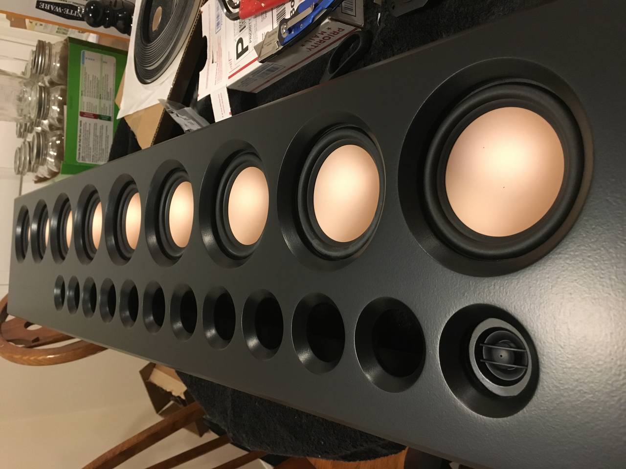

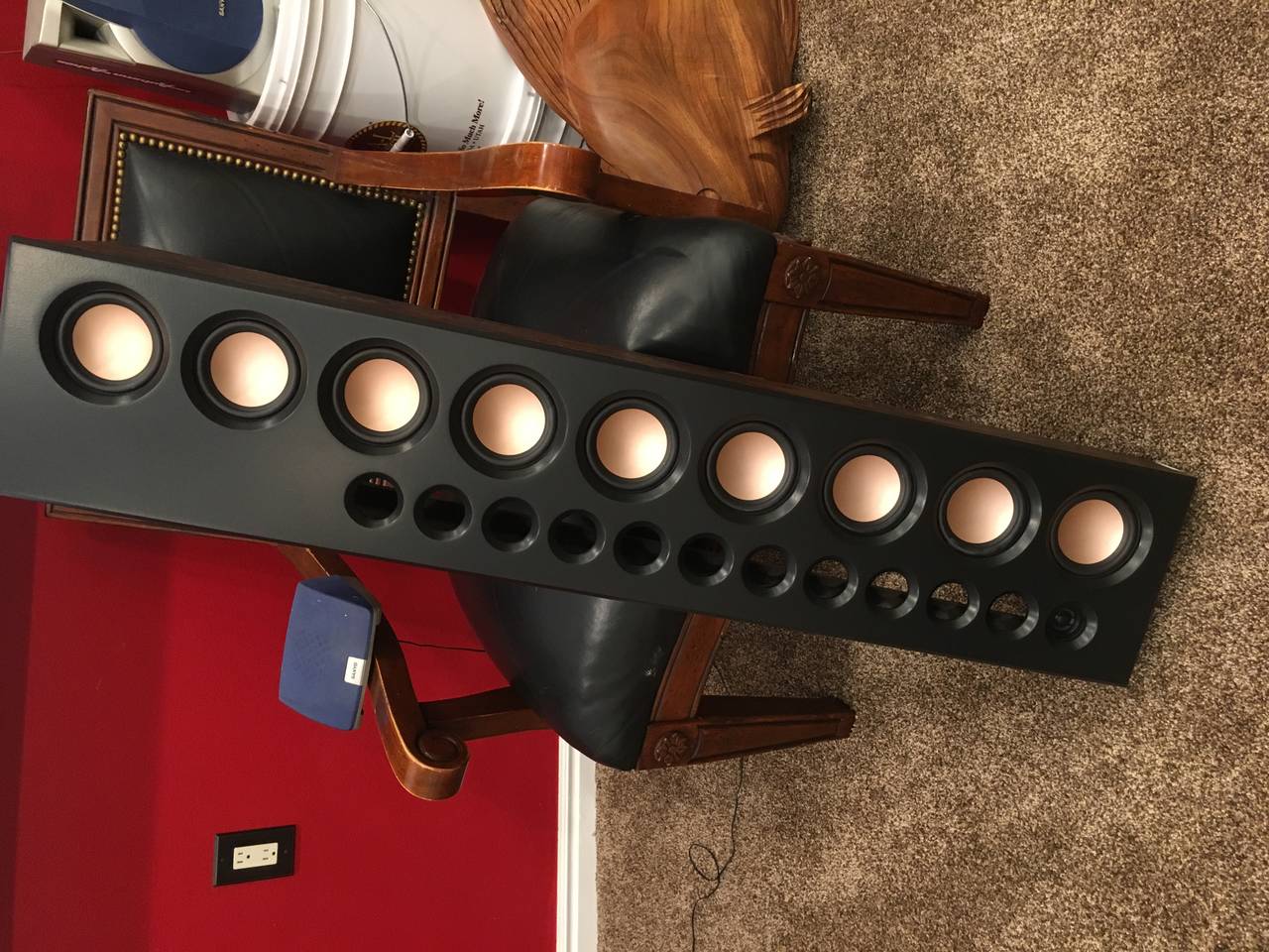

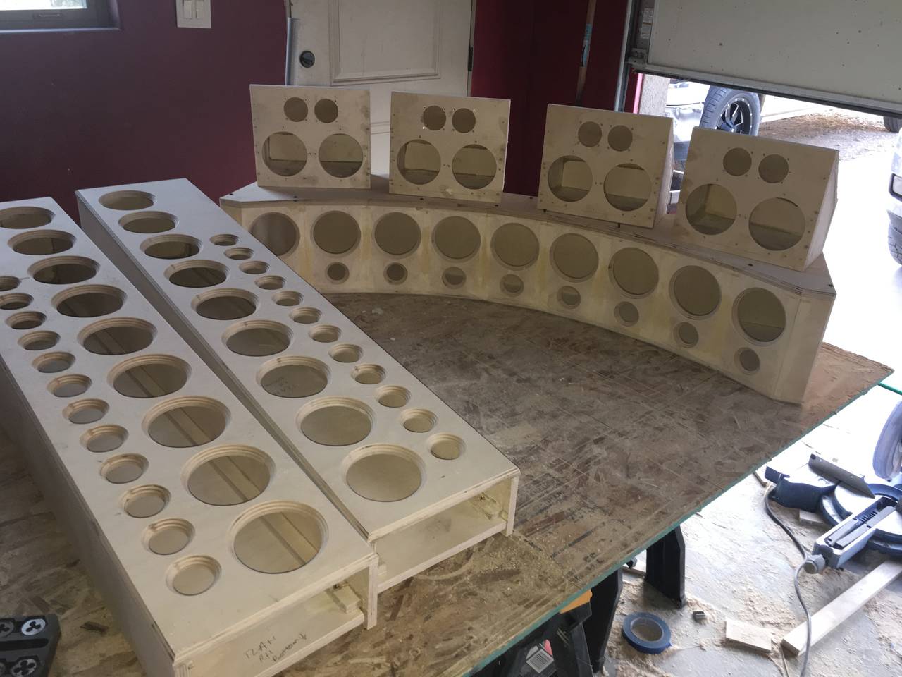

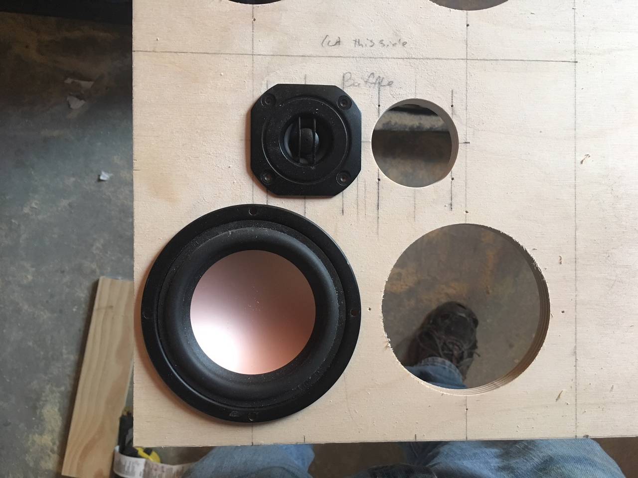

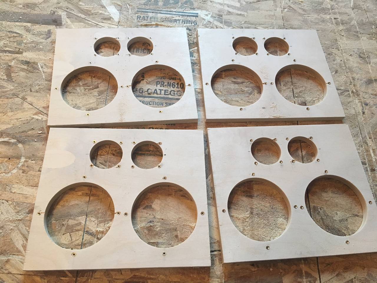

Started on the surround sound units. Going for a 7.1 system so there will be 4 surrounds. I based them on the units in Bill's plans but took some of my own design liberties. They will be similar size and shape to the original design but I've added a couple tweeters.

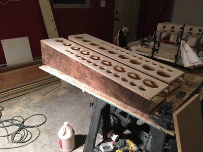

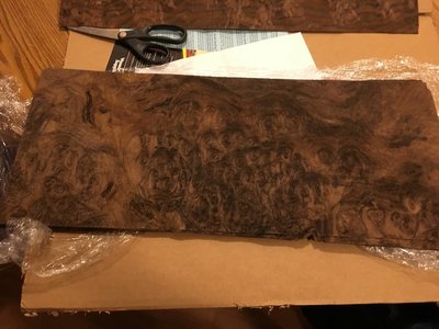

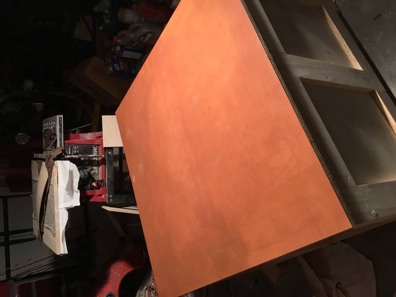

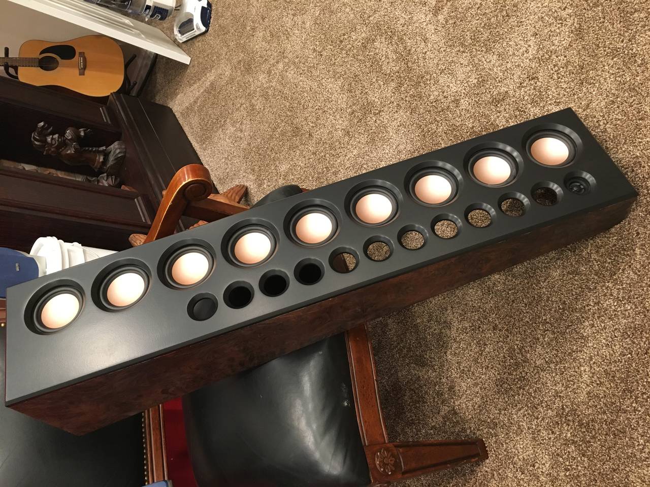

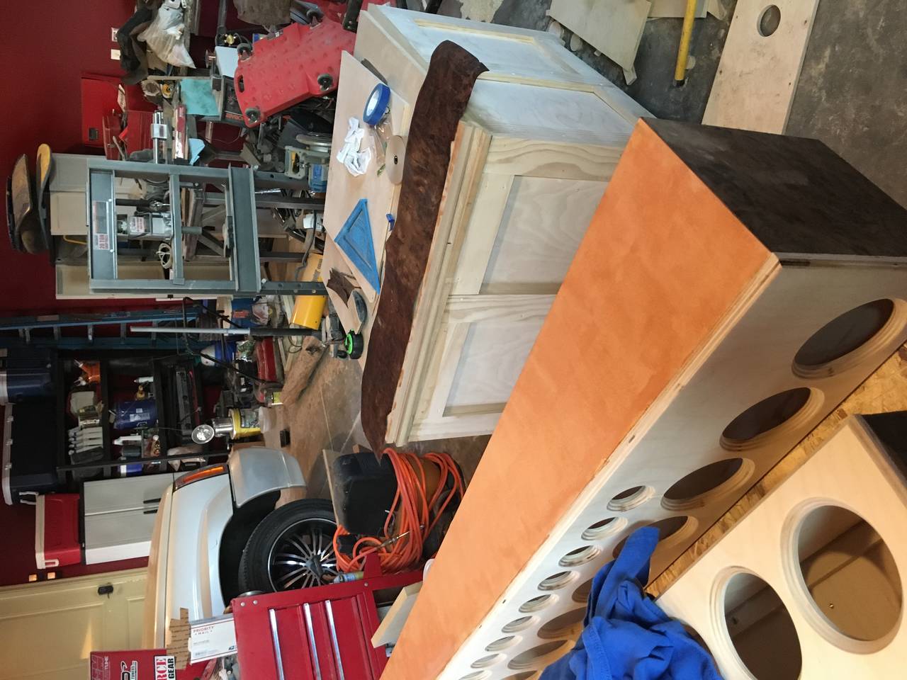

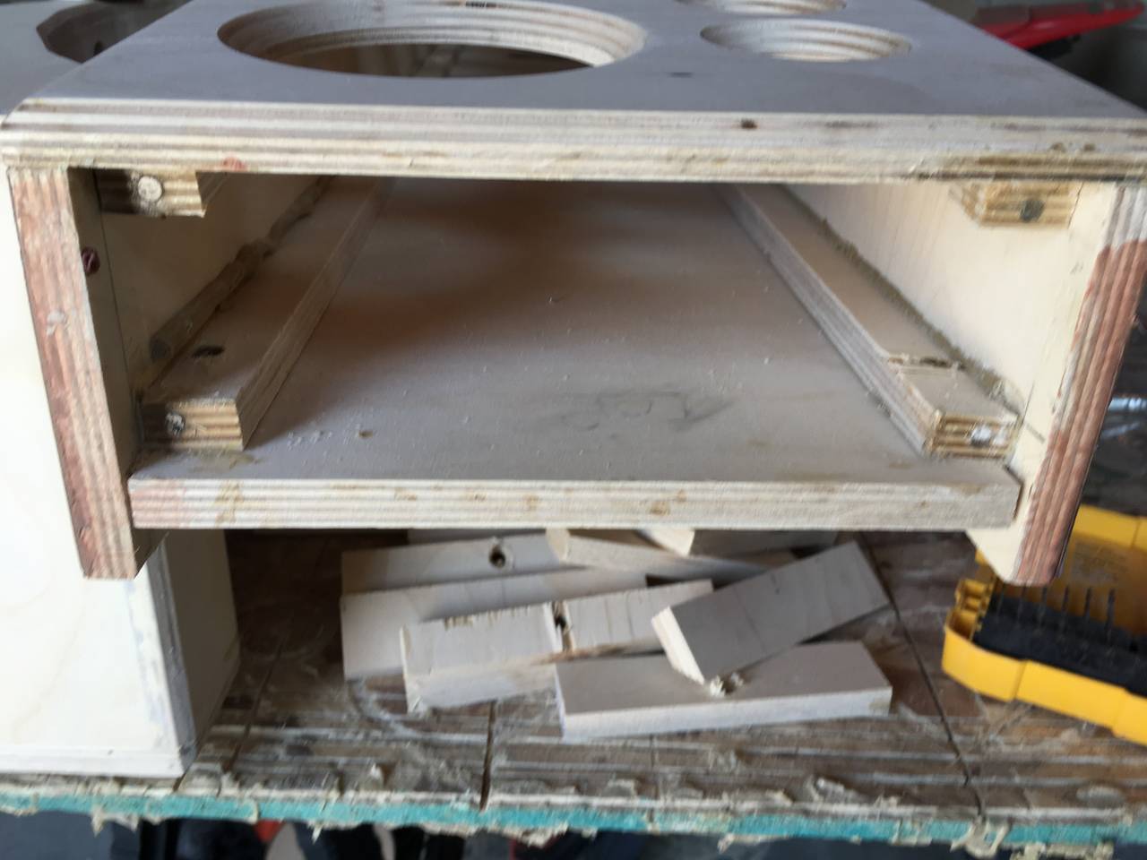

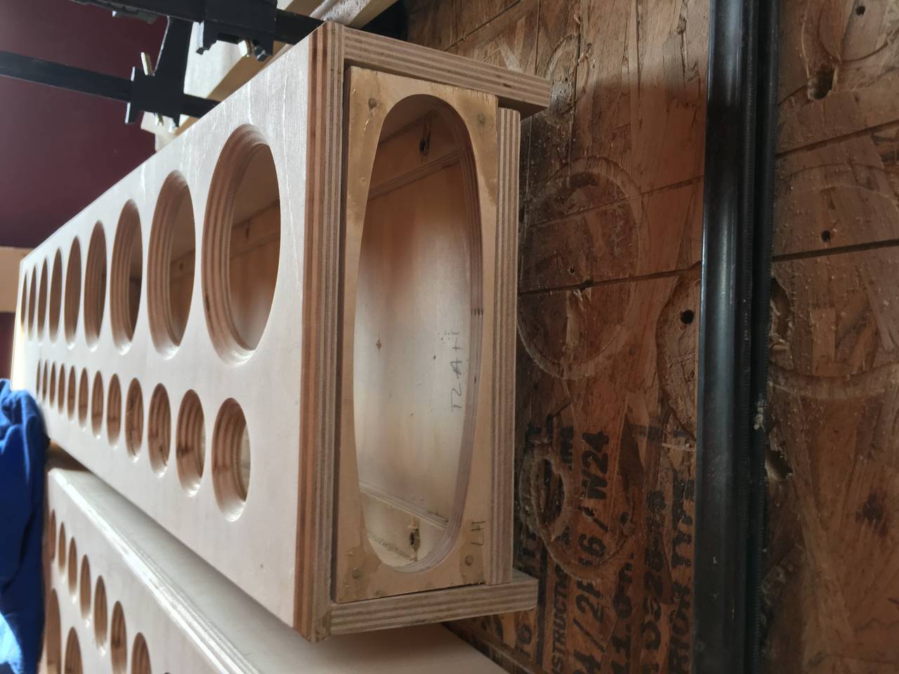

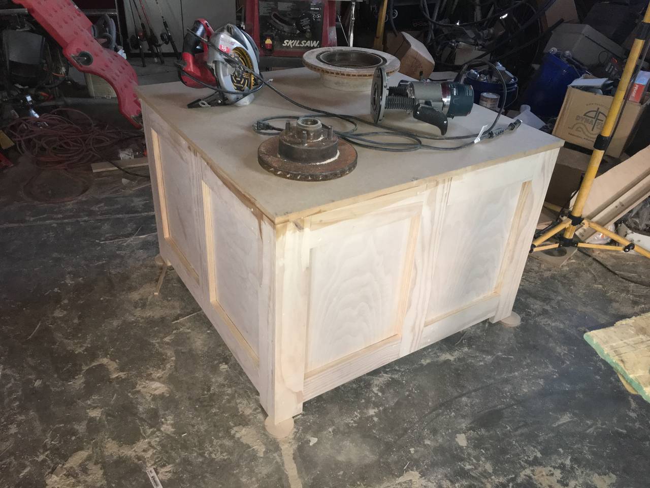

Still been working away. All major construction is done. The surrounds and center have been completely sanded and are ready for paint. The sub has been sanded and the top applied. It is ready for veneer and final glue up.

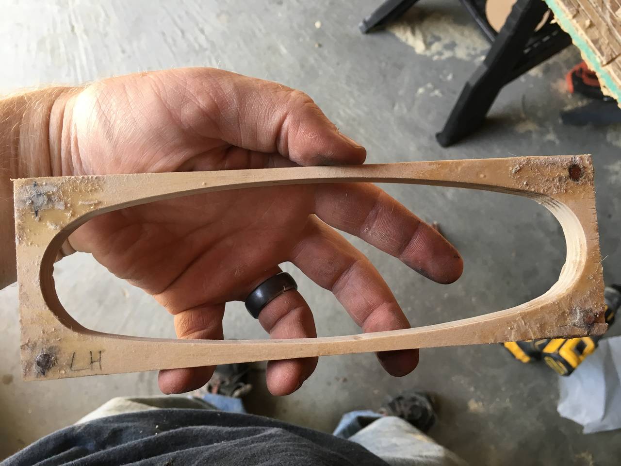

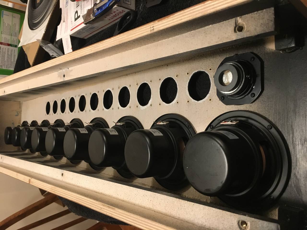

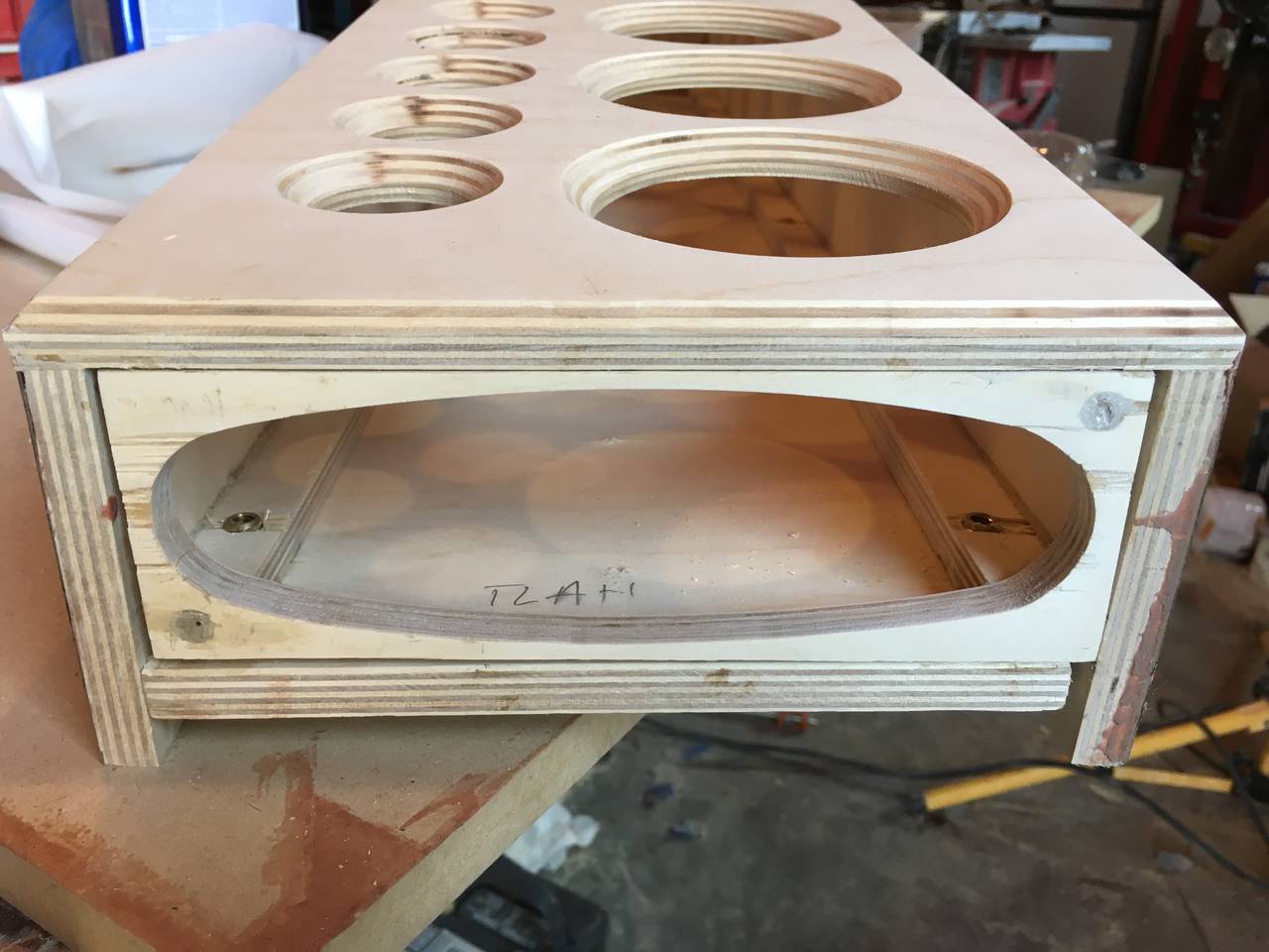

The TLAHs are getting close. I made a grill for the horn mouth that will hopefully keep the batting in and cover the color of it. It will be covered in black grill cloth. I started the veering process yesterday. These things are going to look killer! I’m getting super excited. I still haven’t decided on a finish yet. I bought some danish oil and some aniline dyes to experiment with.
A nice little happy family
Glueing the table top surface on. Unfortunately the sub didn’t come out perfectly square but I think I hid all of it at the back where it won’t be seen too much

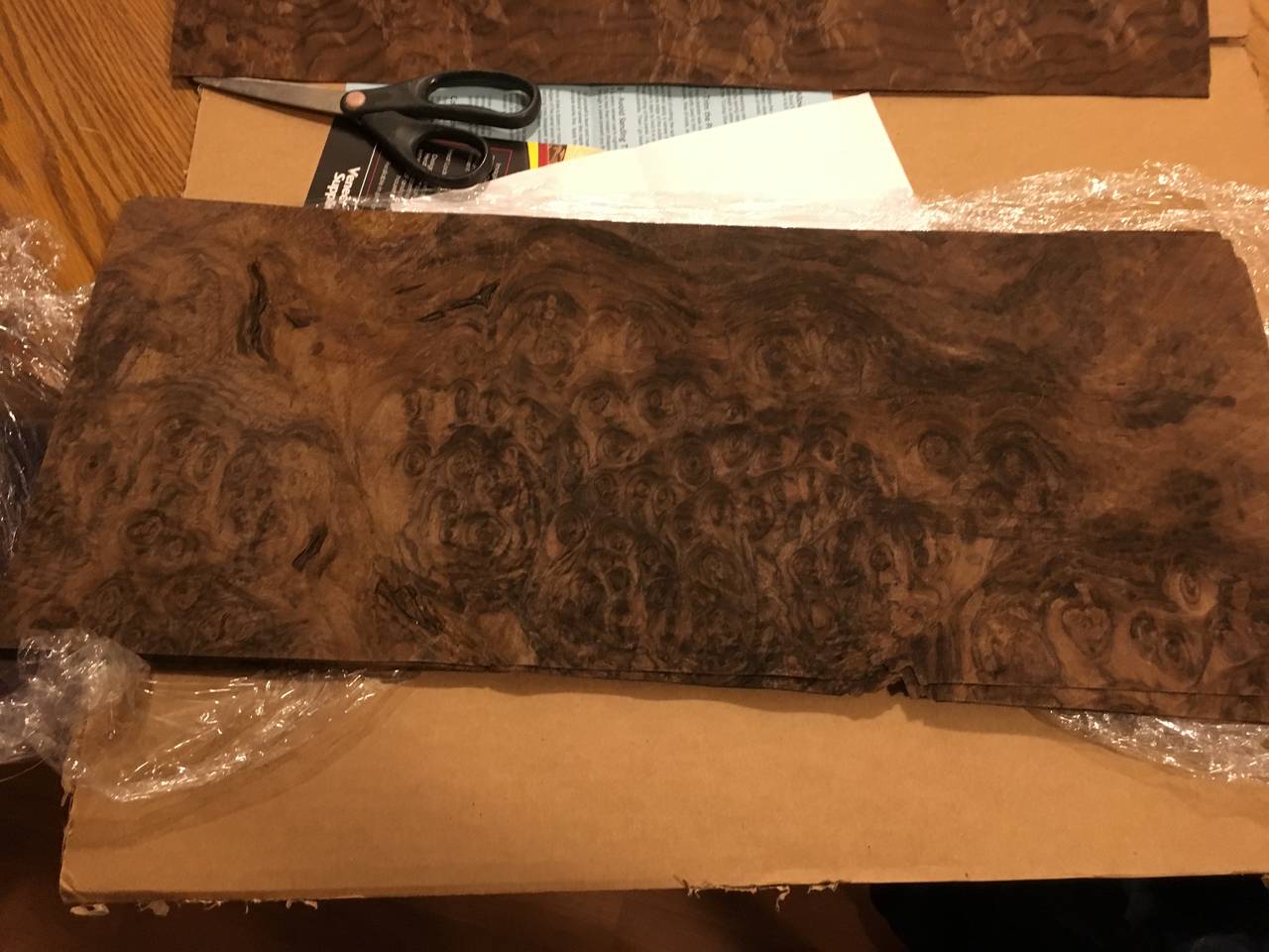

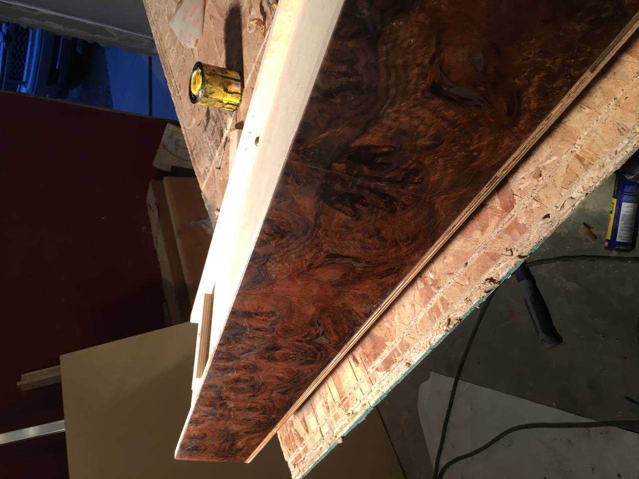

Veneer for TLAHs
Flattening the veneer
TLAH grill. Hoping it doesn’t effect sound production too much as it does cover quite a bit of the Mouth. My gut says it won’t but I have no science to back that up

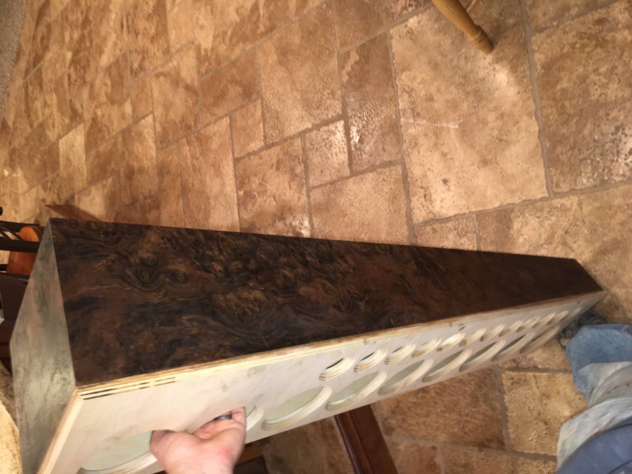

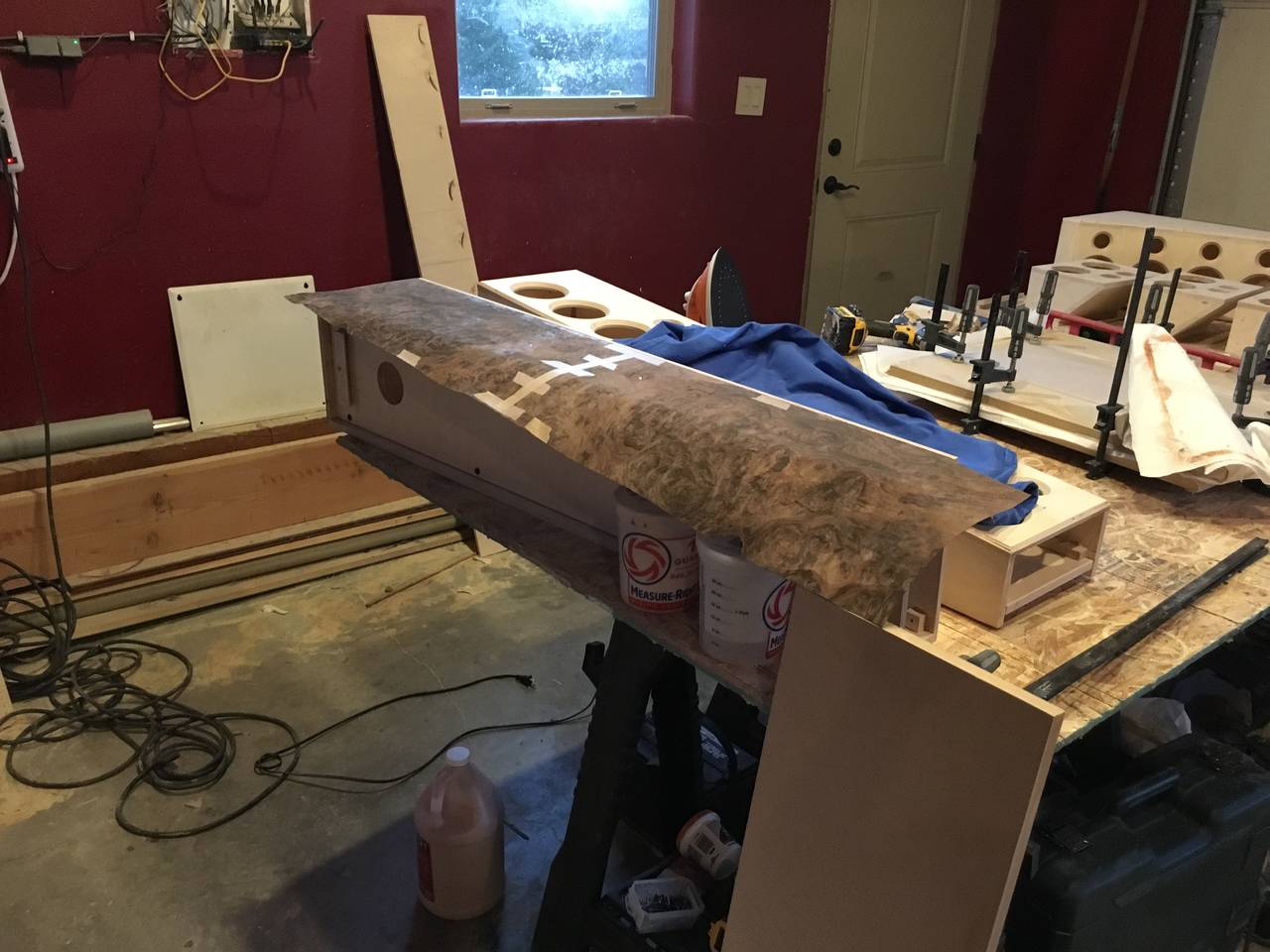

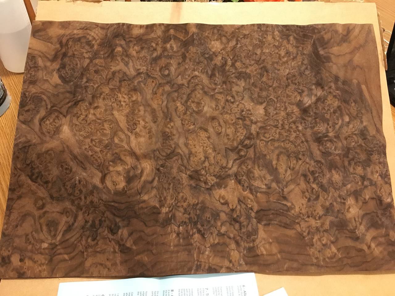

Glue applied to veneer and substrate
Veneer gets applied by ironing on

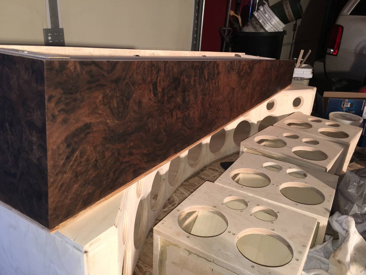

Final product. Everything else exposed will get an automotive finish in black with a satin clear coat

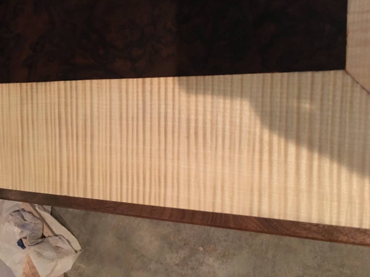

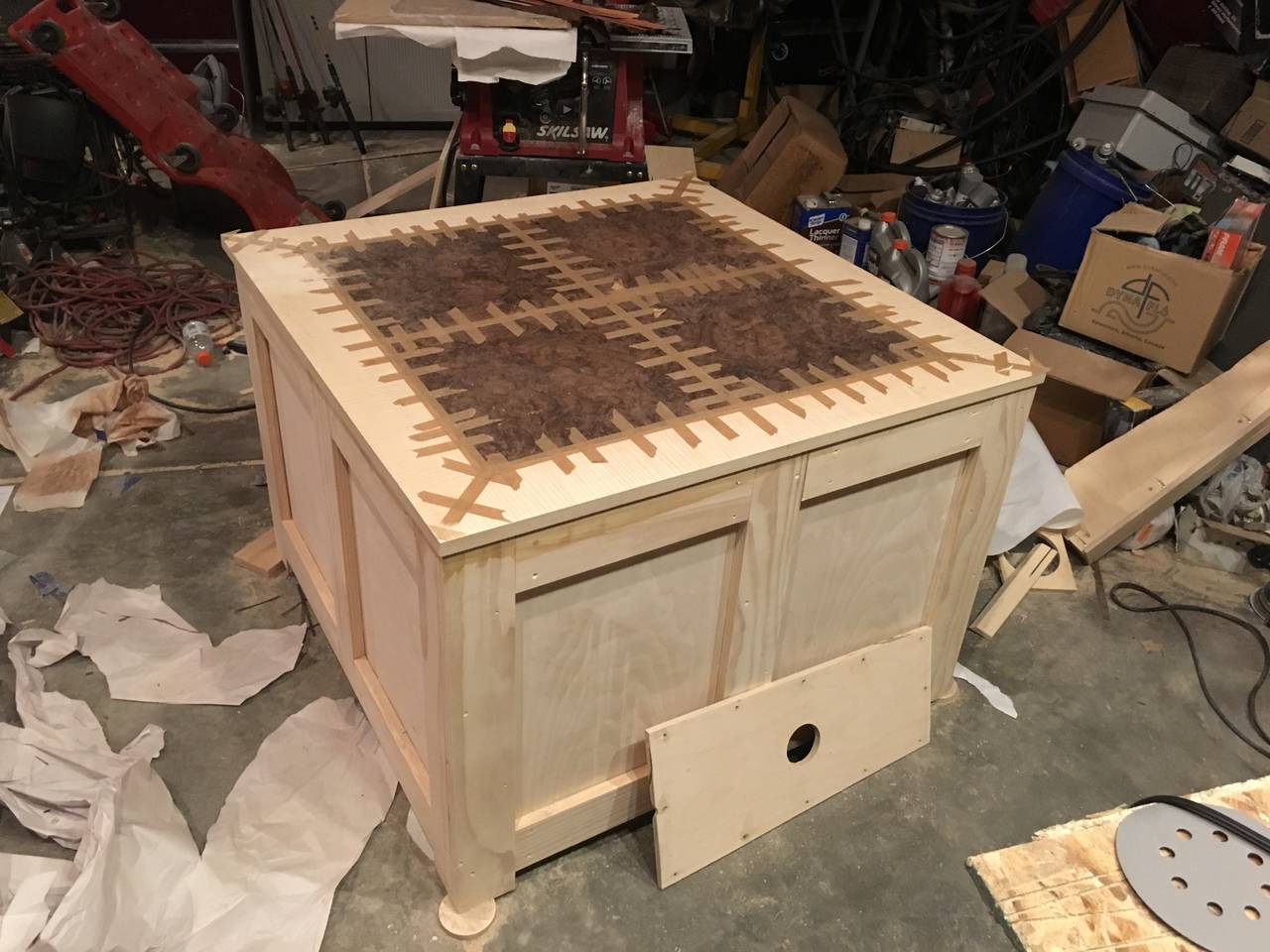

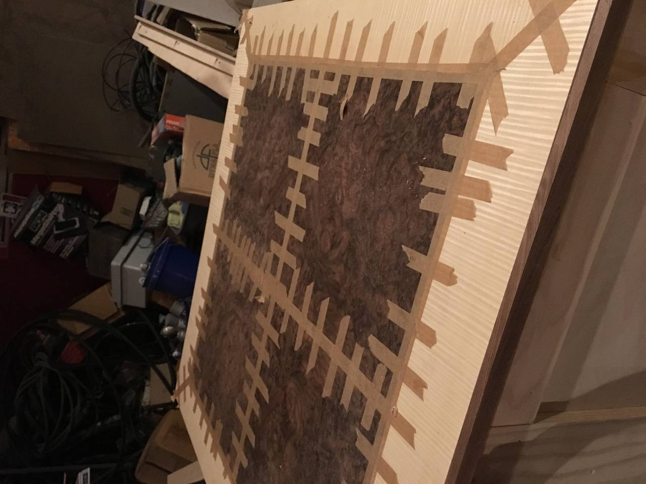

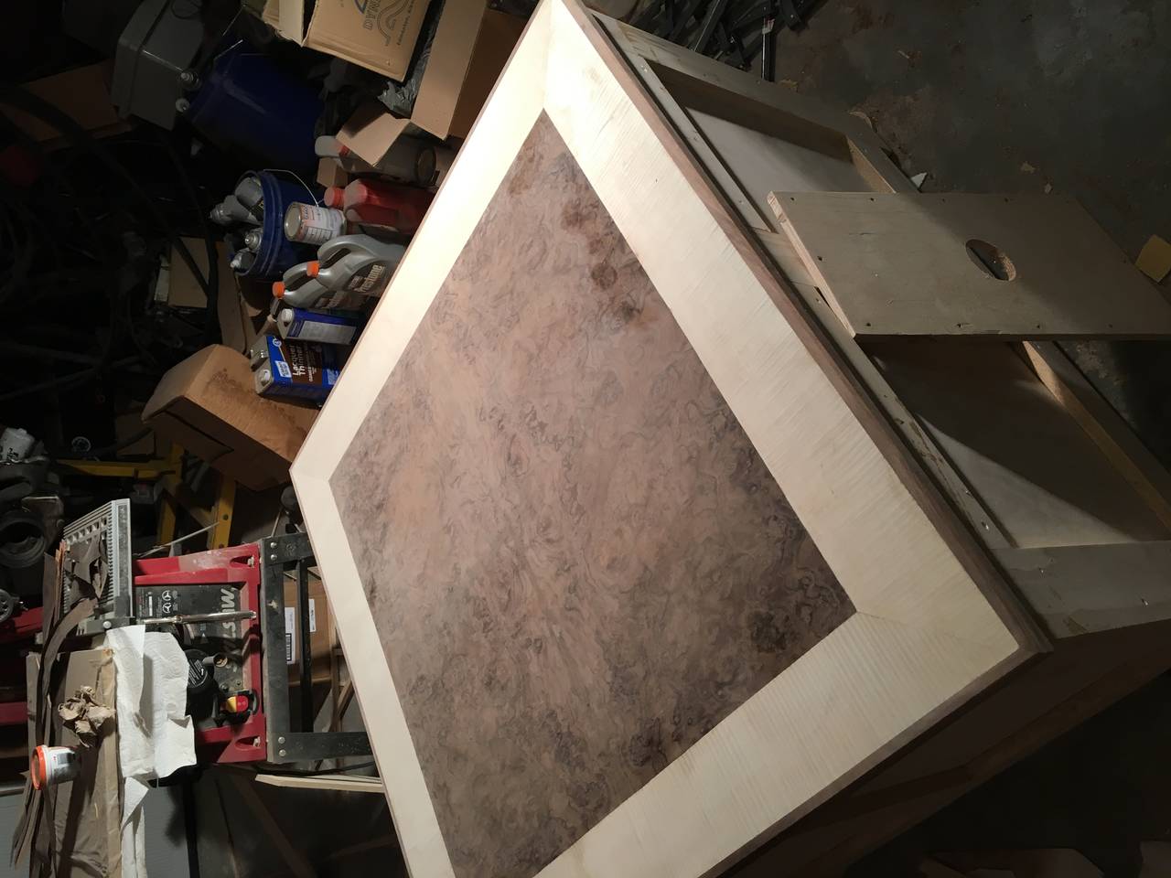

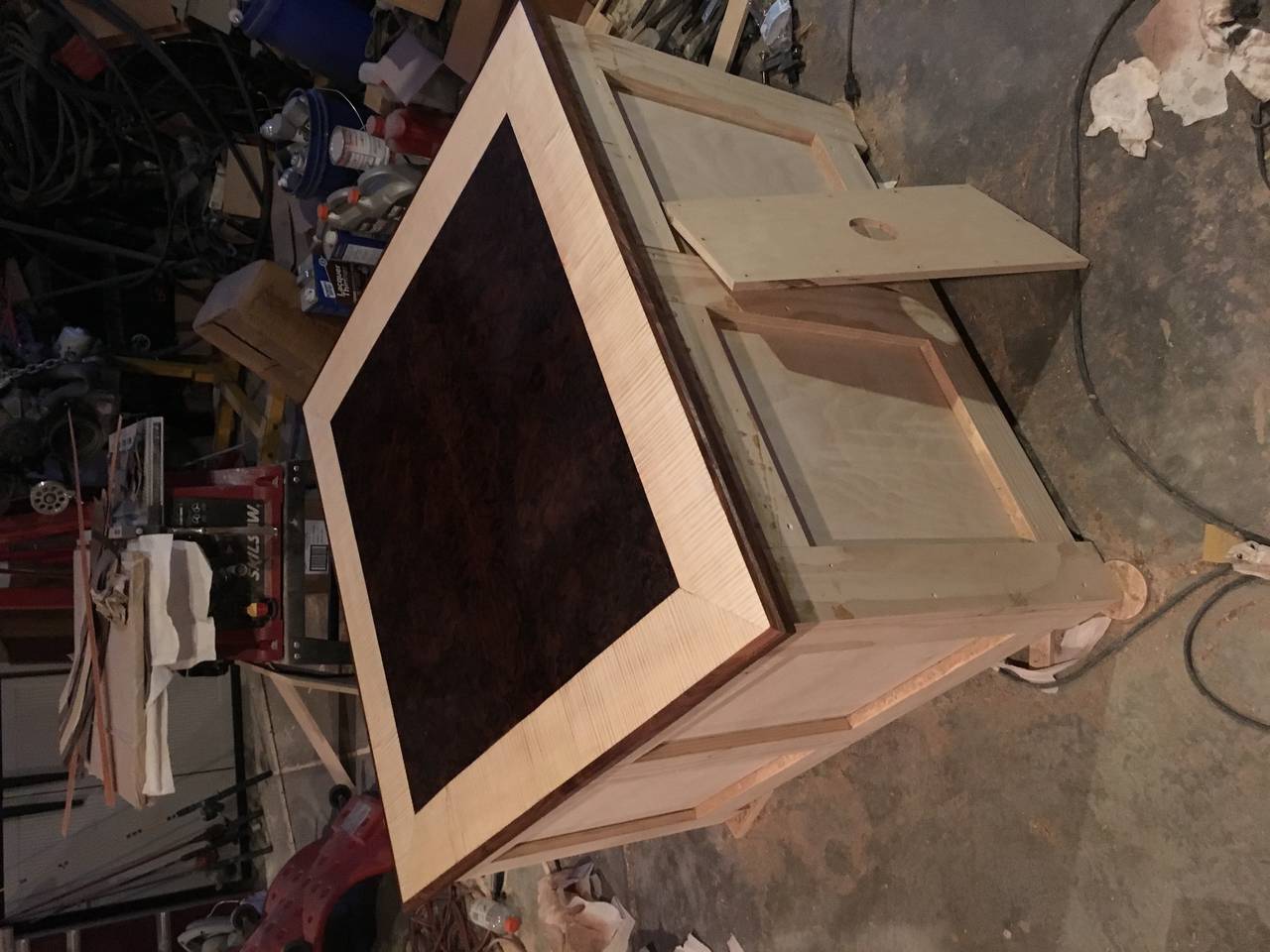

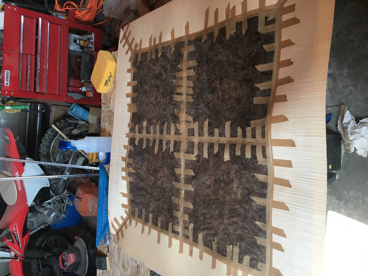

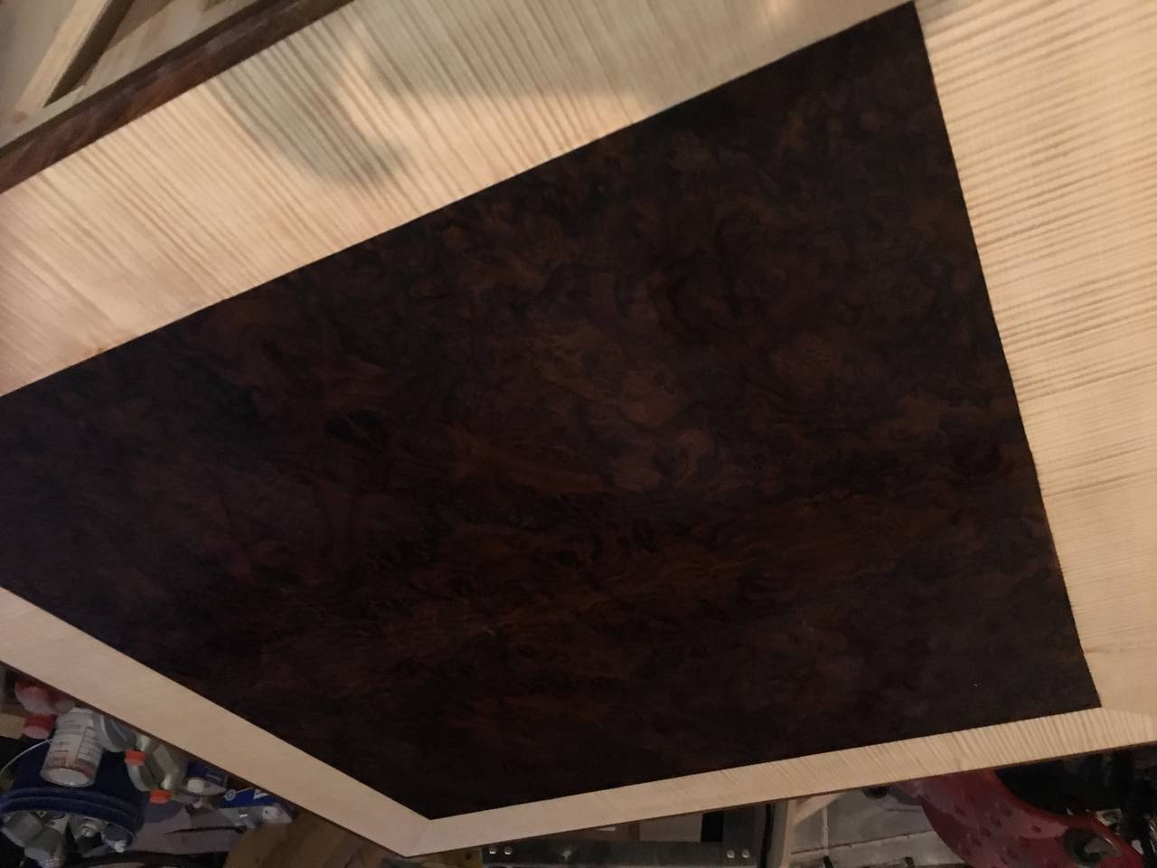

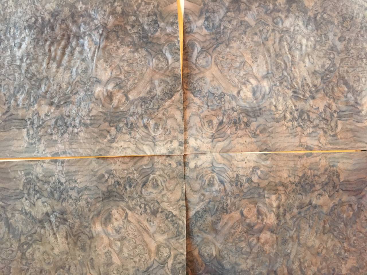

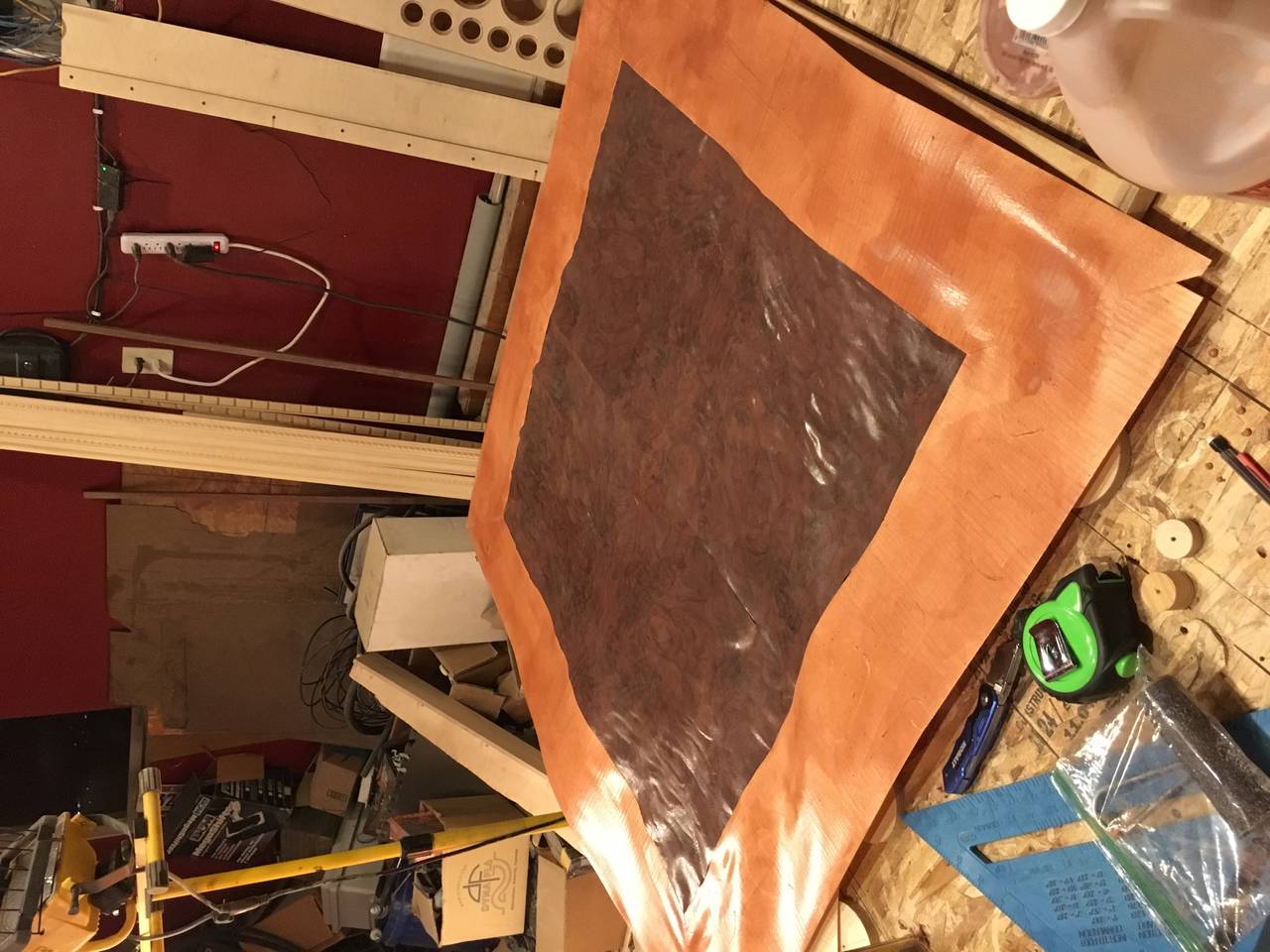

I’ve got to finish 3 more sides of the TLAHs with veneer and then I’ll do the THT table top. The next time I post it will be to show the table top. Picture of things to come:
Veneer for center of THT top. This will get book matched in left to right and then top to bottom so there will be 4 pieces joined together. Around it will be curly maple with a solid walnut edge.

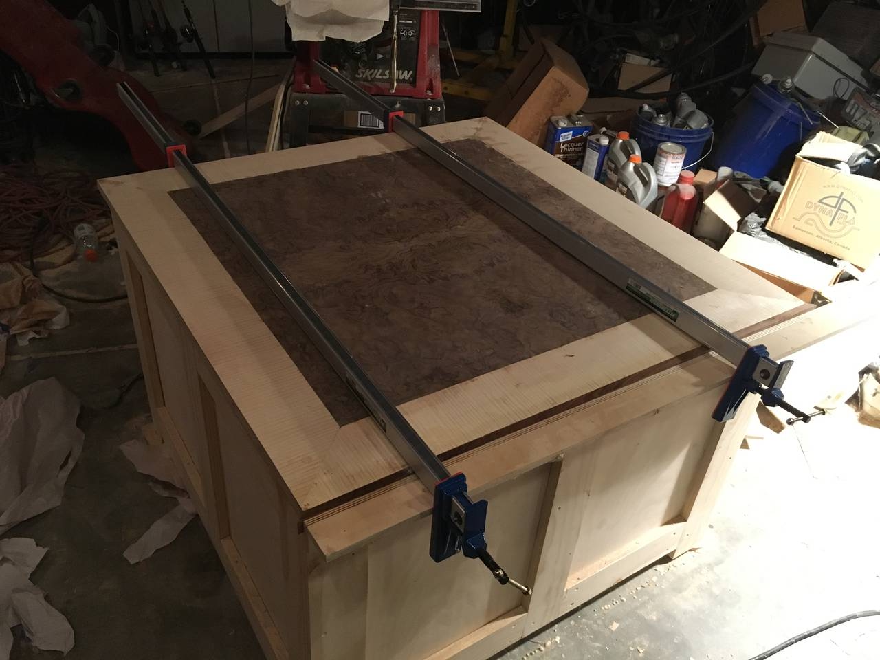

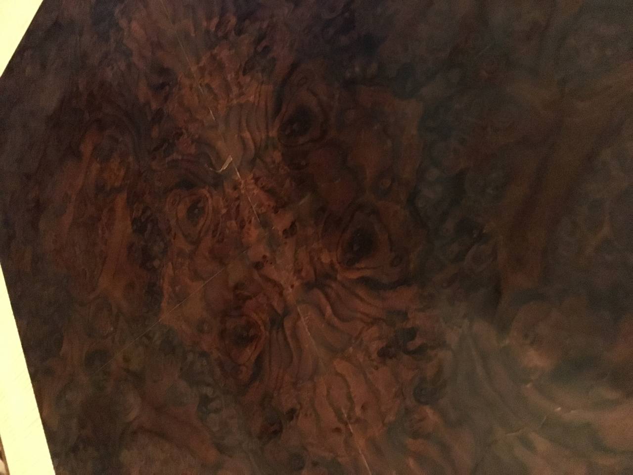

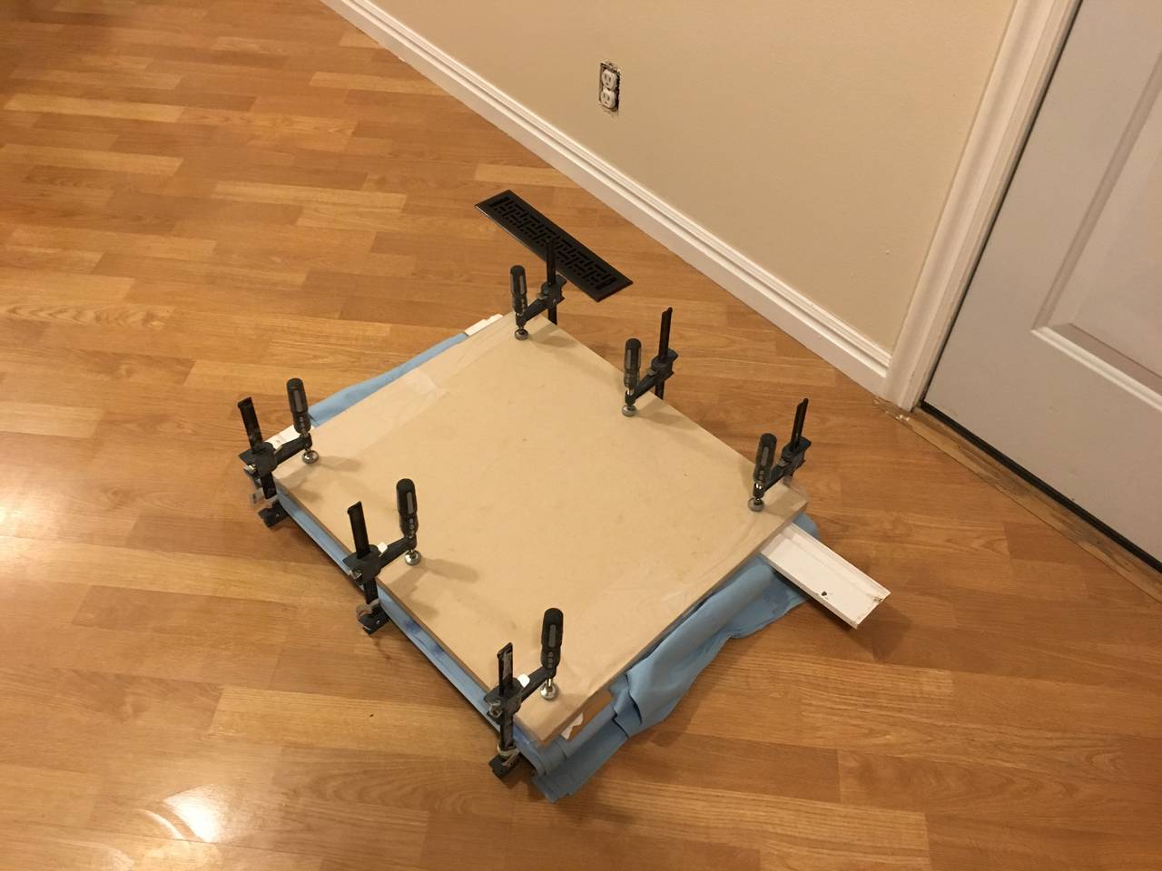

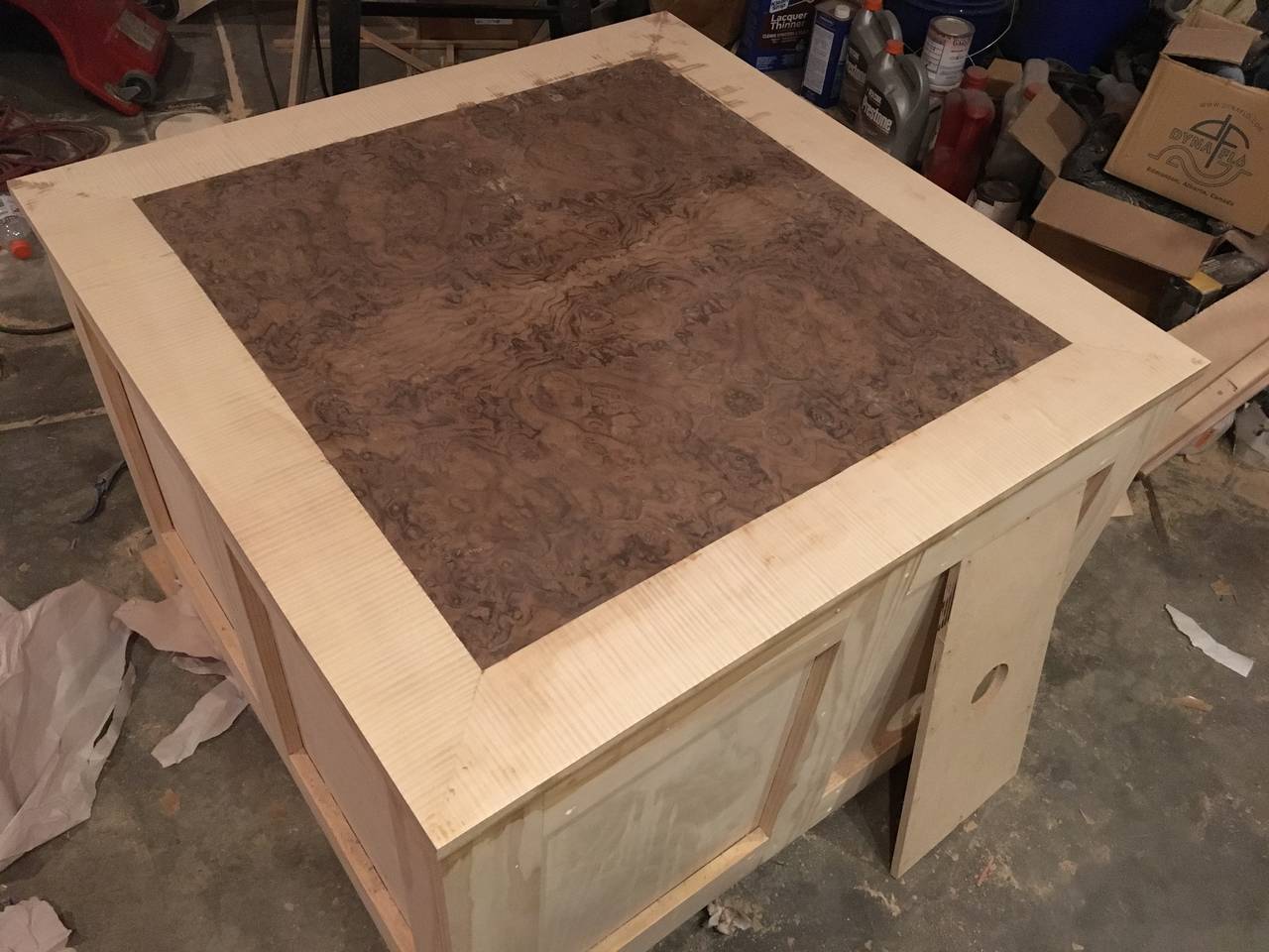

Made a few mistakes during the veneering process but overall it turned out nice. Nothing that is too noticeable. I’m just starting to glue solid walnut around the edges .
