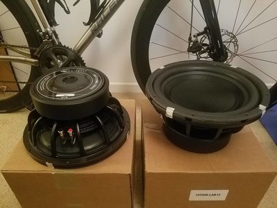

In the mean time here's some Driver/Bike porn..
Alex
