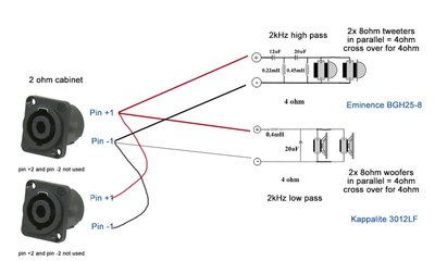

That crown amp will run just fine at 2 ohm like that with 1 x 2ohm cab on each side of that amp, if it's not over heated because of an obstructed fan or something, they will handle a couple hours just fine ?
At 2 ohm each side it will be just perfect with 2 x 212 like this

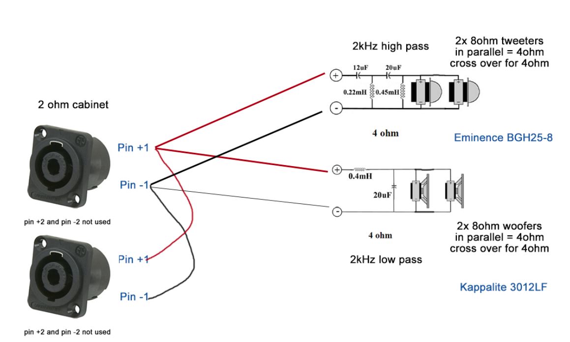

#21 Post by Electric Wisdom »
So, i guess this is good now:
Edit: besides the second speakon connector, it's useless since it's already at 2 ohm but maybe if i wire it at 8ohm later...

Electric Wisdom wrote: Fri Mar 02, 2018 11:55 pm That crown amp will run just fine at 2 ohm like that with 1 x 2ohm cab on each side of that amp, if it's not over heated because of an obstructed fan or something, they will handle a couple hours just fine ?
Ok, I see where you are confused now.
2 x 8 ohm drivers in parallel is a 4 ohm load. 2 x 8 ohm tweeters are a 4 ohm load. But, those two paired together in a cab with a crossover does NOT make a 2 ohm load. Because the drivers and the tweeters do not operate in the same frequency range (due to the crossover), you don't calculate the total load by considering both. Only the low frequency drivers.
The setup you are describing is a 4 ohm cab, not 2 ohm.
So, with a 2 cab setup running one per side on the amp - the load will be 4 ohms per side.

Electric Wisdom wrote: Fri Mar 02, 2018 11:58 pm So, i guess this is good now:
The amp sees a 4 ohm load below the cross over frequency, for the woofers. And again, the amp sees a 4 ohm load above the crossover frequency. That makes it a 4 ohm cab even though there are 8 drivers in it.
The picture looks fine, and the parts selection is correct.

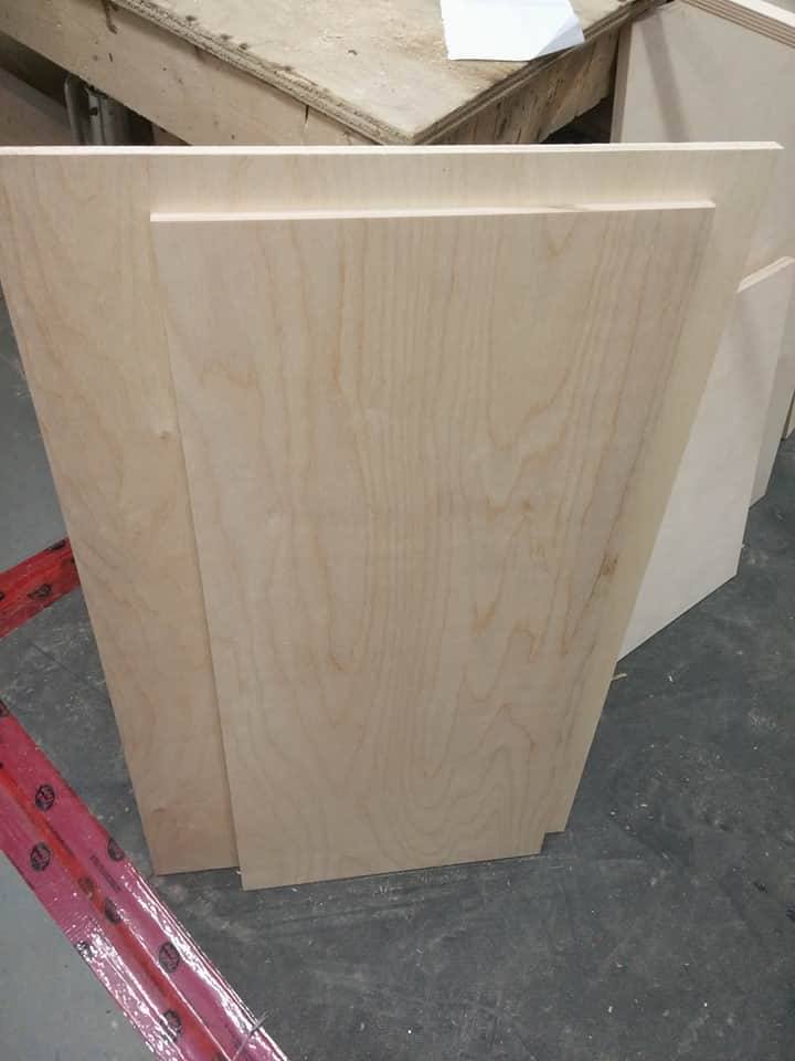

#27 Post by Electric Wisdom »
Super exciting first picture lol :lol:
Top, bottom and sides panels.
I'm ordering stuff this weekend, don't want to cut wrong sizes holes for the handles etc hehehe
