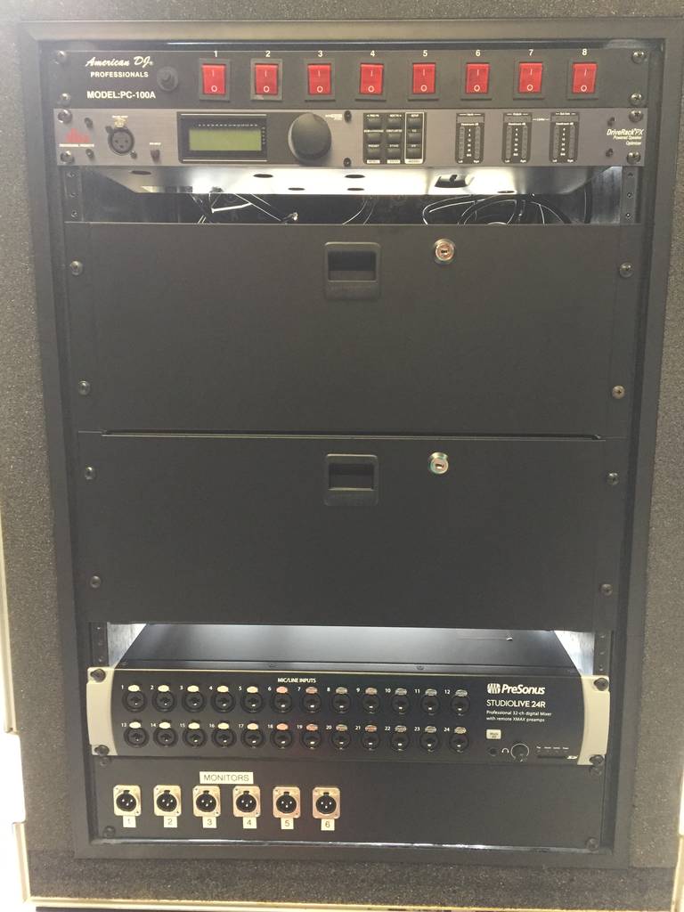

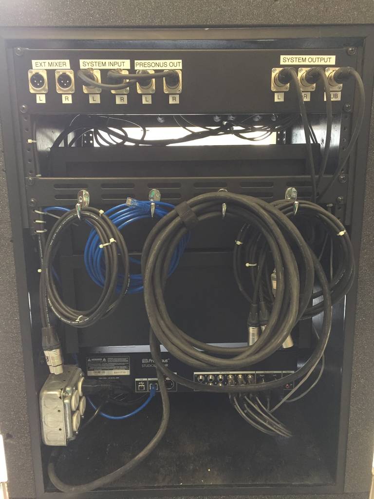

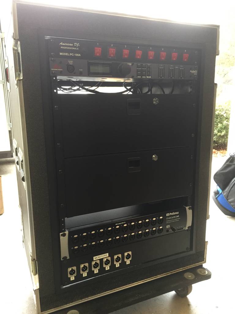

Well, it's buttoned up and ready to go to the venue. Router came in and it's all tested and ready to go.
I tried to make this idiot-proof. I used an old slotted rack panel and added hooks to it for cable storage. I zip-tied the iPad cable, router cable, and external mixer cables in place for strain relief. I'm hoping that it will take at least several days to a week before it gets torn up. (hmmmmm .... not much positive thinking here is there?)
One thing I ran into was a problem with the rack drawers. They are good, Penn Elcom locking drawers - 4U and heavy duty. After they were installed, one was hard to open and the one on top was damned near impossible. I actually tore a fingernail when my fingers slipped off the latch while trying to open it. After careful examination, I found that even though everything was lined up correctly in the rack, the top drawer was hitting the case of the bottom drawer. I pried up on the top drawer and as much as the rack holes would let me and locked it back in. That helped a lot, but there is still a little drag. So, the tolerances are off on that drawer. Anyway, if you get a sticking rack drawer - try to give it as much space as possible, that might fix it.

Just a note on the sticking rack drawers... it’s a good idea to leave a rack space between. You can leave it open for loose storage or put a panel there... but the problem comes from the weight of the drawers. If your drawers have rear supports, sometimes fastening those a little higher, or just shimming them in the back, is enough to overcome the sticky drawers.
- Posts: 8719
Re: How to build Rack Panels and put together a rack
No question a little space would help. One of these was sticking before anything was even in it.....it just hung a little low. I swapped the drawers, putting the hanging one on the bottom and that helped.BrentEvans wrote: ↑Sun Apr 15, 2018 10:34 am Just a note on the sticking rack drawers... it’s a good idea to leave a rack space between. You can leave it open for loose storage or put a panel there... but the problem comes from the weight of the drawers. If your drawers have rear supports, sometimes fastening those a little higher, or just shimming them in the back, is enough to overcome the sticky drawers.
