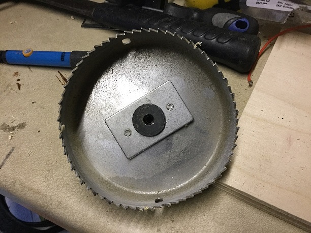

Another bit of advice - I ran into a problem with my hole saw, it got too hot and warped (see pic). Any ideas on how I can correct this?

Burg wrote: Another bit of advice - I ran into a problem with my hole saw, it got too hot and warped (see pic). Any ideas on how I can correct this?
There's nothing you can do with it. Throw it away and buy another. Those saws need to be used gently. After a little cutting, pull it out and clean away the dust, then do some more.

Burg wrote: my hole saw, it got too hot and warped
Reduce the speed and pressure, let the saw do a leisurely cut. My shop is in my backyard, with a large double door to the lawn. When I'm cutting I have a high velocity blower aimed across the work surface, blowing the sawdust into the yard, away from my lungs, and in the case of a hole saw out of the kerf.
