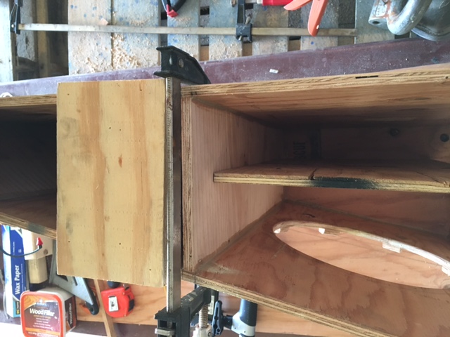

i read the entire thread, i came into the shop this morning and inspected my work piece, the PL is setting a bit slow but it gets around 50degrees at night and not over 80degrees in the day. I dont think its a bad batch either, i think it is just setting a little slower than my patiences. After inspecting the glue joints of my work piece i am pretty happy with the hardness of the PL at this point, each day it continues to set better i just need to not disturb the joints any until i get a full cure. I admit I like the instructions that come as part of the plans for the build, clearly someone has done a lot of homework and it shows in the build plans!!!!!

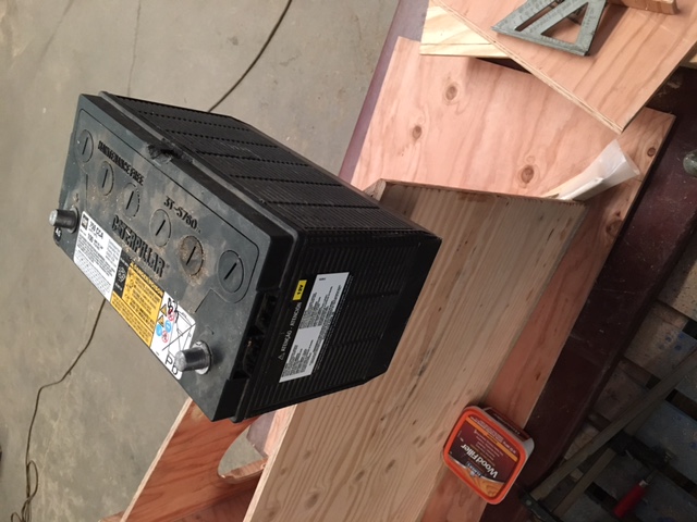

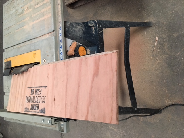

set up saw to cut over 45degree by nailing some strips to the work piece, used some ballast to help hold the piece in place, got some PL on my hands, but it fits nice, this is one of the funnest builds i have ever done, sorry it is taking so long i only get an hour or so a day but it is nice cause i can let the adhesion compound set up some before i touch it too much...

ACUA wrote:set up saw to cut over 45degree by nailing some strips to the work piece, used some ballast to help hold the piece in place, got some PL on my hands, but it fits nice, this is one of the funnest builds i have ever done, sorry it is taking so long i only get an hour or so a day but it is nice cause i can let the adhesion compound set up some before i touch it too much...
You really should have the fence on the other side of the blade when doing a bevel cut like that. What you are doing there is very dangerous and is way more prone to kickback. Too easy for the blade to pinch the board.
Always have the fence away from the tilt of the blade.

+1,000,000Bruce Weldy wrote:ACUA wrote:set up saw to cut over 45degree by nailing some strips to the work piece, used some ballast to help hold the piece in place, got some PL on my hands, but it fits nice, this is one of the funnest builds i have ever done, sorry it is taking so long i only get an hour or so a day but it is nice cause i can let the adhesion compound set up some before i touch it too much...![]()
You'll learn that one eventually from experience. Broken ribs or a bruised stomach WILL happen eventually. Once the cutoff piece reaches past the saw and bends down a bit, then in a split second the piece will fly back at you around 200 mph. Not fun at all. I've had a piece of ply fly back 25 feet into the wall behind me and shatter into splitters. Never stand behind the line of fire on a bevel cut either.

I have never had any problems running my little table saw so I'm either over do, or lucky, or somewhat safe. I simply stood beside the saw where the rail was mounted so that if I got any kick back I would not be the target. I am using brad nails to help hold the work pieces and jigs together. For some reason my PL is not setting up very fast so leaving the parts clamped longer helps my situation

Do the current plans or PL Premium instructions suggest wetting the work pieces, to provide the moisture needed to cure it? Not so much a soaking as a dampening
Re: New member/first BFhorn/Tuba45
A wipe with a damp rag or a mist from a spray bottle helps it cure more quickly. Depending on the temp, it can be 3 or 4 hrs even with that before a joint is solid enough to handle without fear.
