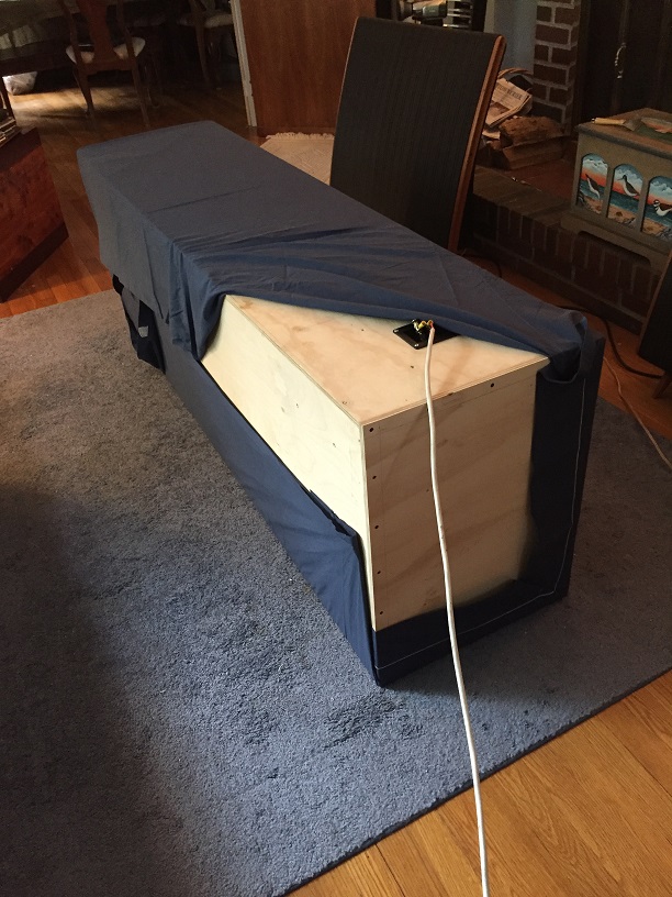

Re: 24" THTLP from flat pack
Posted: Sat Aug 20, 2016 10:41 am
by MA043HA
As the plans say: "An easy finish is a sheet or other piece of cloth draped over the box..."
