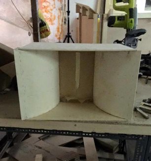

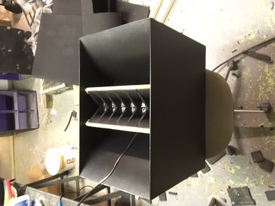

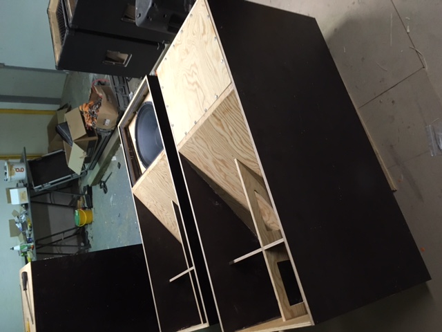

Here are pictures of one cab with sheaths. I have installed sheaths on all 8 already, but no pictures yet.
And for the jig in the center to hold the plywood while bending, I made a double jig. Basically, it is a piece of wood that is exactly wide enough to push in both sheaths at the same time, allowing me to omit the trillion clamps or ugly holes in the wood.

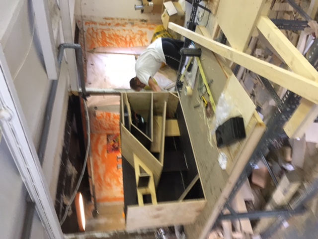

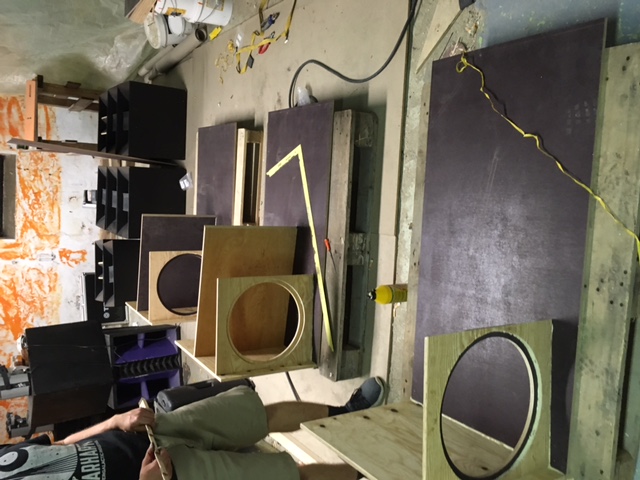

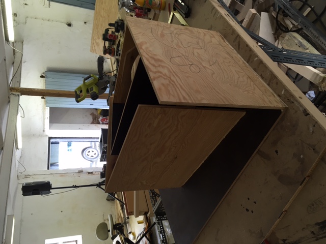

I apologize for not being able to update this build thread! I suddenly felt the pressure of the build, and had no time to spare in front of the computer. All the speakers have been completed now, and I must say I am pretty proud of the results. The 4 titan48 speakers were done from start to finish in 21 hours in one go. Here are pictures from the build sessions!

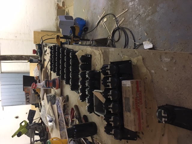

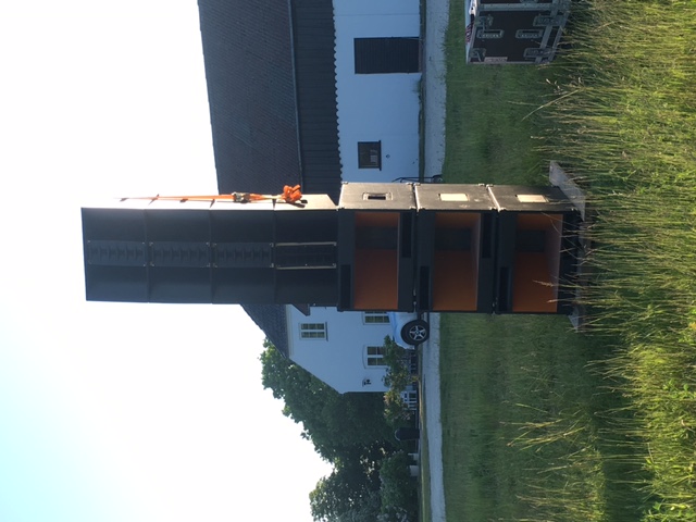

More pictures.

Is the reason you have the T48's setup like they are simply so you can stack the J arrays on top?
If so, perhaps it would be great to build some platforms to put the J arrays on, so you can cluster the T48's.
Sorry, can't help but looking at the setup pic in the middle of the buildings, and thinking you're cruelling your LF output though.
That (inadequate) amount of separation probably means you're causing frequency cancellations in sub output up to about 45Hz.
I figure you went for T48's to get down to 30Hz, so I don't understand why you would want to set up in a fashion that cruels that ability...
I understand that this is nowhere near an optimal setup. The picture with the 3 4512s stacked was purely to get the array high enough for a proper test. I will make a platform soon, but still trying to think of a good design! Any ideas?
Disco-inferno wrote:Are those 4512's loaded with 15's in the picture with the J arrays on top? It's been a long time since I last used those :D
Indeed they are! Found 8 of them with original drivers, 2 not working though. The cabinets were in horrible shape, so i made a full restoration. I like them for indoor use for small gigs. Outside they are kind of useless!

vesthardt wrote: I understand that this is nowhere near an optimal setup. The picture with the 3 4512s stacked was purely to get the array high enough for a proper test. I will make a platform soon, but still trying to think of a good design! Any ideas?
I was referring to the rig where you can see your unpainted T48's stacked, presumably a DJ rig in between. That's ok though, you understand what I'm saying.
