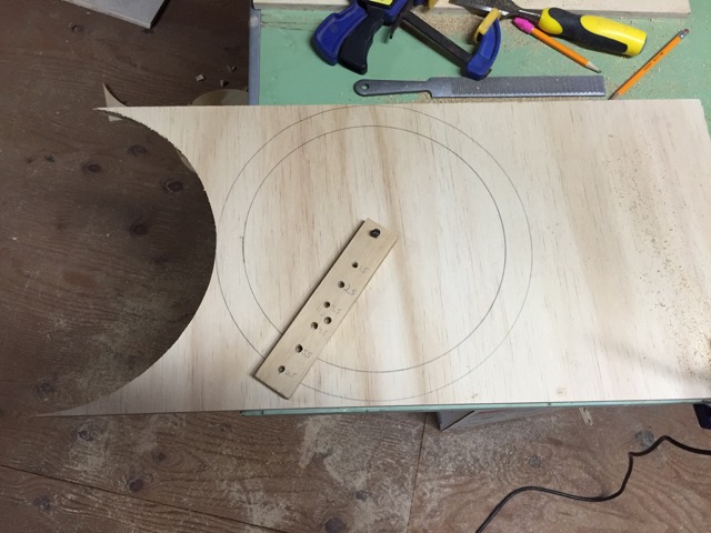

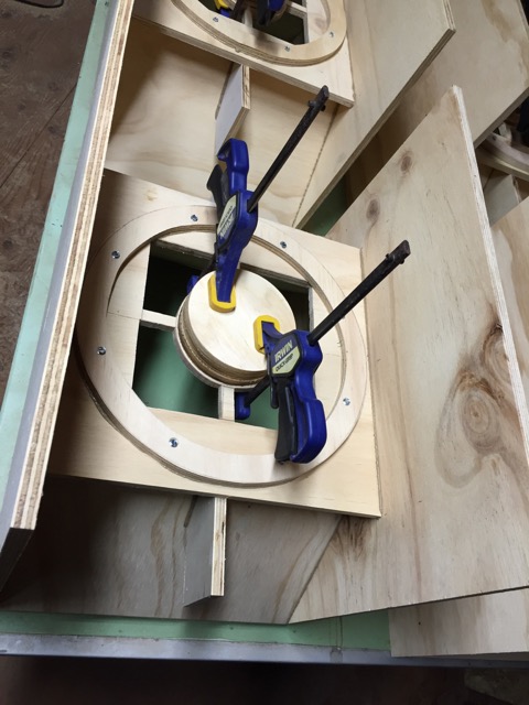

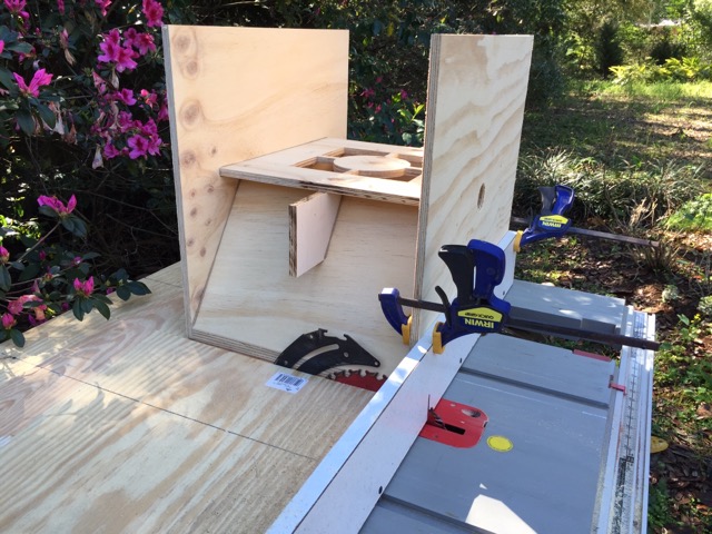

Made tiny bits of progress now and again over the last weeks. Got the horn panels trimmed flush - so glad I made the table saw sled!

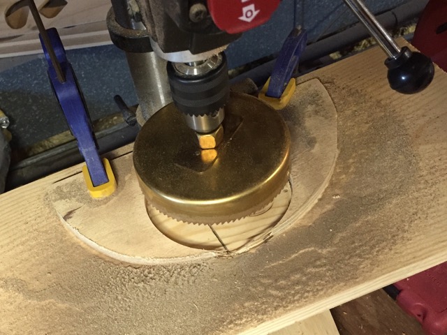

Cut out my phase plug pancakes from scrap, using a hole saw:
Cut out my driver anchors using my state-of-the-art compass:
Finally installed them tonight!

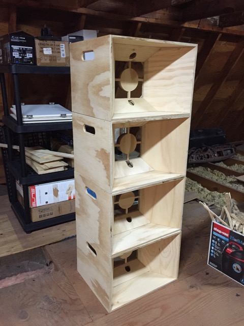

Eight side panels with port handles cut and routed, and installed. I even got all of the handles pointing the right way round!
At this point I was curious about weight. I had been guessing that each finished cab would come in at between 40 and 50 pounds. So I grabbed one of the completed (well, almost completed; I still have to do the access panel flanges) shells and put it on my digital bathroom scale. It didn't even light up. So I weighed myself with and without the cab, and the difference is 19 pounds. Add a couple for flanges and piezos, and no more than eight for the 2512 and filters, and that's under 30. Wow! Oh, I forgot the nice beefy steel top hats. Okay, so maybe 32. That's fantastic!

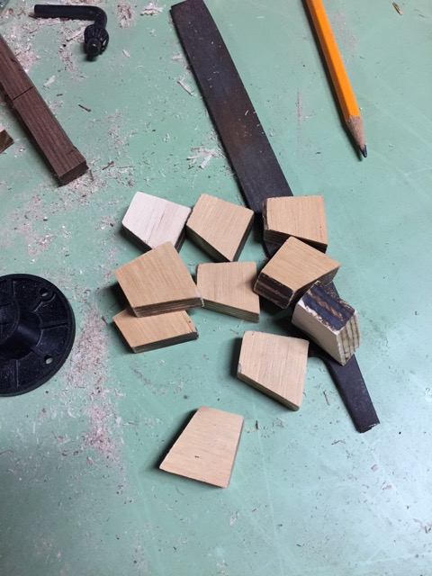

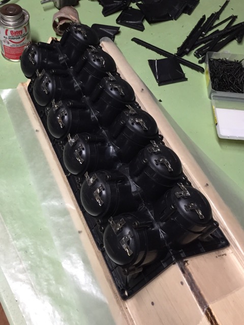

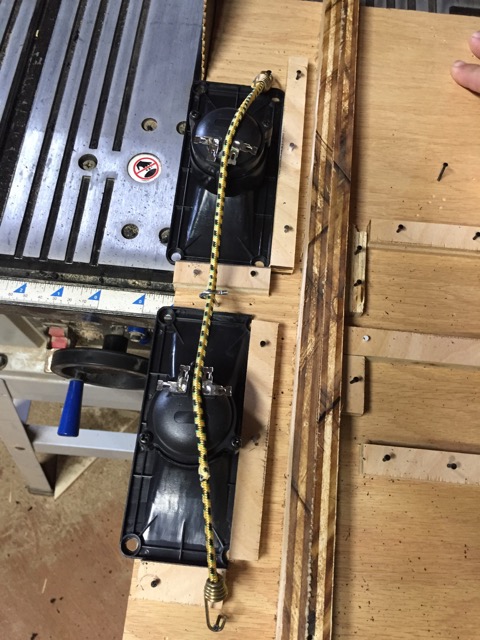

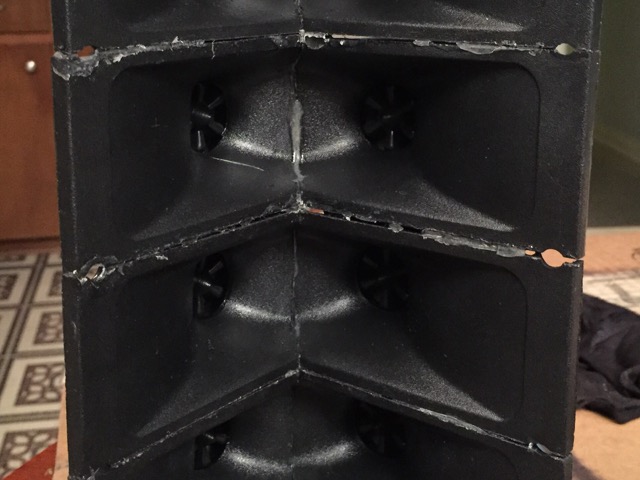

Alright, so here's the piezo cutting jig I threw together. It runs in the T-track, and one side is for the 90-degree cuts and the other is for the 45-degree cuts. A bungee cord holds the tweeters in position so that my fingers don't have to be so close to the blade. It didn't take me too long to figure out that I can cut two tweeters in a single pass on the 90-degree side!
And here's my very first melded array all glued up. Looks great in the pic, but I assure you, there are hideous gaps all in it. I'm trying to dissolve some of the offcut with the glue to fill in those gaps. It'll be mostly hidden behind a grill anyway.

Re: Another OT12 build
Oh my - does everybody's first melded array come out looking this hideous?

Pretty much. Put masking tape over the joints, add cutoffs from the piezos to thinned cement to tint it black, fill the joints from the back. After it sets pull the tape, smooth the joints wet sanding with 240 grit paper.ctmullins wrote:Oh my - does everybody's first melded array come out looking this hideous?
Haha, thanks Bill, thought it was just me! I'll follow your advice and report back.

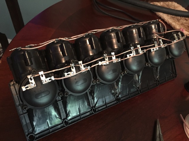

Worked great! Doesn't look perfect from the front, but that's okay, since I'm going to use grills. But the array is structurally very sound now. Got it wired up too.

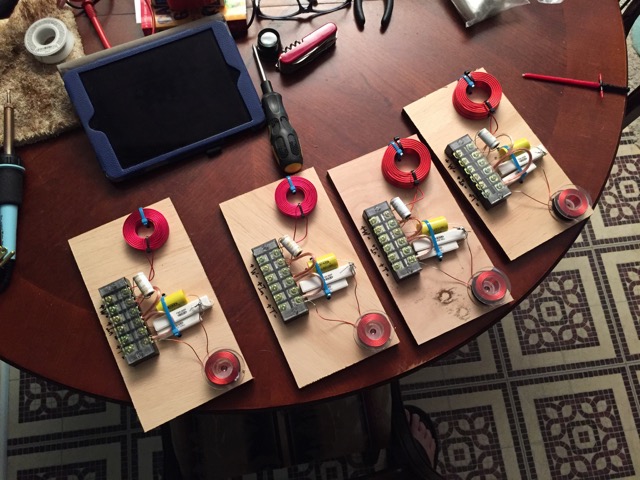

Also got four crossovers wired up. I put the woofer section on the left and the tweeter section on the right. The inductors are spaced five inches edge-to-edge, seven center-to-center, which should be plenty, right?
And thanks to whoever it was that suggested using terminal strips - that made the whole thing go a lot faster, and neater too! Only one solder point on each one, where all those thingies tie in on the tweeter side...

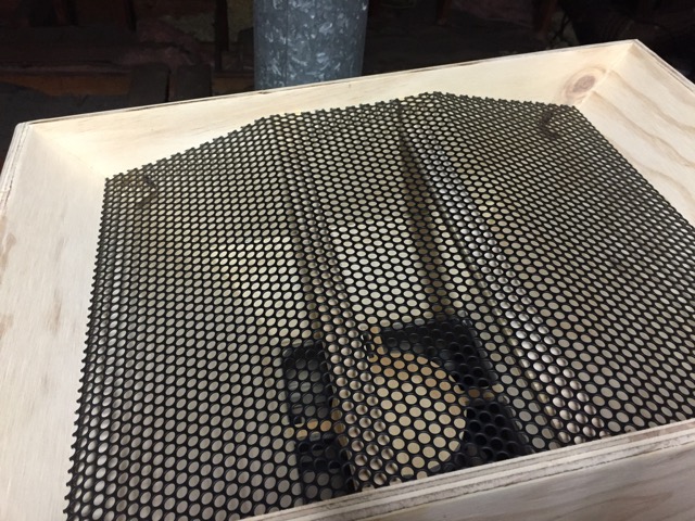

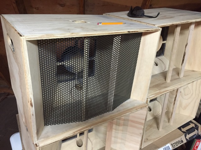

Not had a lot of time for these lately, but I am making slow progress. I got the piezo array brackets installed, and I got my grills cut out. I'm going for something slightly more stylish than flat grills along the front edge:
Now that the grills are cut out I can glue in little cleats at each corner to screw them to, at the proper angle (it's not perpendicular).

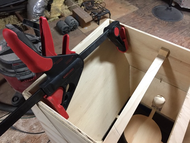

Back at these again after a bit of a hiatus. I have a bad habit of getting 90% done with something and then getting sidetracked...

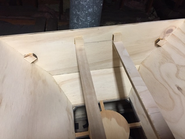

Got all four sanded with 80 grit, nice and smooth and even now. Drilled the access panels for jacks. Cut up some cleats for grill mounting.
Glued 'em in (love my big spreader clamps!).
One in each corner, and two in the center for the straight array cabs.
I eyeballed the angle; came out pretty good!
Ready for Duratex!
I really like the grilles. Nicely done.
