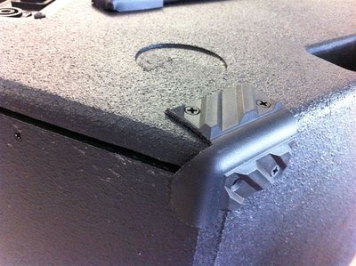

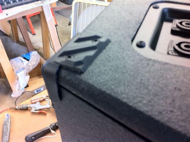

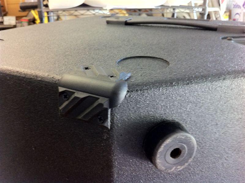

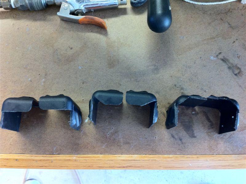

I am having problems making the penn elcom corners fit the odd angles of the WH 8's and thinking of using the rubber feet instead without corners. Suggestions on how to make these 90 degree corners work on the non-90 degree corners of the monitors?

Posts: 8664
Re: Wedgehorn 8's w/ horn finishing option
#29 Post by Bruce Weldy »
heavybdrums wrote:I am having problems making the penn elcom corners fit the odd angles of the WH 8's and thinking of using the rubber feet instead without corners. Suggestions on how to make these 90 degree corners work on the non-90 degree corners of the monitors?
Just like this.
