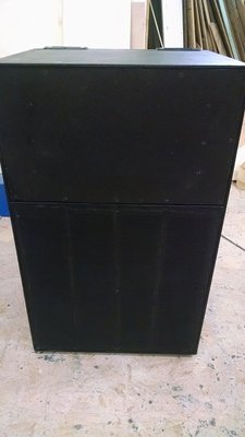

To me the "new" way is so much better. It's easier to build an airtight chamber since the only opening is where the speaker goes. Much easier to mount the driver. I'll also say that I did my own new way before the plans were changed and I like it better than what Bill came up with. Basically I make two panel sevens with the inside panel cut for the speaker to go through. That way the front panel can be reinforced with the cut piece and it stretches across the whole cab which looks much nicer than the "access panel look". Here's a picture that may give an idea of how I do the front panel.

The ONLY negative is that you need to build the cab up to a 1/2" deeper to give a "lip" for the extra panel.

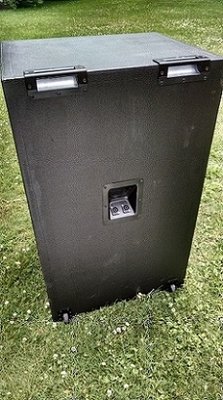

To the OP- don't skimp on the bracing for the back panel. With the quality of the work you're doing I'm sure you won't but that's an area that can use overkill. I don't recommend the recessed jack with 1/4" cabs at least on the back panel because it creates too much noise. I had a "rattling" with a 1/4" T39 once and it ended up being turbulence around the jack plate. The only way I fixed it was by turning it upside down.
With all that said a 1/4" T39 works if you need light weight. It is very light- under 40lbs. However, the entire cab as a complete system still resonates more than the 1/2". Difference in dB is probably negligible but I'm sure there's at least some loss. Still amazing sound especially with it being so light!

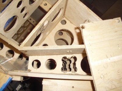

Got some more work done today. At this rate, I'll be done by Christmas.

Just looking at the pictures, its hard to believe much weight would be saved. Must also take twice as long to build.
I appreciate the complexity and craftsmanship of it all, though.
