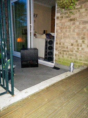

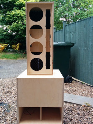

A bit of a cleanup and sand - I'm really looking forward to hearing this combo:
Re: T18 Build Thread
You know, I'll bet that's going to sound pretty damn awesome. Allthough, at high volumes the top might walk away from the sub a bit. But IIRC, this setup was built for low-SPL applications anyway, right?

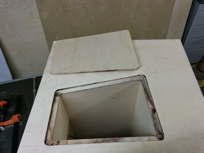

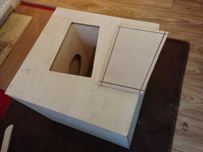

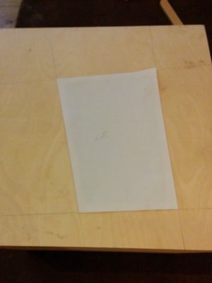

Ok, more progress. I'm not very good with a router, whether it's poor bits, crap router or just bad technique, it doesn't produce good results in my hands. I pondered for a while on how to make the access cover, so I decided to make a template out of paper:

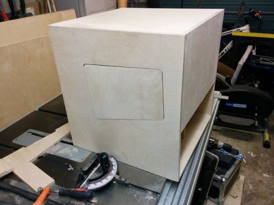

With the template made, I created the cover and used the table saw to indent the back of the cover:
Once all were cut, the cover fit nicely in the hole. I now had to route the cab so it sat flush:

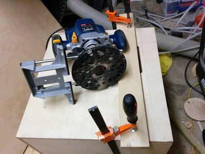

I decided to use an edge to run the router up to the line. This appeared to work well, though I had to be careful not to go too far:
A bit of sanding and a lot of burn marks, I had the routing done.
I had to do a bit more sanding and tweaking to get the cover to fit but I got there in the end:

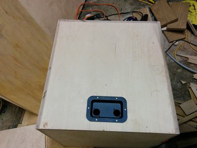

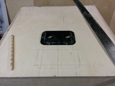

The last thing to cut was the plate for the speakons, no problem!
I've filled the holes with wood filler and I'm waiting for it to go off before the final sanding and a coat of paint.

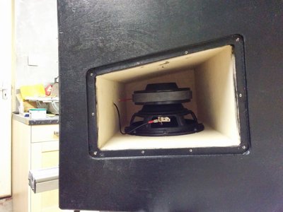

I've had lots of stressful times building Bill's speakers before but fitting drivers with TNuts is always up there. I have come to the comclusion that Bill must have the smallest hands on the planet as getting this bloody driver in was a pain in the arse. If there is a leak when I test it, I'm going to cry.....
Bill, next time you revise the T18, give us a little more room above the driver for the Tang Band users!

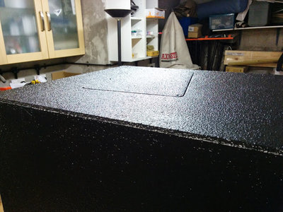

It's the time for the final coat of textured paint. I bought a new roller as the old was way past it's best and literally starting to fall apart.
