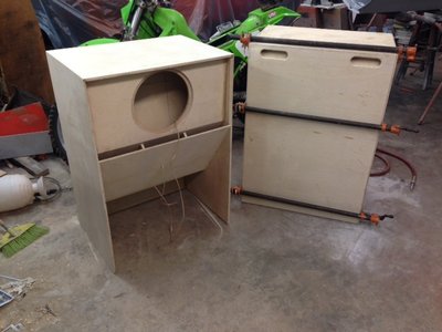

We have gotten further along with putting the these together. Because of the means of joinery, the order of piecing it together was changed a bit.
The issue voiced here was getting the last side onto the cab do to the dado groove that the inner panels need to fit in. I was not too concerned and Tim was not concerned at all.
Let me again qualify, I'm not suggesting anyone do it this way. However, if you do have the skill and desire to do rabbets and dado's then our order of assembly will make it easier. The approach is kind of a modular means. It would not work doing it with butt joints so don't try it. The rabbets and dado's allow this approach to assembly.

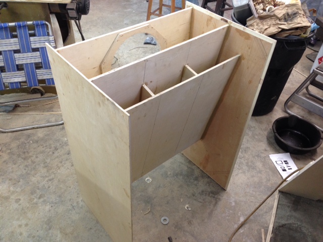

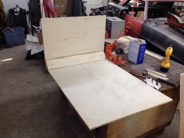

In the last pictures, the inner panels were glued together (baffle, 3, 4, 5, 6) using the dados of one side panel to assure their proper alignment. They were not at that time glued to the side panel. These were then removed. The top and back panel were assembled with panel 9 (that top back upper corner piece) again using the side panel's rabbets to assure alignment. The top and back were rabbeted also which aids the alignment and squaring process. Doing it this way made putting panel 9 in a breeze.
The braces were cut, the inner panels were set back into the side panel and the braces for panel 3/5 and 4/6 were put in place. With that done the other side panel was put on. As Tim wrote in his note, a piece of cake. The top/back assembly was then put in place. This is how they currently are in the pictures.
With this order of assembly, the last 2 panels are the bottom and #11. The braces for panel 5/8 (back) will go in from the bottom. The bottom goes on and then panel 11 is put in place through the throat opening. Panel 6 trim will be put on as we do the flanges and finish that bracing. The trim was cut at the time of the other inner panels and are ready to go.
I will be putting 2 sets of connectors on these. 2 front in panel 6 and 2 rear bottom of the back. The fronts are to avoid someone hitting the connection if they are wall or corner loaded.

Back and top on.
Back and top on.
Baffle, inner panel assemblies with sides on.

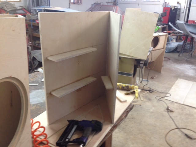

Here are a couple more pictures. This is the 5/6 panel with the braces going in place to meet the baffle/4/3 assembly. The 5/6 assembly is set in the side panel dado's and then the baffle/6/3 assembly is added to it. Everything is square and the other side panel goes on. Tim's word was actually "like butter".
The next photo is the assembly of the back panel, top and panel 9.
