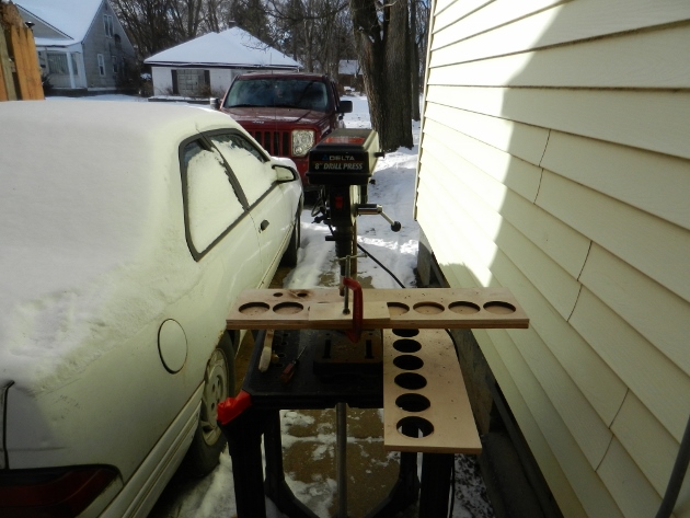

Antonz oddly enough I got the idea to do that on one hole lol.I drilled a hole in the middle with a 3/16 drill bit.i'm about to go tackle the 1" holes and its 5 degree's outside,i will drill holes in all the centers first,that should help.Thanks for the tip.

It is not about a hole in the centers, it is about a few holes touching the circle that the hole saw cuts so the saw dust can fall down instead of filling up the circle that the saw is cutting. Sorry if I am not writing it down very clearly, I'm not a native english writer
Re: SLA and Tuba 18 build
For drilling smaller diameter holes in wood, a Frostner bit is the way to go. It doesn't saw into wood, it shaves it. So it takes less speed and runs cooler. Plus it makes nice really nice clean holes. It the only thing I'll use to make holes.
Just make sure to have a piece of sacrifical wood underneath to prevent possible chip-out.

I understood what you meant AntonZ,it worked a lot better.
Jimbo I thought about that but the holesaw worked out and I didn't have any tear outs to fill.

Not even a Michigan Winter can stop the addiction...
