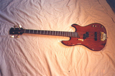

Beautiful bass. Notice creep isnt noted with titebond original

A little off topic: That's a gorgeous bass, but there appears to be something funny going on with fret spacing from fret 16, or is that just my eyes?byacey wrote:It's the problem of creep mentioned in the text you posted regarding Titebond; this is exacerbated with heat and constant tension on the glue joint.

Thanks for the compliment on the bass. It was the first guitar that I made, although I built quite a few violins (using hide glue) before embarking on that project. I used Cocobolo for everything. The body core is made up of about 16 pieces of Cocobolo scraps that I laminated together, and then faced over with 1/4 inch thick pieces of Cocobolo on the front and back. I figured the core inside was a good place as any to use up my scrap cuttings.
The neck is one piece without a separate fret board; I simply put a radius on the front and installed the frets into the surface. The surface is still almost like new after years of playing. The truss rod was installed into a channel routed into the back side of the neck, and filled with a strip of maple for contrast.

Good eye, and a blatant foul-up on my part.Rune Bivrin wrote: A little off topic: That's a gorgeous bass, but there appears to be something funny going on with fret spacing from fret 16, or is that just my eyes?
The fretting jig I built slipped unnoticed while I was cutting the fret slots, and that particular fret was misplaced. At the time I thought I might plane it flat and install a separate fretboard to correct the error, but I figured I would use it as-is for awhile and see if it was worth the effort to re-do. After playing it for some time, I found that I rarely played up there in the genres of music I was playing, so I just left it. Later instruments I always took great pains not to allow that to happen again.

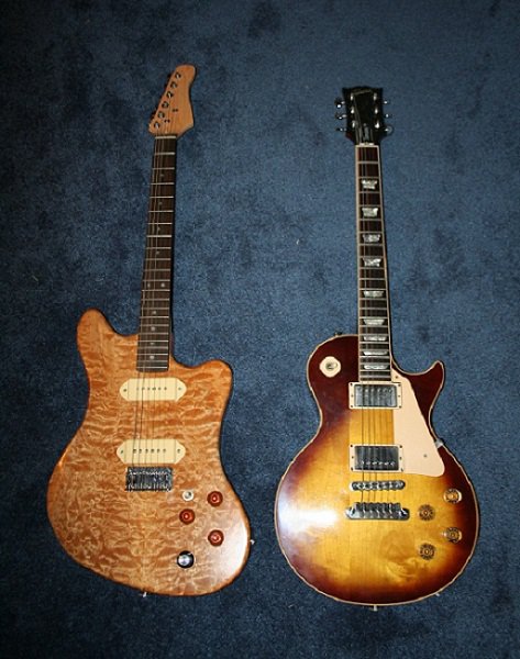

the guitar on the left was my firstbuild . All PVA (granted the kneck is one piece plus freboard), 4 years (and many a hot car later) and its still gettin it. (granted the kneck is bolt on).
