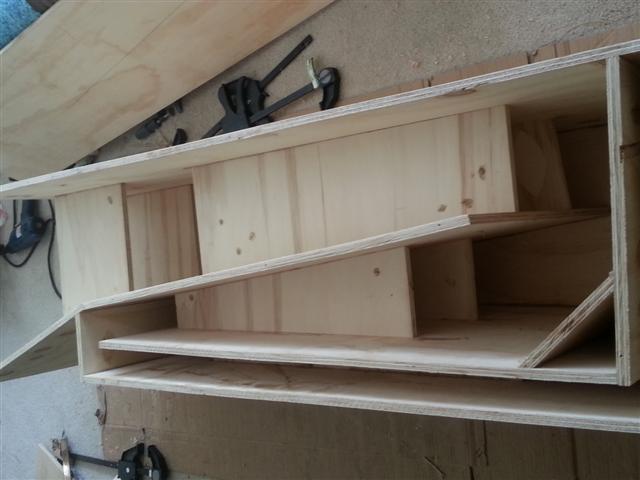

Assembly is almost finished. Only have the side left to attach and then install the driver. Still haven't quite decided how I'm going to finish the cabinet. Really wanting a dark oak wood grain finish which means about $100 for oak veneer. I could do the panel that will be facing out and the panel six in the veneer and paint the rest with duratex. Not sure yet.
Always open for suggestions on the finish.

Finished assembling cabinet Sunday. First test monday, had leaks at the driver mounting holes. Just had to hear it though, all I can say is wow. I knew a horn was efficient but this really surprised me. Figured a good one to see how it sounds is C&C music Factory's gonna make you sweat (go ahead and laugh, I happen to like that song). Sound level meter showed about 107 average and 113db peaks with voltage measuring 9 to a little over 20, and the amp is capable of 41 volt peaks. And that was with it laying in the door, not even close to a wall. Can't wait to watch a movie with this:D
Removed the driver and put a bit of caulk in each screw hole, reinstalled and tested for leaks again today. No leaks
Still need to trim panel 8 and then I'm gonna putty the dents and fastener holes this weekend. Going to cover it with a laminate (anyone know where to get Black Ash, apparently its not in style anymore and no one has it, go ahead and call me old fashioned but for a sub I think it's perfect my taste). If not I'll use one of the textured dark ones from Parts express.
