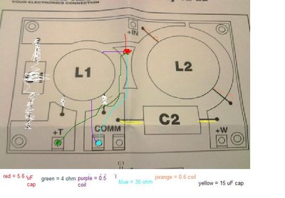

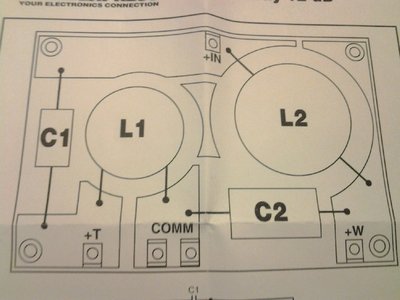

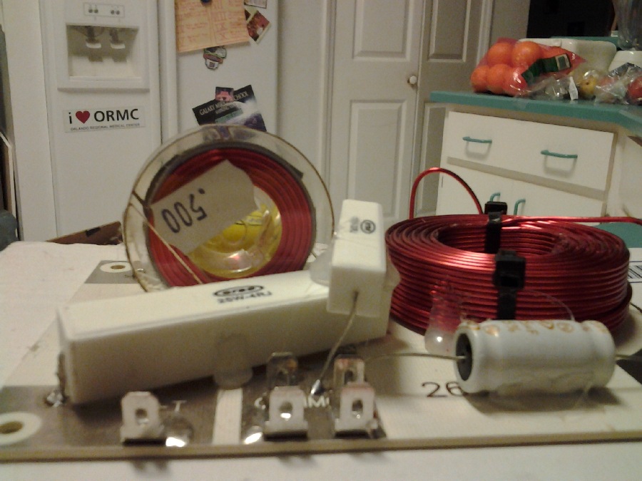

Ok guys I need to know if I'm on the right track here. I decided to use the trace in the middle of the board to connect the HF Cap, Coil, 4ohm resistor to the T+ trace only and the 30ohm resistor over the 4ohm resistor from the middle trace also to the common trace. I believe that will satisfy the circuit design but I want to make sure. Please give it a look over. I laid the resistors upside down so not to bend the leads. The Cap & Coil leads are just laying on the middle trace to show where they'll go. See attached pics.
Re: Jack Crossover Assistance

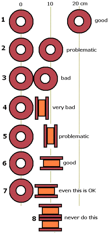

Turn your smaller inductor upright and make sure it's perpendicular to the larger inductor, it will eliminate cross talk. It may also give you more room to place your resistors better...
+1 to what Grant said.

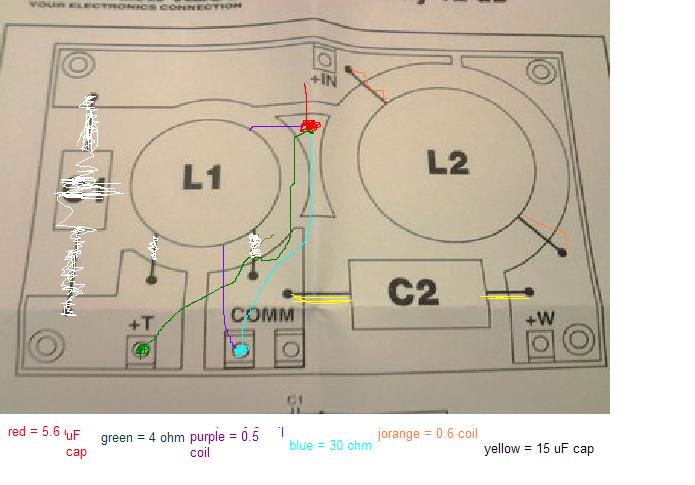

Here is a picture redone in "Paint". I can't tell how the resistors are wired due to camera flash, even after I zoomed in. If you zoom in you can read what each colour represents, with the white indicating that C1 is rubbed out. Hope this helps.

Here's a pic that been posted many times, but always good for someone who may not have seen it as far as inductor placement . . .
Dave H
Tom that's exactly what I was getting at with the new layout of the Xover.
Grant & Hackomatic thanks for the tip on the inductor position and it's effects to each other. Learned a lot from you guys.

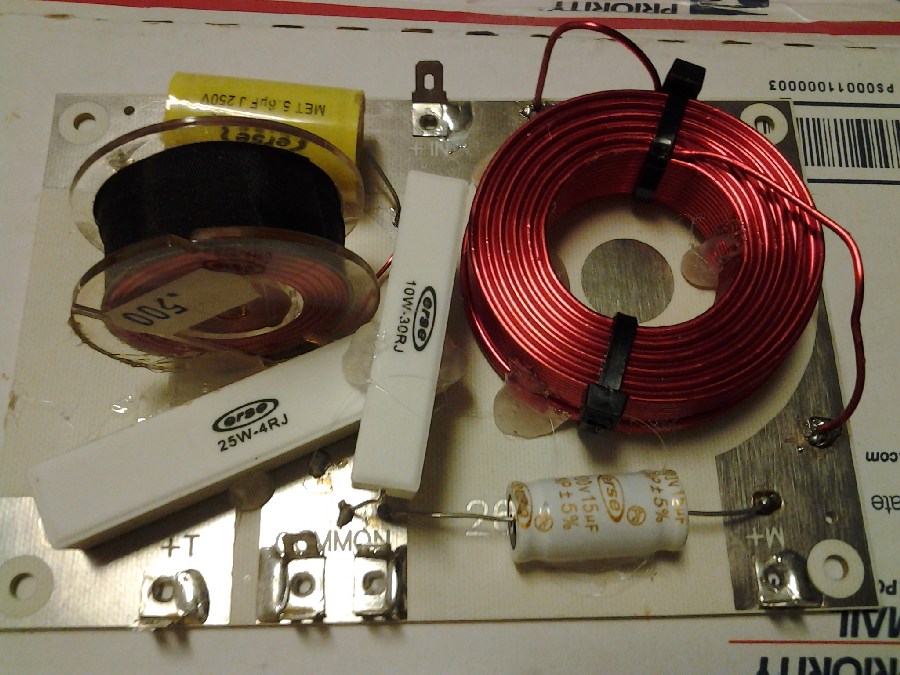

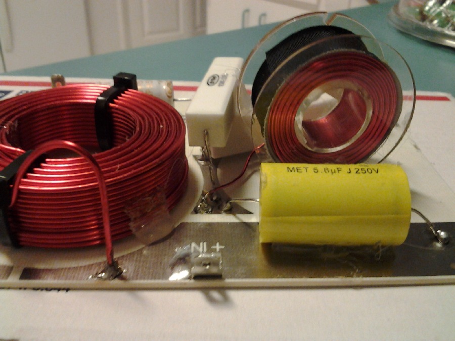

Well I did it. I setup the components to the unused trace then connected the resistors to their perspective connections. Had to stack the 30 ohm resistor atop the 4 ohm as I didn't see any other way it could be done. Setup the coil on it's side and perpendicular and hot glued everything down to the board along with the 30 ohm to the 4 ohm to resist vibration and movement. I hooked up the drivers to test it and it worked. I attached pics for your viewing pleasure.
Is there a way that I can test that the crossover is working a prescribed. I only have a simple meter nothing else.
You can test everything but the capacitors. The won't show continuity, but everything else will. Test from foil to foil across any connection that does not flow through a cap. The first cap in the hf section, and the shunt in the lowpass.
If you have an old, analog multimeter you can test capacitors. Put the meter in Ohms, and put the test leads across the cap one direction. Then reverse the leads (swap plu snad minus, and the meter should deflect (perhaps up, perhaps down) for a brief instant. The deflection may not be noticeable on smaller value caps, but larger electrolytics should move the meter.LelandCrooks wrote:You can test everything but the capacitors. The won't show continuity, but everything else will. Test from foil to foil across any connection that does not flow through a cap. The first cap in the hf section, and the shunt in the lowpass.
I know you said it's glued down, but see if you can get a zip tie on that smaller inductor, as well...
Actually, add zip ties to everything mounted to the board. The parts might get hot enough to melt the glue but the ties will keep it positioned until cool down and the glue resets.Grant Bunter wrote:I know you said it's glued down, but see if you can get a zip tie on that smaller inductor, as well...
