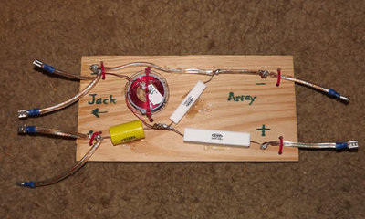

EXCELLENT CHOICE my good sir. I have the same rig and I'm using it for the same purpose and it really pumps. The V-plate is well worth making as well - I DO notice a difference with it on. It certainly looks different to the line/stacks of subs you see with other rigs... Personally, I don't think it quite looks as good as a line of subs but I know the difference that it makes in the sound department, so I stick with it. It will certainly make sure that your rig stands out though... everyone will know it just from looking at how your subs are stacked :)
Your crossovers are looking good... mine look way worse than that, but the Otops they are connected to sound sweet, so job done! One think I saw AFTER building my crossovers was that some people stick the components on the 'top' of the crossover board, and then drill a holes for the wires from the components through to the 'bottom'. They then do all the soldering on the bottom of the crossover, which results in it looking very neat, with only the components visible from the top AND as a bonus, the components are held in place slightly tighter (not that the wires should really be load bearing!!)

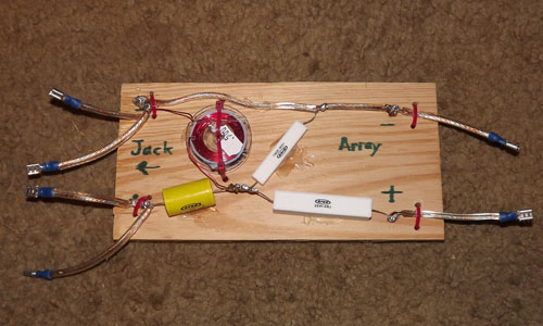

I've implemented Grant and Bruce's recommendations and I present to you: High Pass Crossover 2.0!
It sure isn't going to win any beauty pageants but connections are solid and components aren't budging. I'm hoping I did good this time :fingers:

:clap: Loving the quick-disconnects. Just use a needle nose plier to "squish down" the female parts a bit, so that that you have to "force" the male sides in a bit. It's a PITA, but it ensures that they will not come apart from vibration during normal use. I really like using male/female disconnects, b/c it allows you the convenience of serviceability later on, should something blow up/act funky/etc.
My tweeter arrays are wired to the crossovers with M/F disconnects for that very reason. Should something go wrong, I take out a few screws to release the array from the cab, unplug two quick disconnects and the array is free to be worked on.
Solder is permanent, but you can always desolder or just cut/paste later, but that's a PITA and requires "big tools" vs. just disconnecting something and fixing it "away from the cab."
You're doing great, with the right outlook on things. Keep going.

Just realized I set this crossover up to do the opposite of what Grant said. I have two leads coming off the jack end so that wires can be continued from HF board to woofer board...
Grant Bunter wrote:Bill always recommends the filters to be on separate boards, one for the woofer and one for the tweets.
So yeah, run a wire in parallel from the jack to the woofer board, keeping your + & - sorted, and then continue those wires to the HF board.
:wall: :cussing:

Those two leads off the jack should be used to chain another jack parallel to the first jack. That's so you can run two 8-ohm cabs per channel. Like this.

MisterB wrote:Just realized I set this crossover up to do the opposite of what Grant said. I have two leads coming off the jack end so that wires can be continued from HF board to woofer board...
:wall: :cussing:
Don't panic lol
Just go jack --> HF board ---> LF board with those wires instead.
The HF filter will still reduce the power to the HF array and all is good.
Mark your + and - on the input sides as well. You'll see why later...
