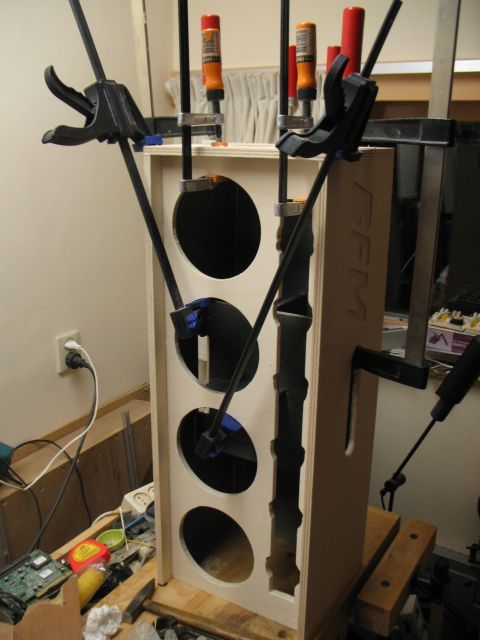

So every now and then I have added a drop of glue, a clamp, a day goes by, repeat and we end up here with the first cab.
Sorry for not taking pics along the way for a while. Progress was really really slow. Still have to start glueing the 2nd cab together, so I may take some more shots on that one.
Anyway, most of the openings will be closed, eventually. Drivers, arrays, connectors, top and bottom panels. But the port openings on the sides remain open. They are both handles and ports. This poplar wood is rather white. I'd rather not have the insides show through. So I had this jar of black paint. Turns out it was all dried up. I only had time to go to local shops, none had any black paint. So while I walked home from the shops, I had this brain wave. We have young children. They like to tinker with things, paper, cardboard, scissors, glue. And paint. I know we have blue, yellow, red, white. Do we have any black? I asked my daughter when I got home and sure we do. Can I use some? Sure you can Daddy. I love my daughter.
It is not pitch black, it is dark enough for me.

Thanks Mike. I will not do contrasting colors in the logo. Too much trouble to keep that neat. As for damping: there is a DIY store in the area that has egg crate foam in a dark grey. I have used it before on other cabs, I will use it again on the SLA's.
Tonight I did the bottom panel. No such thing as having enough clamps in the workshop.
I don't have clamps long enough for the entire length of the cab, so I used the driver and socket holes instead.
Only the top panel left to go (cab is upside down in these pics), then it is on to the finishing stage. No illusions about the speed at which that will happen.
