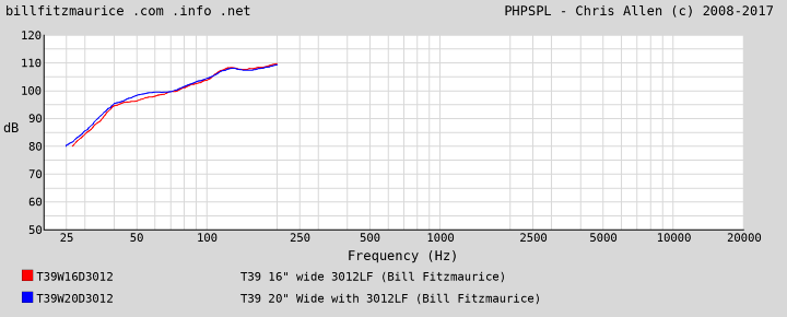

Not that much difference between a 20" and a 16" (minimum width) wide T39:jswingchun wrote:I have a pair at 20" and a pair at 28", that's why I was thinking of building a minimum width set. More options at setup.

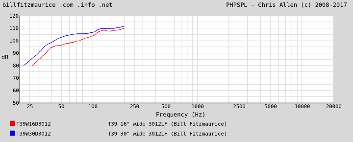

Much larger difference when you step up:
Use 1 or 2 20" wide for the little gigs, and add from there. Are the 20" too much for you now? I just don't see the logic in adding 16" wide cabs to the pile. Please help me understand your thought process as I am very curious now.
