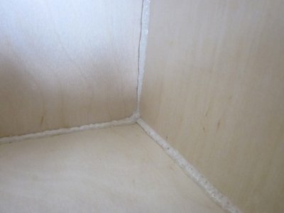

OK, glueing up report. This was over a week ago so I'm just catching up. I was a bit wary of screwing jigs of scrap to the panels for alignment (as in the plans) as I was worried about the jig sticking to the cab and not being able to get it off. I tried using clingfilm as a barrier but this just stuck to the adhesive. I also preferred not to have a lot of holes to fill so, having a few clamps available, I decided to try a screwless approach. This was more straightforward than I thought and the cab carcass has come out pretty straight and well aligned, although I did have to temporarily screw bit of hardwood to the inside of the odd panel to combat warp.
The Lumberjack adhesive has been quite easy to work with. I'd seen reports about how messy PL could be so I was pleasantly surprised. Squeeze out expanded into a reasonable fillet on the inside of the joints, and excess on the outside was easy to trim off using a craft knife.

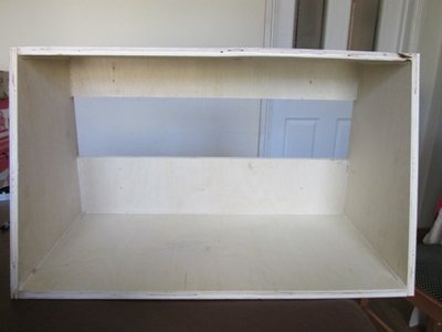

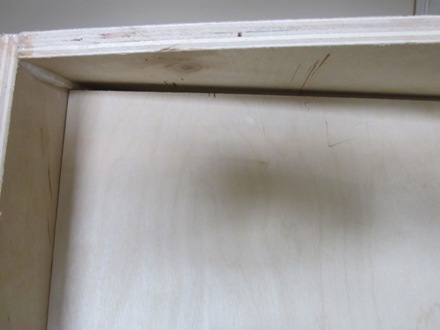

My next job was to cut the angled edges on the baffles. The angles didn't prove too much of a problem but unfortunately I ended up with a large gap between the baffles and the top of the cab.
I've documented this on another post so I won't go into detail here, though I'm still confused as to how it has happened as I'm sure I've followed the plans to the letter.

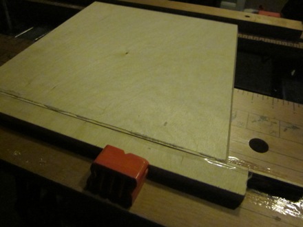

The recovery plan is to cut two thin strips of ply and glue them along the tops of the baffles (thanks DJPhatman)

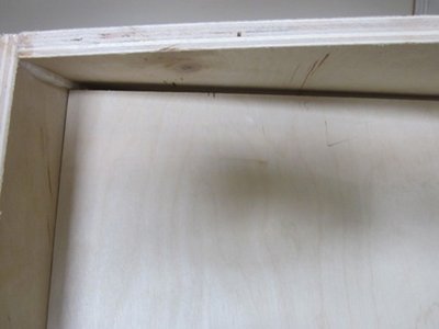

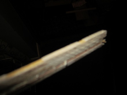

Cutting the thin strips to extend the baffles revealed that my ply was worse than I thought and it is now obvious that it has a thin outer veneer. I guess this means I will have to reinforce all my butt joints with screws after all.
Using Charles' advice of using Sellotape to prevent the adhesive sticking things I didn't want it too, gluing on the strips was pretty straightforward.

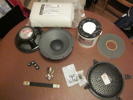

Drivers and hardware have arrived so it feels like more than just a woodworking job now. Had a bit of a worry with one of the drivers which gave a scraping noise when I tested it by pushing the cone a bit. Separated the speakers from each other and was ready to send it back but someone moved it and put them both together again. Got them them both out of the boxes and tested them again to work out which was the dodgy one and they were both perfectly silent! Not sure what happened there - pretty certain I wasn't pushing at an angle. If I hadn't taken a video to send to the supplier I might have thought I'd been hearing things. Anyway the supplier's noted it and so I can send it back if there is a problem when I start using it.

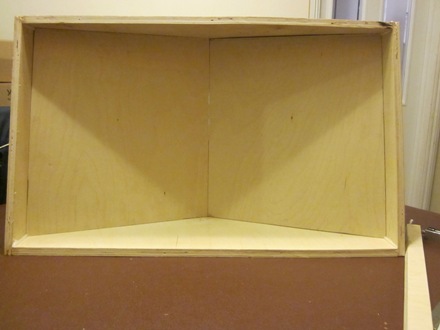

Baffles are now corrected. Dry fitting them showed I'm just left with some minor gaps now which adhesive will easily fill. I've marked the baffles ready for cutting the holes and I'm now just waiting for the rain to stop. Going to be using a router for the first time for the holes - think I'll have a quick practise on some scrap before risking the baffles.

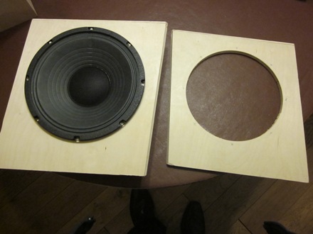

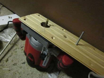

I've now routed my baffle holes (that must be a euphemism for something!). It was the first time I'd used a router but it was pretty straightforward. I used a simple jig I made out of thin scrap wood to guide the router. To be honest, as the drivers are front loaded on this cab, cutting with a jig saw would have been adequate as the holes aren't visible.
I'll have to wait for my new order for tee nuts and socket cap screws to arrive before trial fitting the drivers - I'd thought that they might be included with the drivers but no such luck (although tee nuts and bolts were included with the grill clamps which only cost £1 per set!).
I got the 10516s as I'm going to wire them in parallel via a second switched socket. I will normally plug into the unswitched socket resulting in both speakers in parallel to give an 8R load rated at 150W. Plugging a jack into the switched socket will isolate the two speakers giving me 2 x 16R loads rated at 75W each. I can then run through one or the other if I have a problem with one driver or with the 8R output of my amp (so I could at least finish the gig). I could even run the speakers in stereo with this arrangement - the cross fire cab should give decent stereo separation which may have its uses.

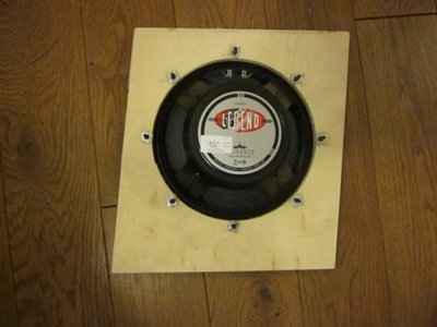

Tee nuts are now glued in with epoxy. I needed M5s for the 105 drivers (mounting holes are 5.7mm as opposed to 6.4mm for the 12"s). Screwfix (and other local stores) only seem to stock M6 and M8s. Blue Aran had some M5s here in a couple of days.
Trial fitted the first driver and inevitably I had drilled one of the tee nut holes very slightly out of position and couldn't get all the mounting bolts in. Tried a few times hand tightening the bolts in a different order but to no avail. Tried the second driver / baffle combination and that was OK. I was contemplating my recovery plan for the first one (drill out the tee nut? file the mounting hole on the driver a little bigger?) when I thought I'd just try swapping the drivers over to see if there was any difference. Success, both drivers fitted OK, though this does diminish the reason for using the tee nuts in the first place as I may have the same problem if I have to replace a driver. If I upgrade the drivers I'll have to go with Celestions as their mounting holes are bigger!
