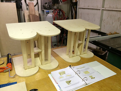

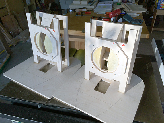

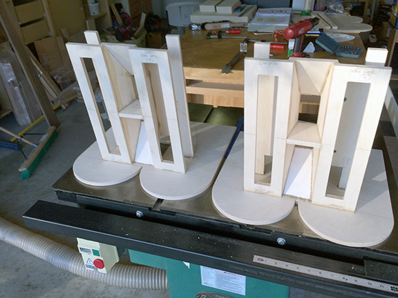

Well, today I worked on the top and bottom. Pretty cool on how the layout works. Felt like I was doing geometry problems. Bill definitely put a lot of work, effort, and time to make the plans this "easy". It was an exercise of making sure to measure twice (sometimes more) and verifying you did it right. Even after studying the plans for quite a while before this build, it's still quite different to really do it. Those couple of pages had to be read over and over again. But it's definitely worth it. Now it's really starting to take form. Excitement is in the air. I really have to keep myself patient and not rush things.
These are smaller than I imagined they would be. Not complaining mind you, in fact I'm liking the size. So looking forward to hearing them when I'm done.
Here's the pics. Not as many as there usually are. I was concentrating too much to remember to take as many pics.

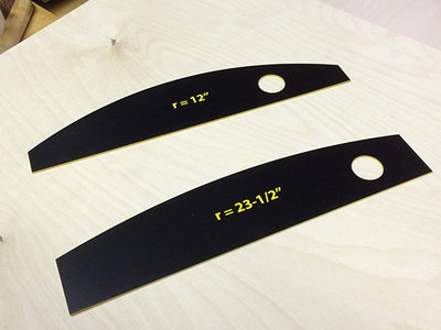

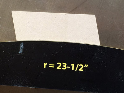

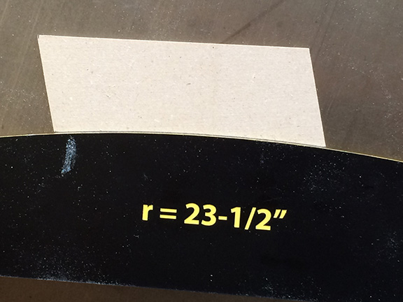

I like your brace radius gauges! I have a few of those for setting string height on my electric basses. They are just cardboard cutouts made from an online template, but they work well.

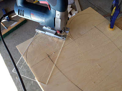

The fillers aren't very difficult at all. I found some purple construction foam at HD that is the correct thickness. It came in a 3'x3' sheet I think. I made a compass out of a scrap piece of wood and two screws, and etched the two circles of correct radius on the foam.
Cut along the larger circle with a jigsaw to create a disc, and then use an electric hand sander with 40 grit paper to create the discus shape. Then cut out the middle section. Took me 15 minutes. It doesn't have to be perfect. It just has to not have the driver bash into it.

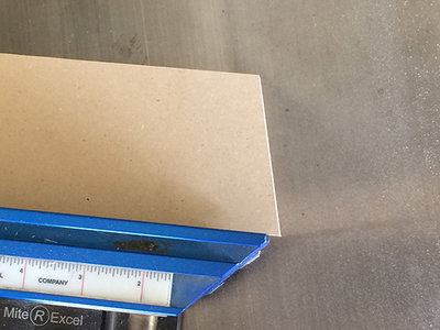

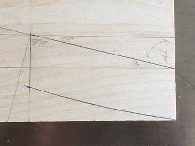

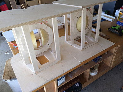

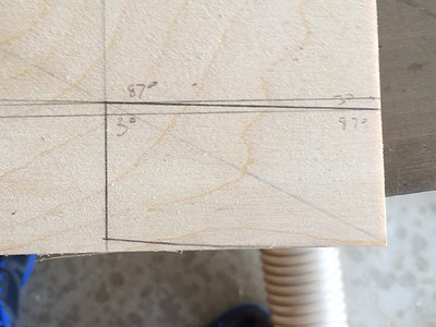

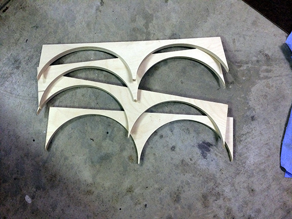

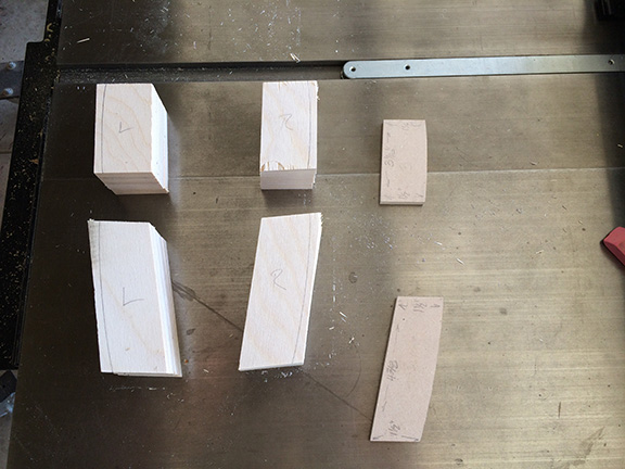

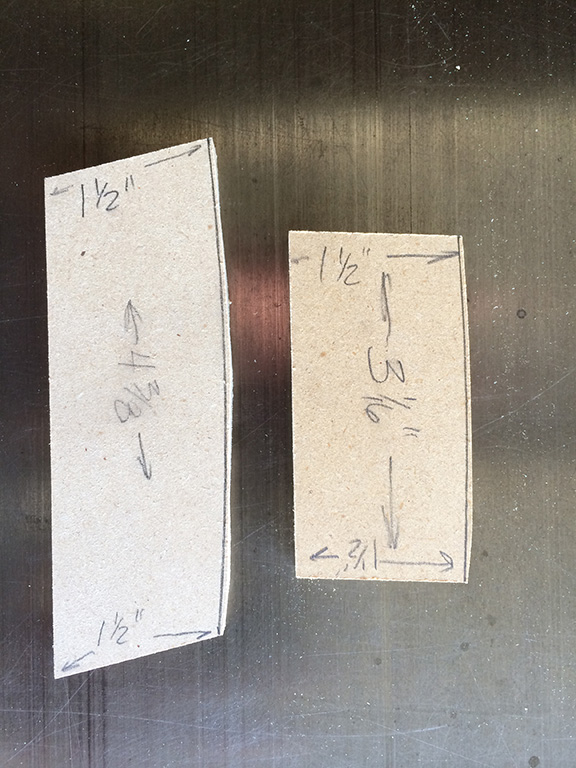

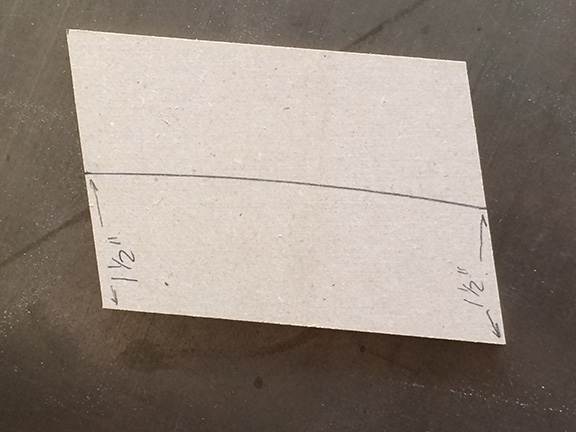

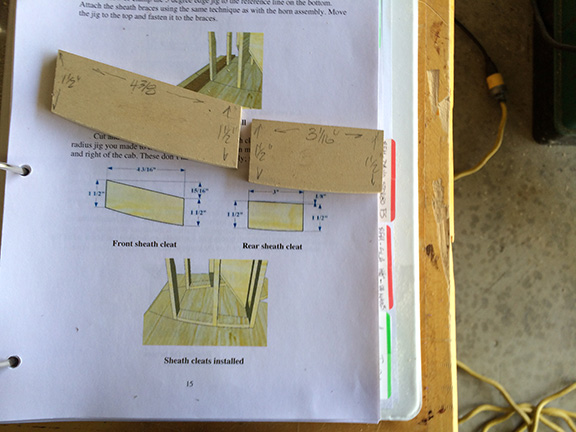

Today was tackling the woofer driver section. It has a lot of small parts with curved and angled cuts. I decided to cut and pattern route them in bulk, and them trim then to fit, just before installing. First I removed and cleaned up all the squeeze out from the PL from the previous part of the build that would be in the way.

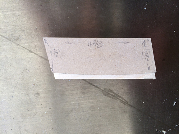

Next, I did layout of one each of the front and rear driver chamber sheath braces on a piece of scrap. I was looking for the angles of the angled cuts. The angle for the longer sheath is 13 degrees and the shorter, 3 degrees. Then I made a routing template out of 1/4" MDF with the 23-1/2" radius for both.

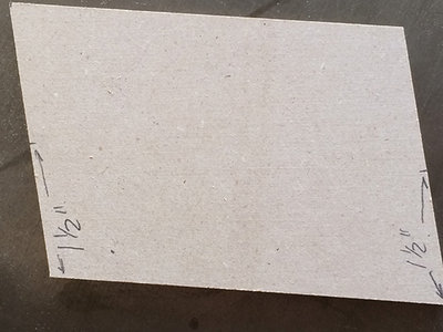

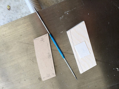

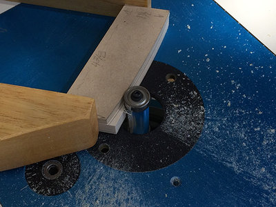

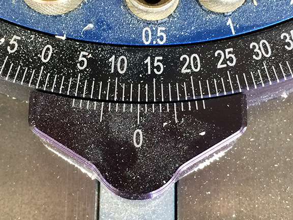

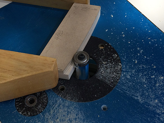

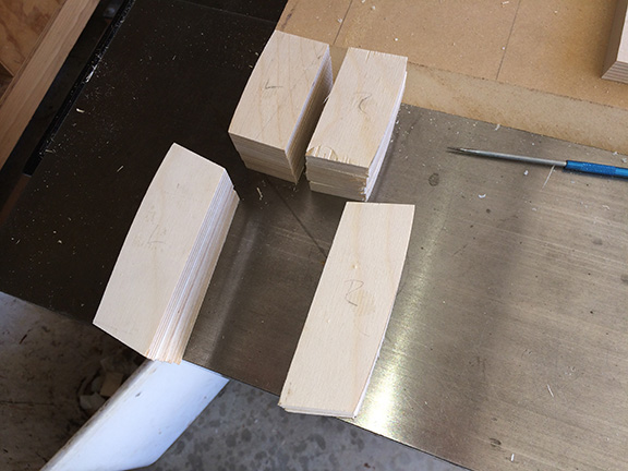

(Cont.) Then I made a routing template guide of each piece using 1/4" MDF. Then I bulk cut all of the long and short pieces with their angles using the miter gage and table saw. I traced the radius curve and rough cut close to the radius line.

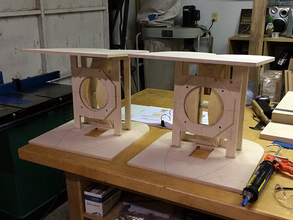

Re: Journey - DR200 Build
(Cont.) I attached the routing template using double-sided carpet tape. Then I routed the final radius profile on each piece, using a pattern bit. Because the pieces are small, for safety and better control, I used a wooden woodworker's clamp to hold the pieces as I routed them on my router table.
Then as I installed the braces, I trim cut each piece.
