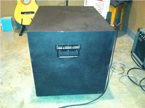

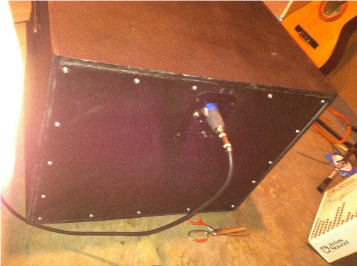

I put the finishing touches on this cabinet last night. I've already played 1 show with it as a bass cabinet and did a couple of outdoor DJ gigs with it. Here are a few pics...
All told, I've got less than $500 in it. I ended up priming the entire outside of the cabinet. I coated the top, bottom, sides and back with roll-on bed liner and just spray painted the front of the speaker with flat black spray paint. The bed liner is some tough stuff, but not the easiest stuff in the world to apply. Nonetheless, I got a usable, durable finish.
As you'll see from the 3rd image, I have parallel speakon input jacks and a DPDT switch for turning off/turning down the tweeters. I'm really glad I put that on there as I can turn the tweets off when used as a bass cabinet and turn them on when used as PA. Very handy.
