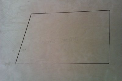

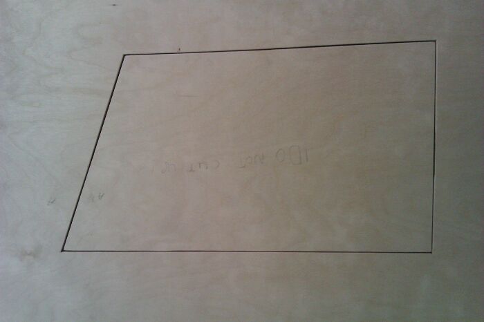

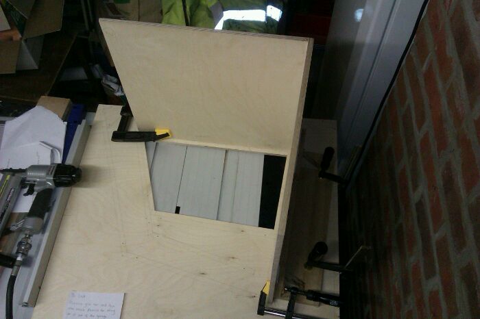

After marking the panel layout and drilling through for the nail fixing centre lines, i cut out the access panels using the above mentioned method, and decided to dress them before proceeding, rather than trying to neaten them up later. Then i got numbers 1 and 2 panels assembled on one cab. I would like to be able to do the same joints in the same session on both cabs but i think thats a long shot, in terms of not enough clamps and assembly jigs, and i dont have loads of room and don't want to move them a lot while the PL is going off. And finally, a note off the 5 yr old (written by mum) after I'd banished them from the garage. Evil Dad.

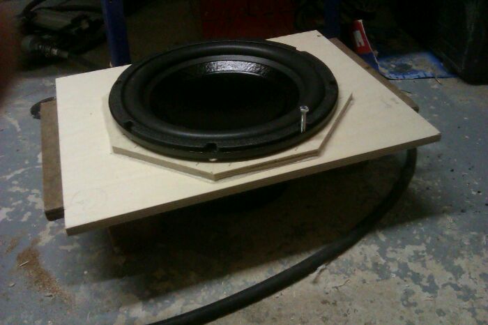

I'm onto something worth reporting at last. Here's how I marked the holes. Drop the driver onto its baffle spacer mounting face upside-down, and let the speaker casting webs centre the driver to the hole it sits over. This gets the driver bang on centre to the hole cut-out. The M6x40 screws have a raised outer edge, so a mild hit with a hammer marks the hole positions.

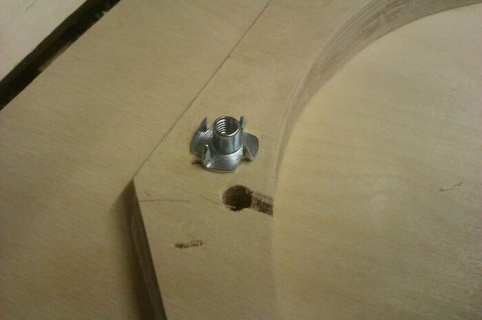

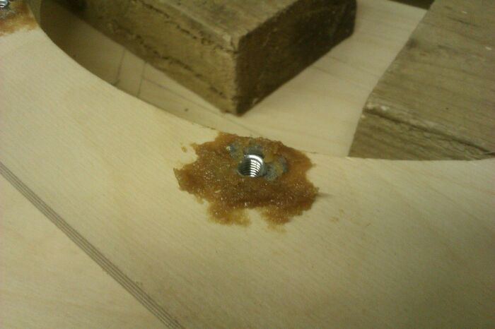

When I opened out the through holes to the 8mm required for the boss of the T nut, 3 out of 8 holes the face ply split off on the gasket mount face. However, this is a minor repair, and I figure its worth having the full 8mm hole through so screw alignment goes ok on refitting the driver.

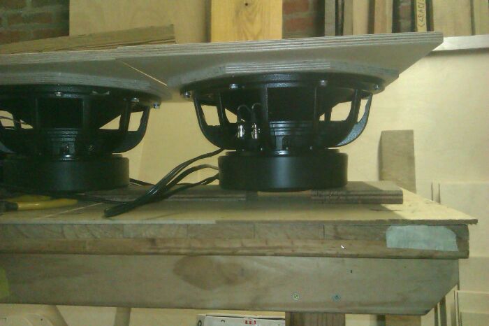

Here's testing the surround to baffle for rubbing. No rubbing, due to centering being bang on. Drivers shown spaced off bench so vent can breath.

Don't waste your time patching that, as it's no big deal. The gasket will keep the air inside the baffle where it belongs. Out of the 32 driver mounting holes I drilled for my T48s, I have probably a dozen holes that look just like that.Charles Jenkinson wrote:When I opened out the through holes to the 8mm required for the boss of the T nut, 3 out of 8 holes the face ply split off on the gasket mount face. However, this is a minor repair, and I figure its worth having the full 8mm hole through so screw alignment goes ok on refitting the driver.
I got a kick out of your missus trying to guilt you for (heaven forbid!!) doing something for yourself, without involving the family. You were simultaneously keeping the kids safe, while ensuring you can concentrate. But that's not how she sees it. Why can't little Noah amuse himself and keep you company while you work? /sarcasm Pay no mind that he's got a box cutter in one hand and is twirling a handsaw in the other hand, while doing a balancing act on the wood you've stacked neatly in the corner. Heaven forbid he gets hurt...you are supposed to be paying attention to him, Daddy, not fussing about with whatever wooden rubbish you're building!!!!
Can you tell I get that crap at my house too?
Anyway, it's coming along nicely, Charles. Keep up the good work.

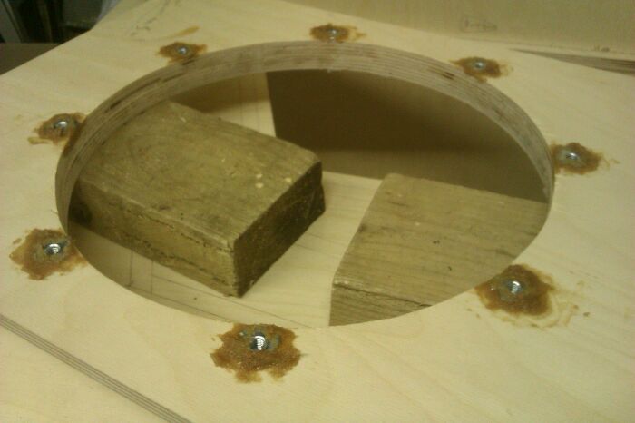

Thanks Mike. I take your point, but for me its too easy to fix, just to blob with pl and flush off when dry. Anyway, you'll like this next one, fingers crossed....
A 'stitch and glue' boat building technique used here. Mix equal parts of wood flour and fumed silica powder with epoxy to a butter/mayonnaise consistency. It's easier to build a thickness up and it not run everywhere.

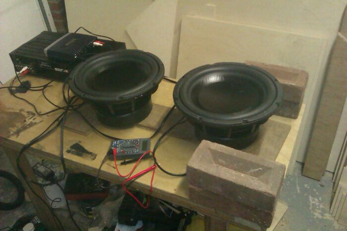

And last but not least: Bedding in, of the speaker kind. Yes, the double entendre is intentional. Aside from duties in regard to the boys, my good wife has questioned the sort of pleasure I may derive from speaker building. We've had a little chat and ive had (to have) some short amount of time off speaker building. The thoughts are never far off though - bloody hell, I've just realised I can multi task.
Incidentally, there are 'pops' every couple of minutes whilst the speakers are bedding in. Whats that then? Static build up?
2xT30
2xT30
Re: 2x 19" T30's
Its where the sine wave has a little glitch basically, or where it has been looped in a non seamless fashion (the wave ends not at 0 amplitude)

Just take the wird fumed out of the equation, if you're looking it up. I think that is the manufacturing process. Besides, I gooped up my epoxy to avoid using screws. If you've done screws, youre already belt and braces.

I did The Harley Trick on my hurricane nuts. Screwed and expoxied. They will never move. Now I just have to hope I don't strip anything when installing the drivers.

It's only no big deal for those rear mounted designs. I know you're doing an older plans build, so, for a Titan build with the latest plans, those spots require addressing to get leak free results.miked wrote: Don't waste your time patching that, as it's no big deal. The gasket will keep the air inside the baffle where it belongs. Out of the 32 driver mounting holes I drilled for my T48s, I have probably a dozen holes that look just like that.
