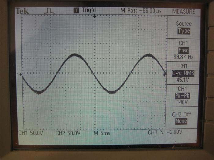

The IPR-1600 is a great amp and a perfect match for a pair of T39s. I have an IPR and have been driving a pair of 3012LF loaded T39s. That being said, it may be a bit light for driving a pair on each channel. The issue is that the IPR's maximum voltage (and wattage as a result) drops as the load increases. Below is a scope capture of the IPR driving a 4 ohm load at clipping (DDT on). Notice that the RMS voltage is only 45 volts not the full 50 volts. Still perfectly usable, but a bit short of the maximum.
Note the scope shot is from the Abletronics lab tests of the IRP-1600: http://www.abeltronics.co.uk/amptesting ... _IPR-1600#
