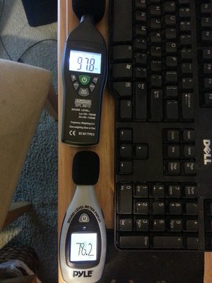

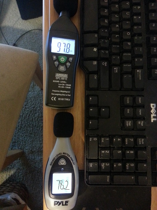

Hey everyone, so I bought the American Recording Technologies mic and I can confirm that the POS SPL meter I had was the culprit. It reads 20 dB higher (c-weight setting) than the POS at 40 Hz and 13 dB higher at 60 Hz. If anyone you know has any Pyle products tell them to give them away because their "C weighted" SPL meter was well lets just say a lot closer to A-weighted.

Example picture....
If you've read my build thread post it is the same one but for those who haven't seen it. Measurement taken at roughly 1.4 V inside in a corner at ~7 feet away. 40 Hz, so need to add 3 dB to account for the C weighting offset
