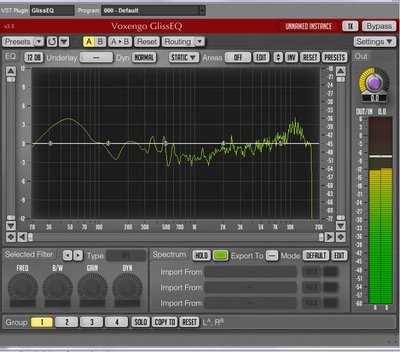

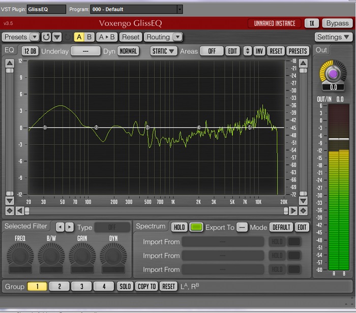

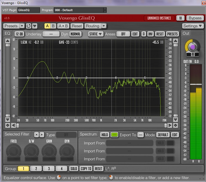

BTW here are some pics of that song someone requested be analyzed
Here I sampled one of the low "sweeps". The low end in this note you would have missed with your T39's but notice how over half (if you visually integrate aka take area under the curve) the bass energy is still above your highpass. What this sounds like is a "cleaner" or less deep sounding note but still plently loud. This second image is a picture of a typical bass hit in that song (drum) Notice how 85-90 percent of the bass energy is centered in the 40-100 Hz region. This would have sounded loud as hell and you wouldn't be missing anything Mind you I just downloaded a youtube quality version of the song so expect the highs roll off that you see but you get the big picture.
Hope this has helped someone out!
