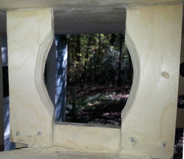

Thanks Bill! The reason I went looking for that RotoZip (took me a long time to find it, knew I had it but where?) was that I first tried to cut out the midrange baffles with a handheld jigsaw.
I am not very good with a handheld jigsaw, as I discovered. The reject midrange baffles are still on the workbench downstairs, ugly ugly ugly.
As with the hurricane nuts for the 12" drivers, without a precise guide, my handiwork leaves much to be desired. So I now try to fudge up some sort of guide for any operation requiring precision.

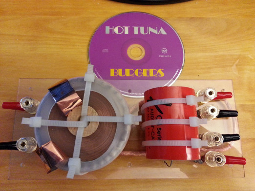

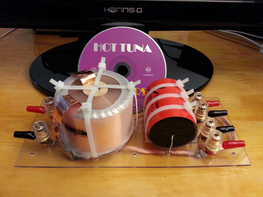

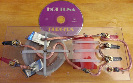

Crude but (one hopes) effective: a low-pass filter for an Omni 15 in the 2 12" (4 Ω) configuration. 12 ga. 1.1 mH foil inductor, 68 μF 400V polypropylene film capacitor. An electrolytic cap could have been used for the purpose. OCD manifests itself again. Will be mounted on rubber washers to provide space under the board.
The return to ground runs under the inductor and has curves in it, since I cut it too long and was in too much of a hurry to trim it. Never enough time. Looking at it this morning, I have to ask, is that going to cause a problem? Can always re-route it.
CD included for scale.

aeolos wrote:Crude but (one hopes) effective: a low-pass filter for an Omni 15 in the 2 12" (4 Ω) configuration. 12 ga. 1.1 mH foil inductor, 68 μF 400V polypropylene film capacitor. An electrolytic cap could have been used for the purpose. OCD manifests itself again. Will be mounted on rubber washers to provide space under the board.
Thanks
--aeolos
:shock: Holy overbuilt crossover, Batman! I've seen something like that mounted on transmission towers for capturing lightning strikes! :D I don't have the Omni plans; I am assuming your component values are correct? If so, no harm at all in overbuilding. I am of the overkill mindset myself. Build it mil-spec/bulletproof one time and never worry about it again.
aeolos
Posts: 72
Joined: Sat Jul 13, 2013 9:36 am
Location: Atlanta GA USA
Re: 1st BFM build: 2 X Omni 15 TallBoy in 2-12 configuration
#29 Post by aeolos »
Yessir, it's a good big 'ern all right. The 1.1 mH inductor is of the plan-specified value, but the cap is 68 μF where the plans say 66. But the plans also allow for 10% tolerance, so it's close enough I guess.
I like designs with headroom, but this one doesn't really have any: that inductor is specified to handle 650 watts RMS, while the 3012LF low frequency drivers are specified to handle 450 watts each. Just looking at them, 450 watts seems to be a little on the high side, or maybe there is an unstated time limit, or something. They are very nice drivers though, can't wait to hear them in action.
The planned application for these cabs is PA for a single performer on guitars, keyboards, and vocals, in very small venues, or reproduction of recorded music in those same venues, so it's hard to imagine running them at even as much as 300 watts RMS in normal use and service. My own rating for one of these cabs will be 300 watts continuous 20 Hz - 20 KHz pink noise, of course at nominal 4 Ω, for 1 hour, if testing shows they can handle it.
That inductor is so big because it's an air- (well, hardwood-) core design. Weighs quite a bit, almost all of the mass being copper. One hopes it will not saturate or generate distortion at the rated power level. The cap is rated at 400 volts, so perhaps that is why it is so big. Plenty of headroom where the cap is concerned :).
You are right: build it to withstand unforeseen use/abuse conditions, and gain peace of mind thereby.

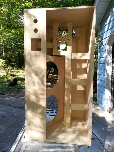

Here's one of the cabs with the interior bracing (but not the back flanges) in place--another mistake on my part, the vertical brace should have been offset 1 inch to the right in this view, but fortunately the drivers still fit, barely:

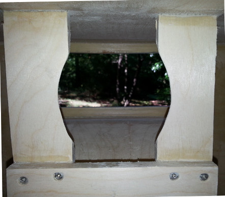

The braces at the top of the midrange horn need a little shaping to allow the use of a Selenium 220Ti driver and HC23-25 horn, here's the view from the front--the driver does not touch the braces, so no buzzing from this source anyway:
And here's the view from the back:

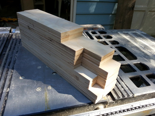

Here are the 20 pieces of the back flanges, soon to be installed:
