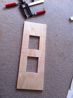

Plans state one hole in panel 5 is OK if a single 12" driver, but I thought splitting it into two holes might help with strength in the middle of the panel? I'm assuming this is ok...

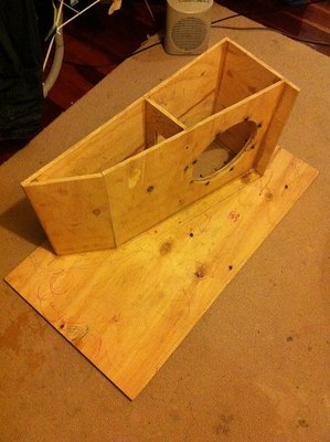

Panel 5 in.. not perfect but I'm happy with it so far. Panel 4 is 'slightly' too short, I cut it on the wrong side of the marked line! lol. I'm assuming that PL will fill the gap when I put the final side on? its only about 1/16" too small. I could always glue another small 1/16 strip on there if need be, any comments/suggestions welcome on that one.

I would cut a strip to insert and also have an outer piece between the intersecting panels.fester wrote:Panel 4 is 'slightly' too short...I'm assuming that PL will fill the gap when I put the final side on?

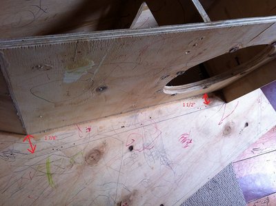

arg, seems this build has got the better of me! I have checked and re-checked and re-measured multiple times... I simply don't see how the panel 6/3 brace can be 2" wide as the largest point on mine is only 1 7/8" wide.
I have attached a pic showing my predicament, plans state a brace of 2" - 1 7/8" brace but simply will not fit in the space, measured it 6 times.

Do you happen to have one of your layout lines placed incorrectly? It happens all of the time to a lot of us.
This is why I do a dry build on my cabs before I PL anything up.

1/8" out in measurment isn't the end of the world huh. IIRC that amount is acceptable (as an outer limit) of variation in measurement.
Certainly not enough to go starting over again.
Just trim your brace accordingly I reckon...
Re: T45 the baby T60 is born :)
Yeah I can trace back a slightly out measurement, but only one, and its only 1/8 at most, so I'm just going to keep going, hopefully then next build will be more precise... with a very limited tool set I can't expect perfection.

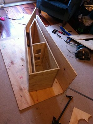

progress is slow.. but getting there! panel 8 in, now for more braces...
I haven't got the plans, so am wondering why there are holes in the front (i.e. toward the front of the cab) of the driver chanber... looks like you might have a bit of a leak there!fester wrote:progress is slow.. but getting there! panel 8 in, now for more braces...
