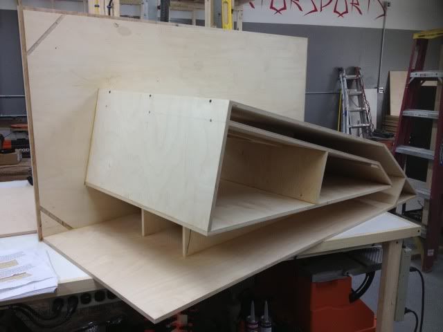

You guys are more than welcome.. please come I'll have a table put aside for you..
I've actually had to work the last few days so not much got done accept this.

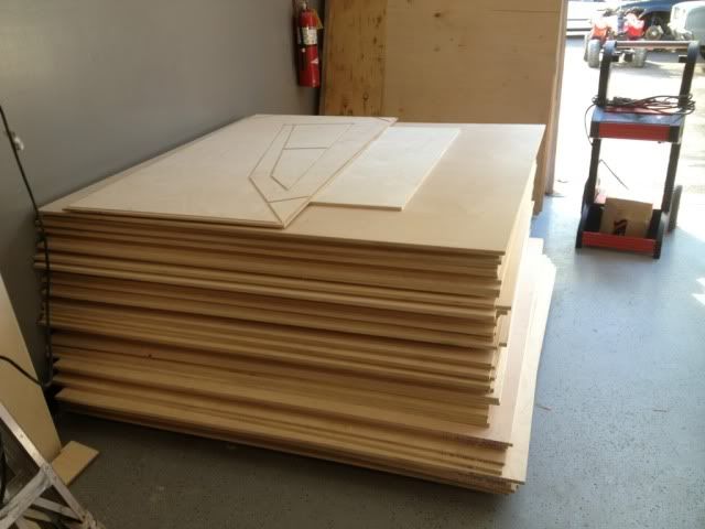

and more wood showed up!! I cleaned my local supplier out!
Tomrw I'll have it finished up and I'll start the assembly line process.

#27 Post by miked »
Wow, that looks totally Professional-Grade! Looks like you're using screws for the entire assembly? Was this a dry-fit? I don't see any PL. Unless you're that good....I already know I'm "that sloppy" and if this was my build you'd see the PL from 45 feet away. :loler:

#28 Post by hifibob »
miked wrote:Wow, that looks totally Professional-Grade! Looks like you're using screws for the entire assembly? Was this a dry-fit? I don't see any PL. Unless you're that good....I already know I'm "that sloppy" and if this was my build you'd see the PL from 45 feet away. :loler:
Thanks Mike.. Good eye, I kinda figured I would be questioned on that lol.. My saws are extremely dialed in to near perfection :D I really took my time getting the cuts on the money since I used this build to make all the jigs to whip these babies out fast and efficiently.. I've never used PL for woodworking but that stuff is messy as hell.. I made a a few test dados just to see how well the Pl works, and that even made a mess.. but I can see why its so popular it will def hide some not so perfect cuts!

#29 Post by miked »
If you were closer, I'd ask you to come dial in my table saw. I can't tell you how many hours I've spent trying to get the fence perfect; I've lost count. Roughly 75% of the time a cut of any length is dead-straight and even. Sometimes, I'll have a 1/16" difference on say, a board about 3 feet long b/t one end and the other. That margin of error and the "I don't know if the fence is perfect this time" frustrates me to no end. I wax my table and my fence rail, keep sawdust off both so it doesn't interfere with movement, etc. I'm OCD and I know it. :fruit: Possibly, I am to blame...maybe I feed the board a bit crooked? I set up my fence with a digital micrometer for cryin' out loud! But I digress.
No doubt you've got woodworking skills like Bill Gates has hundred dollar bills, but you must use PL when assembling all your cabs! It's messy as hell, sticks to everything like gorilla snot, does not compress easily (typically have to clamp a panel down before nailing/screwing b/c the goop is thick) and is generally a PITA to work with. But it dries like concrete, seals any gap up to about 1/4" (IME) and is just all that and a bag of chips. I've found that the 100-pack of "Nitrile Gloves" from Harbor Freight ($3.99 with coupon) is my best friend when using PL.
The only thing that matters is that the cabs are air-tight; with your skills and PL, you've got a 99.99% chance of that happening. And with just your skills it's only 99.05%. :slap: I'm so jealous. LOL!
