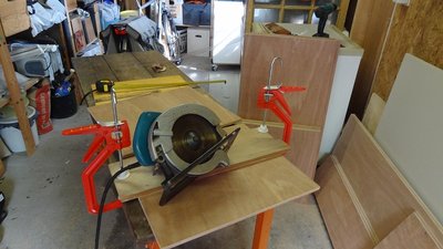

On another thread I saw that the MINIMUM tools for a build was:
A circular saw, a straight edge (or sled) to guide your circular saw, a jig saw, a drill, and a sander is the minimum list. If you use screws, no clamps will be required.
By circular saw, do you mean one of these:
or a table saw please?

The saw you show seems to be a mitre saw.
This is the circular saw i use. <15 year old Makita.

Yeah, I was thinking that the one that I posted a pic of wouldn't have enough 'cut', 'throw' or whatever to cut the length/width of a lot of the panels (I've have got one of those saws in the garage). May have to get one of those hand held ones. Can you vary the angle of the cut right or left on those (if looking at the saw from behind)?Bas Gooiker wrote:The saw you show seems to be a mitre saw.
Re: New Build - T30s and then Otops to follow
escapemcp wrote:Yeah, I was thinking that the one that I posted a pic of wouldn't have enough 'cut', 'throw' or whatever to cut the length/width of a lot of the panels (I've have got one of those saws in the garage). May (sorry, WILL) have to get one of those hand held ones. Can you vary the angle of the cut right or left on those (if looking at the saw from behind)?Bas Gooiker wrote:The saw you show seems to be a mitre saw.
