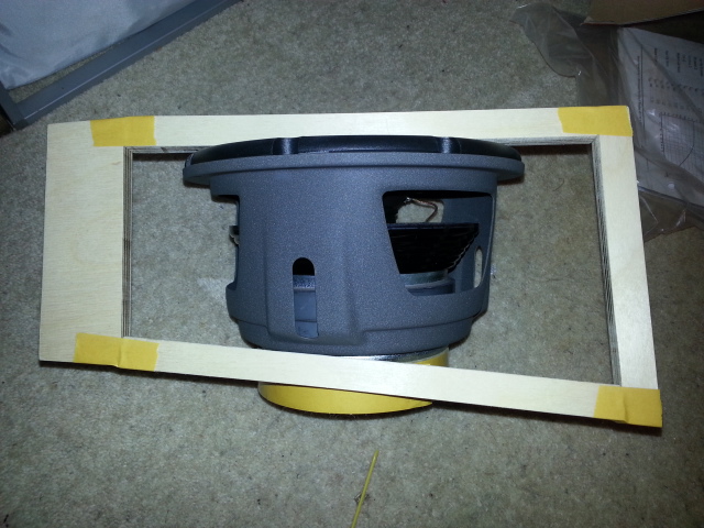

I have also cut out the flanges for the access cover.
I'm planning on fitting these once panel 2, 3 and 4 are attached rather than at the end of the build as there will be a bit more room etc. Is there any reason to wait until the end to fit these?

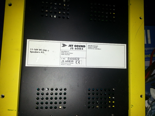

I took the amp off the parcel shelf and happy days it had a label on it :D
Looks like the output is rated for 4 ohms.
ryan222h wrote:If its rated 4 ohms per channel then maybe stick with the one channel to the AT.
Pretty self explanatory, I will be running it of just the one channel for now to be safe.

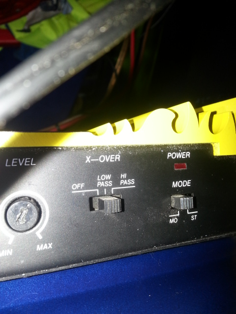

I also had a fiddle with the level dial.
Played a 100hz sine through it at about HU volume 9/10 and turned the dial.
At the min setting the voltmeter read 0.1v.
At the max it read 3.4V.
I'm still not convinced what this means. I was thinking it must be a 'gain' type dial but am I right in thinking it could be a variable X-over that is setting the cutoff lower than 100hz thus reducing the voltage? Surely if this was a gain dial then even at the minimum setting there would still be some output not 0.1v?

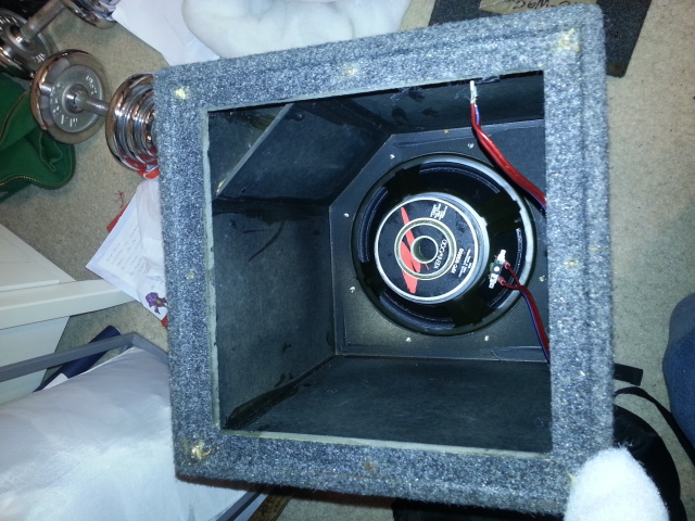

Finally some photos of inside my current sub and some comparison photos against a card mock up of the AT.
The driver in the old sub is old Kenwood KFC-W2500. Specs below (stolen from http://www.diyaudio.com/forums/subwoofe ... at-do.html).
10" woofer; Kenwood KFC-W2500, Peak Power 360W.

njolliffe wrote:I also had a fiddle with the level dial.
That level dial is most certainly a gain dial. The amplifier would be near useless without it. It is used to match the output of the headunit to the input of the amp.
If you want to find out at what freqency the amplifier is crossing over at play ~40hz signal thru the amplifier with the low-pass engaged and turn up/down the level until you read 10v at the outputs. Now raise the frequency without altering the levels until the voltmeter reads ~7.01v . The frequency that causes the voltage to drop to that level is where you are -3dB down or about the crossover frequency.

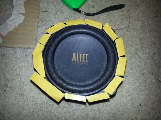

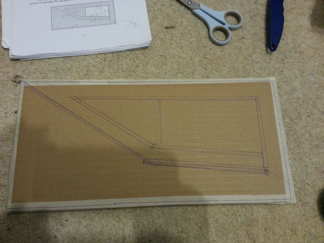

So yeah, with that said, may I present the build of a mini 2.1 AT, 8" ext width.
I have an Altec lansing VS2621 2.1 system for my PC. It has a 4" sub for the bass which is half the size of the recommended 8" driver. I figure half everything and all will be gravy right? :D

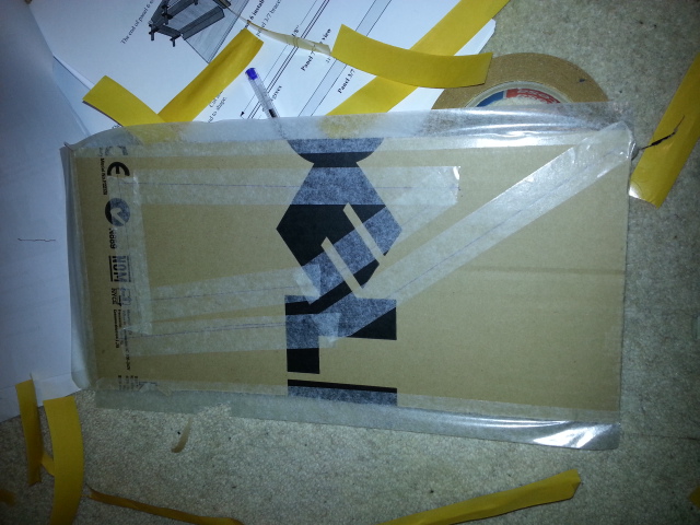

I used a high quality double walled cardboard which has a higher rigidity than the single walled. Note the cheaper stuff has a far lower level of stiffness and therefore your cab is more susceptible to panel flex.
Also you need to use a quality craft knife to cut out the panels. Scissors crush the card and negate the stiffening properties offered by the corrugation.

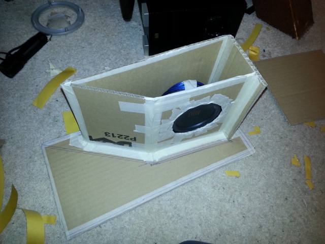

Marking up Side 1.

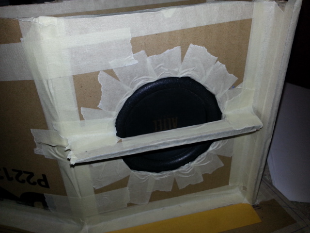

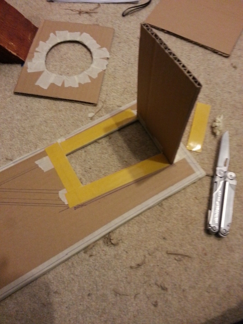

Pan 1 attached. Access cover cut out.

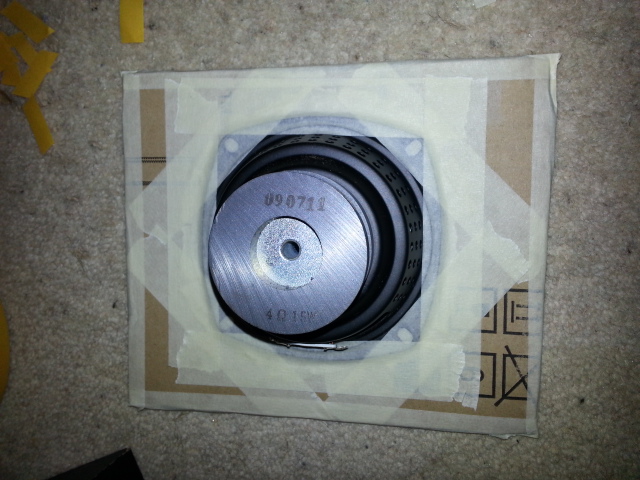

Tee Nuts are not an option for Cardboard so I used some double sided tape to mount the driver. Note, I used a 'pinch' technique to produce the 45deg angle on the baffle to ensure cone clearance. This was obviously confirmed with a test signal run through the sub.
A seal was ensured by applying masking tape generously.
Photos and build continues in next post.

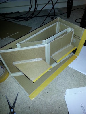

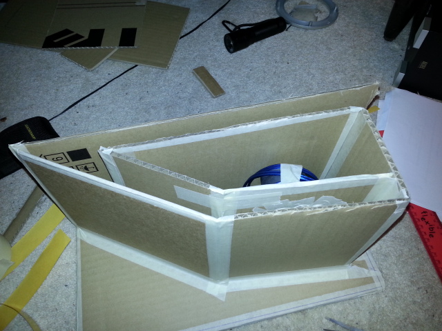

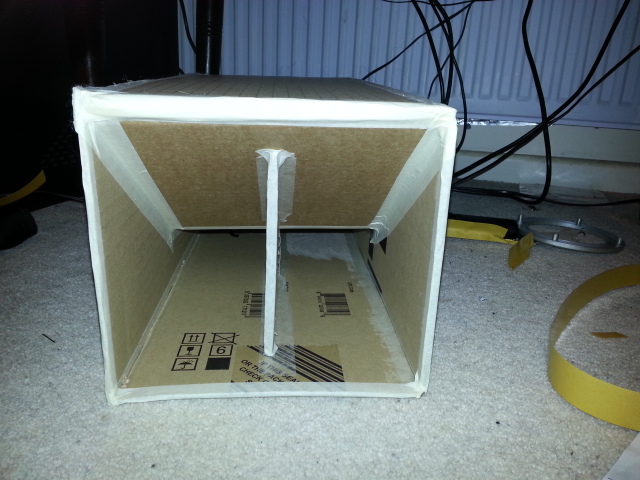

Mini AT 9" Continued.

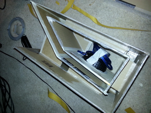

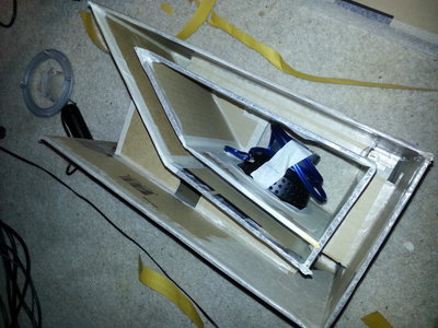

Panels 2, 3 and 4 fixed in place.
Note the masking tape used to help improve the seal between panels. Also a stronger joint is achieved by taping each edge of a panel before fitting.
First brace going in. In hindsight I should have used 2 braces to further reduce panel flex.
Panels 5,6,7 attached.
Panel 8 and the two remaining braces attached.
Final panel attached awaiting the side.
Continued next post...

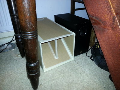

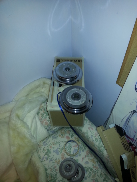

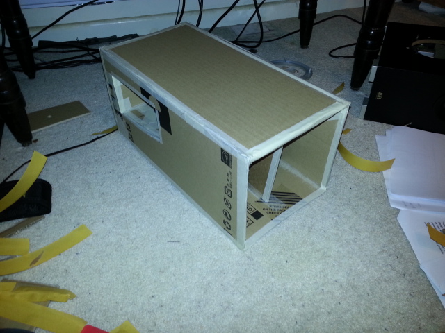

Final side taped up. Used double sided on the panels and the side to ensure a good 'stick'/seal.
Last side attached.
Front view
I have attached the access cover, you can just see it in the last photo.

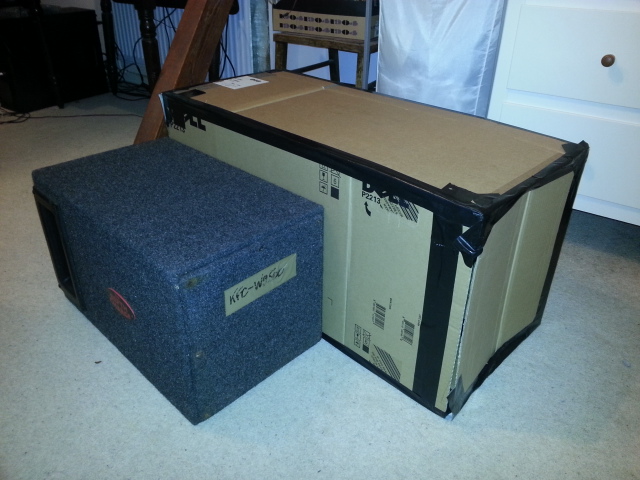

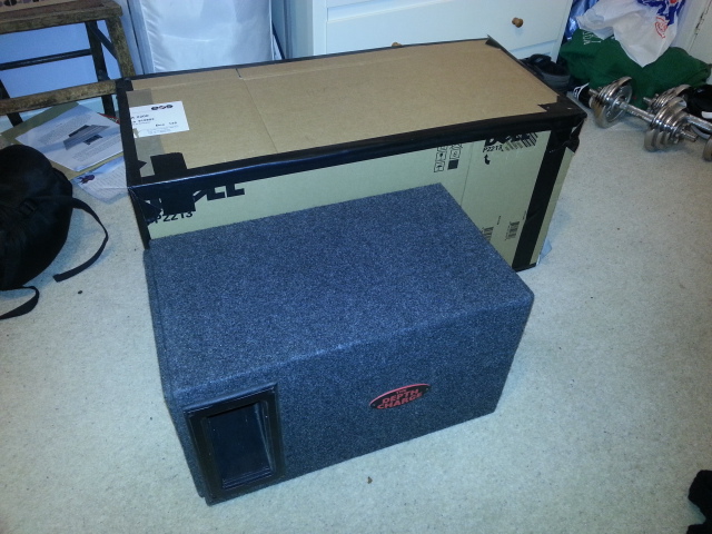

View next to old sub.
I did the old 'crawl' method and decided best place for it was corner loaded sat on my seat behind my desk. The weights are to try and improve the seal between the side and internal panels.
So there you go, finished at least one AT Haha lol.
Was a good few hours work and in fairness it doesn't actually sound too bad. At low/medium volumes it copes quite well. At higher volumes the card can't take the pressure and flexes lots. You can hear this hurts the sub and it makes a similar distorted noise to when its in the intended enclosure supplied with the speakers. The cabinet also vibrates lots and those weights were all thrown off it during one bass heavy scene during a film. I expect that it will sound worse and worse as time goes by and the tape peels/fails so I will have to put it back in its proper enclosure before too long.
I was hoping to post a video but my phone mic is crap.
Overall I am pretty impressed with the performance, considering its made from card. Its certainly got my expectations up for the actual AT and I'm itching to crack on with it.
