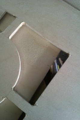

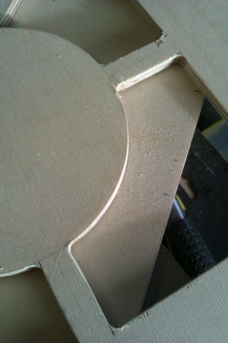

On the other hand, maternity leave has given opportunity for progress. I have cut out most of big pieces and started on the detailed cutting required.
I decided not to route out the baffle, for sake of time. It's not turned out too bad, but I should have left the drill holes back from the corners a little (a couple of pics below). I'm intending filling the corners and reshaping nearer the time for painting/finishing, but again, I don't think anyone's going to be looking that closely in my throat, when there's plenty on offer to look at on the outside.

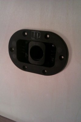

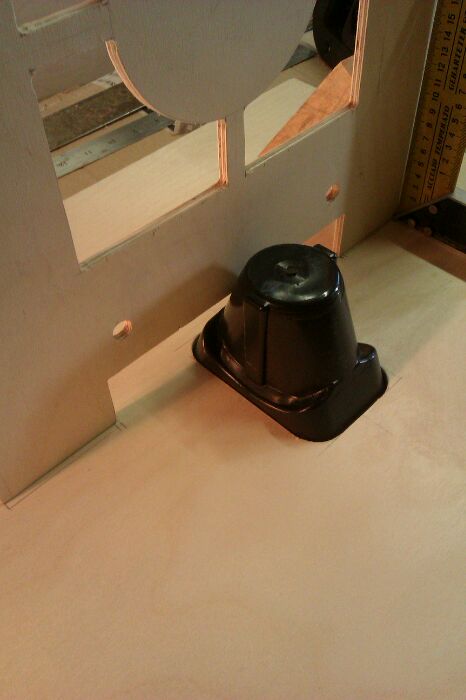

Using the tilting top hats requires a little bit of relief on the front side of the baffle to allow the baffle to sit where it needs. I thought about recessing the top hat, but with the wood only being 6mm thick (jack lites), it would require another plate gluing on the inside to take the tophat fixing flange, I decided it was a faux pas, in terms of mechanical integrity. Anyone inadvertently banging the cab down onto a pole top might break the inside support piece out.
