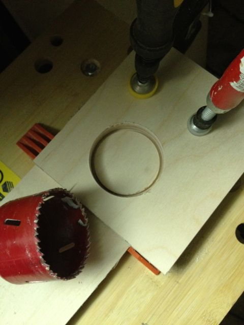

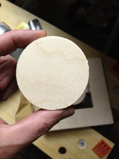

Making the phase plug

rainbass wrote:Maybe you should use a piece of scrap wood when fastening, before piercing that kind of holes. You will avoid marks.
I only needed the plug, the rest of the plywood is scrap, so any marks don't matter

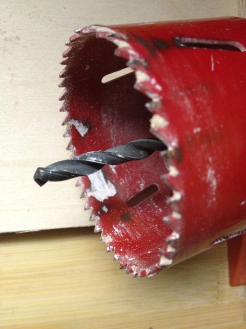

I used this to make a guidehole
and without the center drill to cut the phase plug

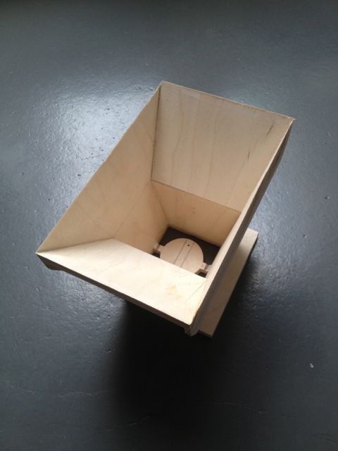

The mid horn took a while...
Phase plug
Phase plug
Almost ready to be mounted

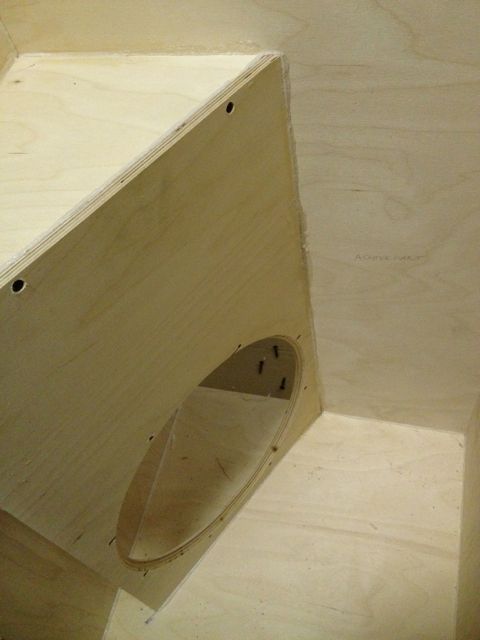

The phase plug in the baffle panel is slightly larger (about 1/16") than the one glued on it, which has the correct size. Should I correct that or is there nothing to worry about?

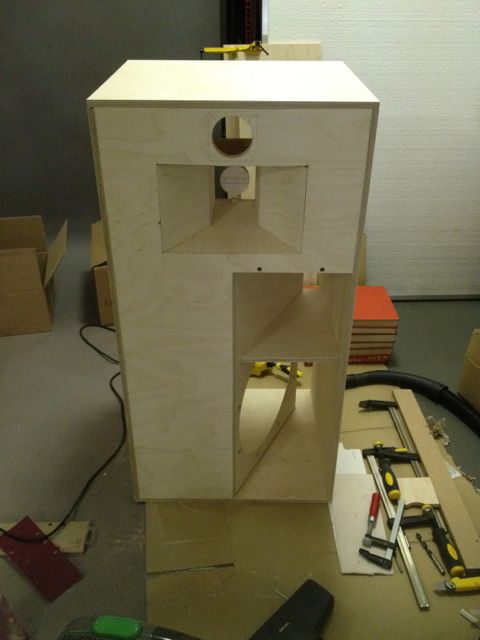

#29 Post by Rickyvt »
Dry fitting. It's a very, very tight fit. Don't think I need glue :)
I will have to do some sanding before glueing it
