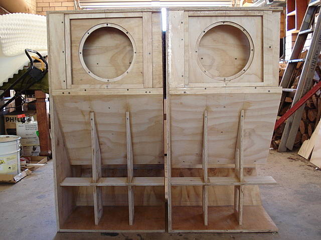

In-between work and the farm I've spent a few hours cutting up all the blanks for the 2 new cabs and ordered drivers.
Started cutting the roughs down to true size, panels 2 and three only.
Man this seems a breeze after working on my DR250 build.
Best be shutting my mouth lol, build hasn't actually commenced yet...
Re: Another Australian T39 build
IIRC my last 2 T39's cabs seemed to take forever and did. I built one at a time
This time I cut everything up and built the new 2 side by side.
After 11 hours on each cab since the first pencil line cutting up all the blanks, I'm up to here:
Only wire to put in from the chamber before I put the final side on, then the other panel 7 and these cabs are done...

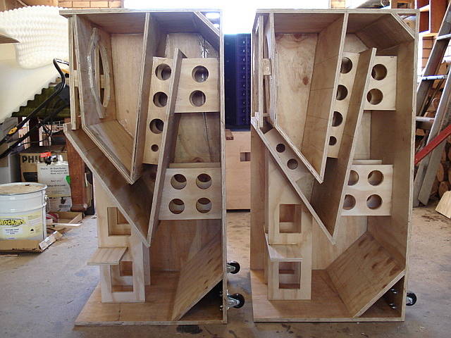

Right,
Both sides are on. Slight hiccup, one side I had initially cut was out by enough to pull the bottom panel into a bow if pulled up with clamps. 1/8" makes a difference sometimes. I cut up a new side and all problems solved. For whatever reason, side by side they look no different!
All edges trimmed and routed.
And all holes are bondo'ed/bogged/filled/whatever and sanded.
So I'm up to 12 hours per cab.
I'll burn in the drivers tomorrow. Other than painting and corners, these baby's are done...

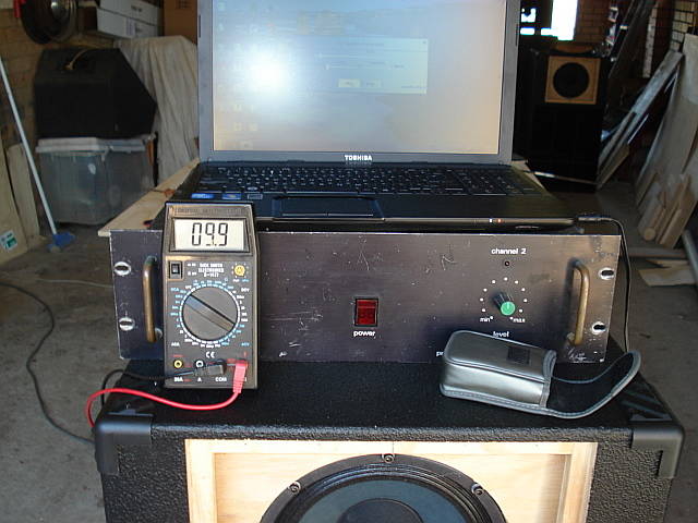

Drivers run in today for just over 12 hours; 30Hz @ 9.66V.

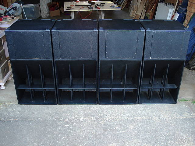

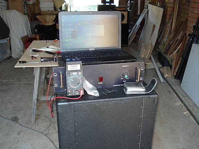

All painting done, corners on, NL4 plugs inserted.
So, time to leak test:
The amp is an Aussie made "Audio Design" brand (Brisbane, now defunct). Not high in power but perfect for breaking drivers in and leak testing.
First cab (which is actually T39 no 3) passed leak test so:
Access cover on Cab 4 failed the leak test at 12 o'clock.
Driver removed, hot melt glue in the deficit (which I didn't see for looking)
Passed leak test, access cover on.
Cabs 3 and 4 done.
Add 1 & 2 and you get: Essentially, as cabs, these guys are done and dusted.
Told you the little buggers multiply!
Be damned, I can't believe the lil fellas all line up height wise
BTW, cabs 3 and 4 are on the left, cab 3 most left...
Cabs 3 and 4 done.
