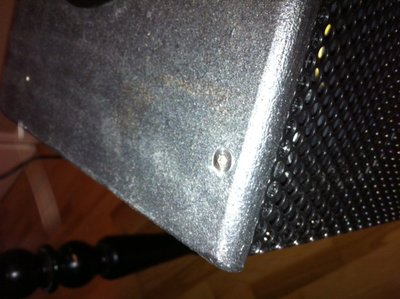

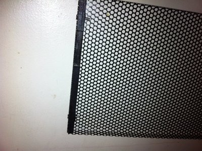

#20 Post by DanielNY »
There are two cleats (3/4" x 1/2" x 10-3/4"), one at the top and one at the bottom. The grill is bent 3/4" on all sides so the bolts go through the cabinet edge, through the grill, through the cleat and right into the t-nut. I didn't want anything on the face to keep that clean look. All the pieces are black so it blends right in although the picture I posted didn't have them installed since I wanted to show a picture with the grill off.

djlivex wrote:...can you post the pics on how it is mounted
The grill was mounted with t-nuts/bolts, I will post pictures below. Standby

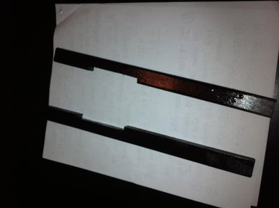

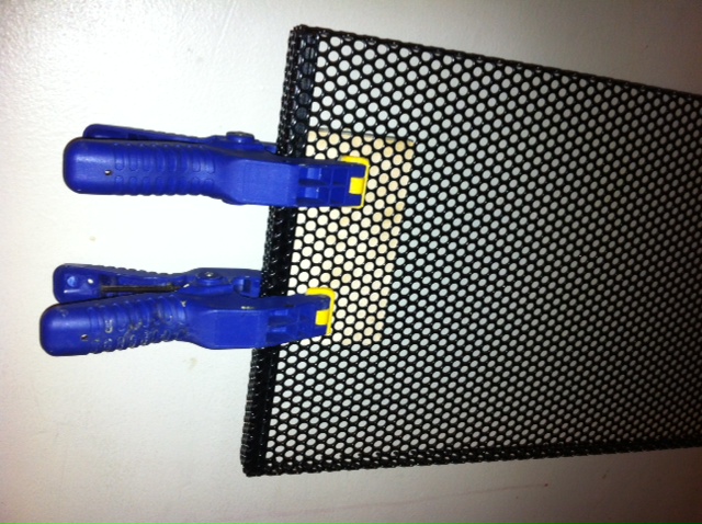

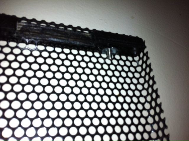

Excuse the pics, not very sharp.
So I made some wood cleats and notched where the alpha6 needs to clear, and painted black. Then I attached them to the grill with epoxy (the pic with the clamps is holding the cleat in place while the epoxy cures). Then I drilled through matching sets of holes in the grill to add the t-nuts with some more epoxy to secure the nuts.
Then I aligned the grill to the upper and lower lip to drill holes for the bolt to pass through. After adding the grill I decided to install a support bracket for the grill right between the middle woofers. Will take a pic and post later tonight.
Hope this helps.

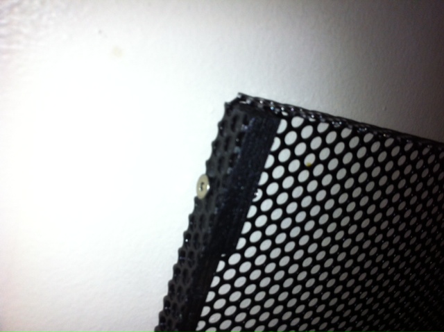

Here is the final picture of the bolt that goes through the top and bolts into the t-nut/cleat behind the grill.
