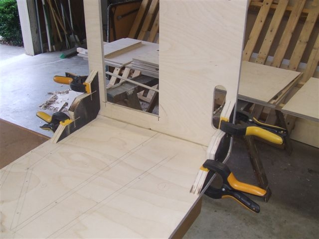

Fastskiguy wrote:Let me ask a quick question....how did you get that first joint fastened lined up right and without getting glue all over the place?
Use the W braces. Hang it off the table a couple of inches and screw from the bottom.

Oh yeah, I get it now! Thanks guys!

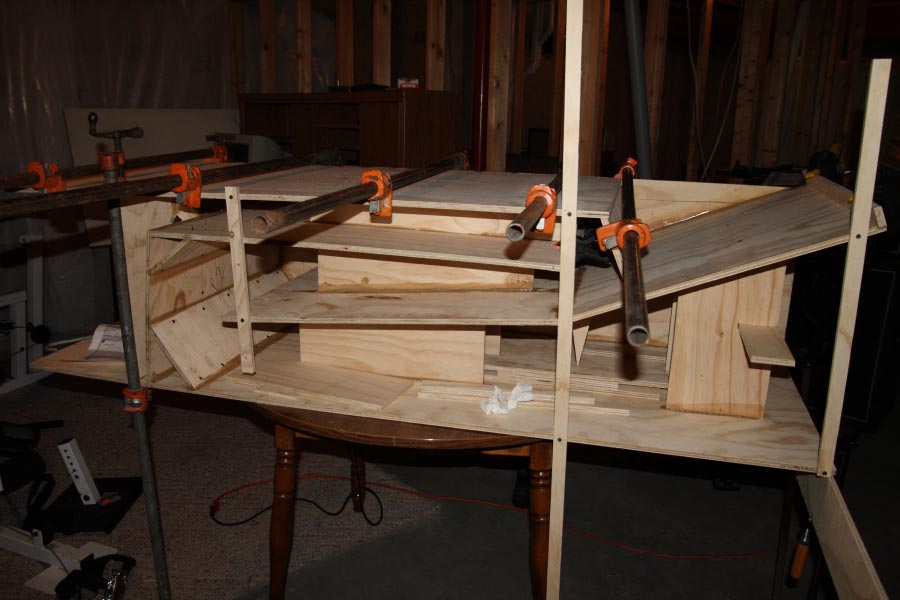

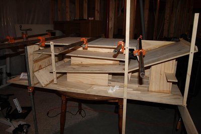

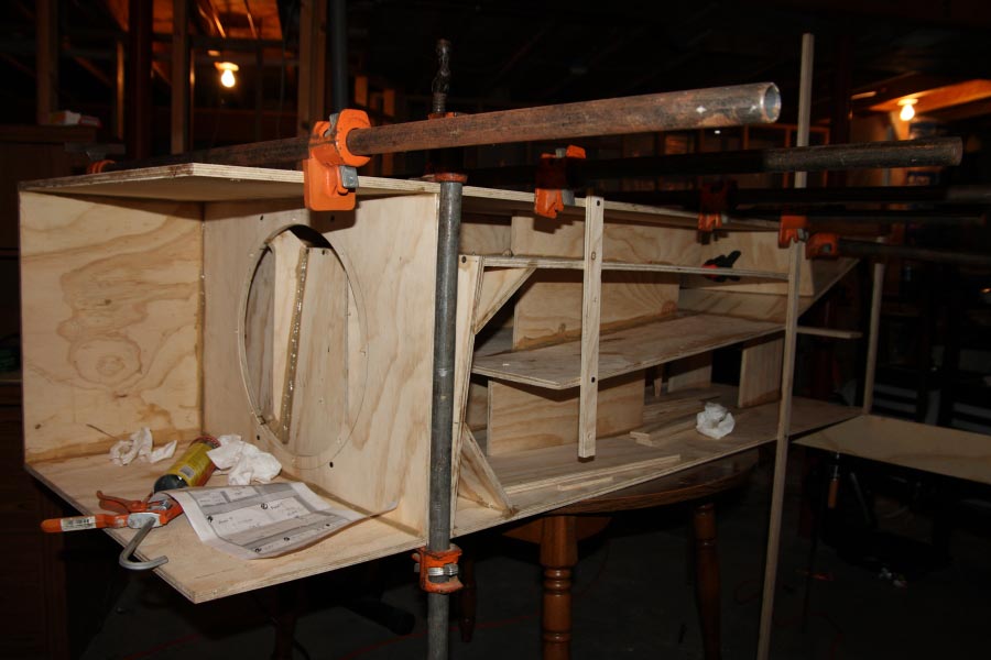

More progress.
