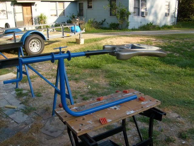

AFA a jig for painting cabs goes, something like this might work. This one's for a guitar, but you get the idea.
You could even somehow motorize the handle and have it spin very slowly. Just an idea.

<picture of painting jig>
The problem I have not solved is how to attach the jig securely to the cab without covering any surface that I want sprayed. For a heavy cab like a Titan, it probably needs to be attached at more than one point to reduce the leverage. Also, a jig sturdy enough to handle a Titan would be pretty big. For production work, that would be a good investment, but it never seemed worthwhile for my limited needs. Instead, I suspend them from an eye bolt in one of the screw holes for the handles or from the Speakon jack inlet hole.
