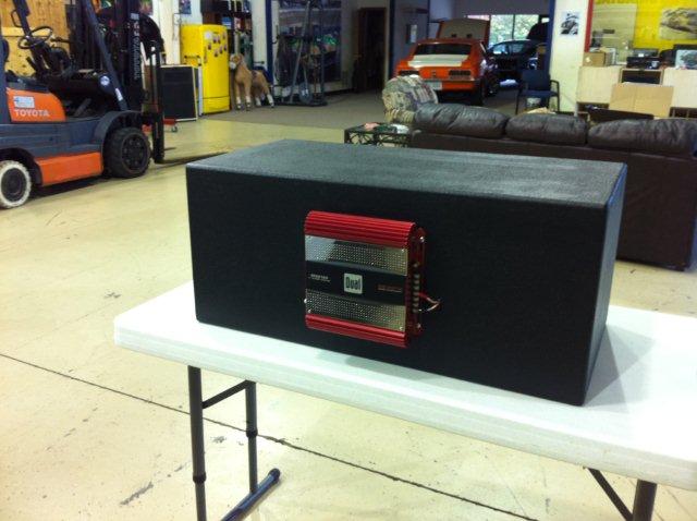

We will be installing the system in a 1994 Olds Cutlass this Thursday. I will give you a review then. The other components are a 50w X 4 Pioneer with Bluetooth, 2 - 4" Boston front dash speakers with bass blockers (300)Hz, and rear 3 way 6X9's. I am running the speakers from the head unit to save money.
The AT is in the trunk of the car not wired in yet. It looks beautiful. I used Duratex finish, and mounted a $64 Dual XPA2100 (bridged to 150 Watts 4 ohm) centered to the side. It looks like it was designed by GM for the car. Perfect fit and size.
Including the amp ($64) and about $5 of wire, $2 screws, $9 of Duratex, shipping and the previously mentioned building costs, I spent a total of about $200, and I have a complete sub enclosure and amp ready to drop in a trunk, and will compete with any entry level dual 10" or single 12" commercial sub and amp, which would cost more like $600 with sub and amp, and it weight at least 20 lbs less.

Here are a few pics of my AT build. I will install tommorrow. Larger pics at:

very sharp!

Looks great!

Looking good indeed
Have you fired it up yet? I'm sure I could not wait until it sat in the car.

Exactly the amplifier I have driving an AT. You will be very happy.
Nice cab.

Thanks for the compliments! Haven't fired it up in the car. It is a system I am putting in for a young man I am mentoring. Tomorrow, his big brother is going to help me do the install. Hen will be presented his "pimped ride" next weekend.

I installed the sub, and it sounds GREAT!
Here is the setup:
94 Cutlass Supreme
Autotuba - $75
8" driver - $52
Dual amp $64
Tuner - new Pioneer 50wpc w/bluetooth and remote control flea market $80
Streetwires 8 guage $28
Streetwires fuse holder $10
AGU 25A fuse $1.29
Fronts 4" Boston Acoustics with 300hz bass blockers $80+$10
Rears 6"X9" Boston Acoustics $70
Used stock wiring with Crutchfield speaker harnesses free
Gold plated spades for amp $10
Misc shipping about $30
This system rivals the $2,400 Pioneer/JL dual amp system I put in my son's car for graduation!
The total cost of the system $510.29!
