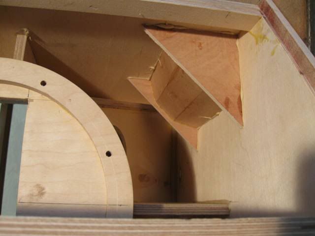

Here an example of the Montage Kit used to glue a handle pocket and horn braces:
