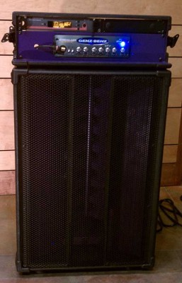

I played 2 very different gigs this weekend. Friday I played with a funk band in a medium sized club. There was a soundman and a large house sound system. Saturday I played a large wedding (300+) in a tent. So far I have nothing but good things to say about the Jack. It cuts through and sit well in a mix. It gets stupid loud! I really like the low end on this cab. It's very clean and not at all muddy. For finger style stuff I am really liking the piezos off but I'm glad I added them for slap stuff. I wish I had the piezos wired up to some kind of foot switch so I could turn them on or off faster. Any Ideas?
My keyboard player now wants me to build him a Jack. I'm thinking a 1x12 would be good.
Here is a picture with my SL600 and wireless mounted in my matching rack.

That looks great.Im currently looking into some Jacks.Im probably going 2x112,but that 210 has me thinking.we are pretty loud-Id worry if a 210 would be enough.

Beautiful cab, man.

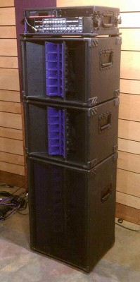

Finished my single Jack 10s and I am digging them. For bass, playing through a single Jack has a more noticeable mid bump. I like a lot of mids so I actually like the sound of one cab. Even a single cab gets really loud. It could easily keep up with my band. With 2 cabs or a 210 the sound is more balanced and full sounding. I kinda wish I had built 2 jack 10s instead of a Jack 210 for my bass rig. My single Jack 10s are going to be used as a PA with my newly finished T39s. I will eventually be replacing them with DR200's when I can get around to building them.
Here is a picture of my super stack.
(not really going to use it this way but it looks cool 8) )

Nice! You have inspired me to change my sig. :)
Once you go Jack, you never go back!

That does look cool, and you should totally use it after you build your DRs for your PA!
