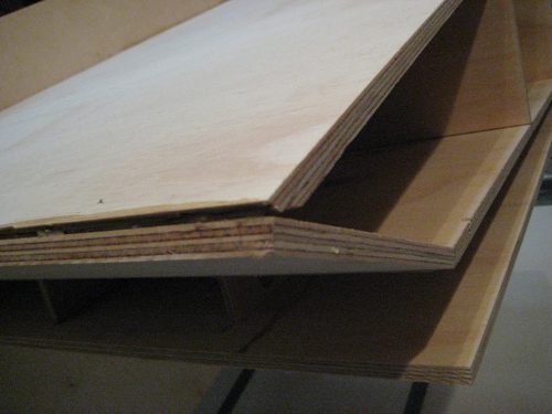

Also my jacks are in the way of putting a handle by the casters. I spaced them out too much. I should have had the handles on hand before making the holes for the jacks. :?

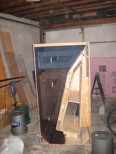

Well here are some pics... more to come

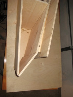

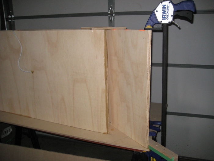

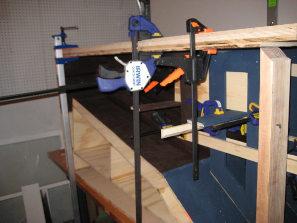

Not sure why this pic loaded twice

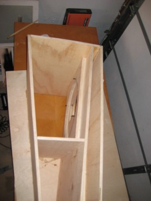

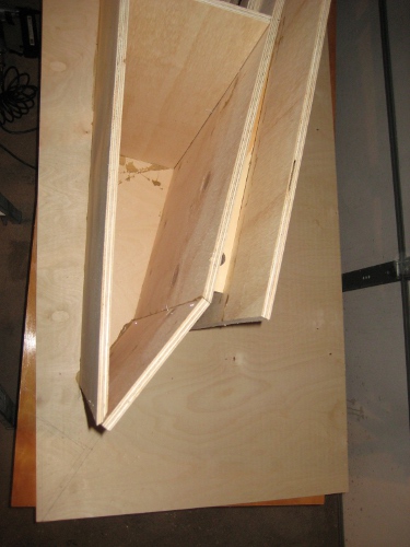

Looking down the mouth and throat. Say Ahhhhhhh
The empty abyss. I think I will leave this be even when done.

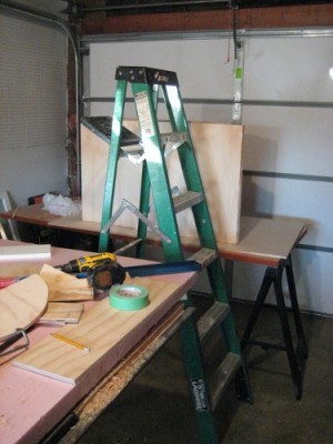

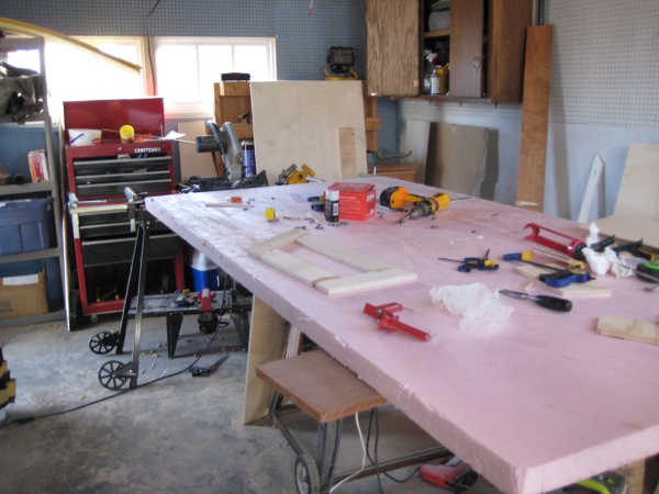

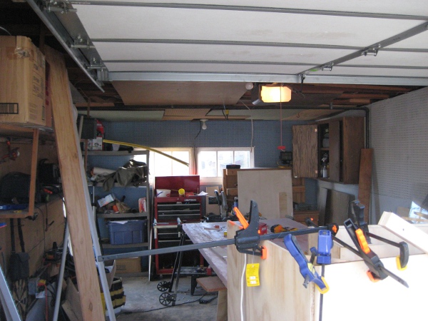

I had to setup a ladder to get some of the other shots. This is my work area.

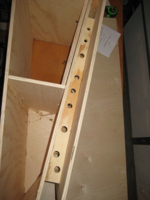

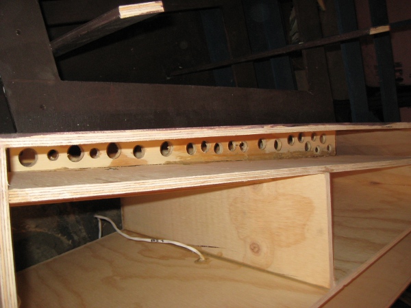

Woops, I think I see a mistake. May be nothing but the plans only call for one horn brace (brace 2/6) to be centered on the driver hole. This is only for single loaded cabs, where dual loaded get two braces, one centered on each driver hole.
subharmonic
Posts: 2061
Location: Mandan ND
Re: My 3rd BFM horn.... the T60
#20 Post by subharmonic »
DanielNY wrote:Woops, I think I see a mistake. May be nothing but the plans only call for one horn brace (brace 2/6) to be centered on the driver hole. This is only for single loaded cabs, where dual loaded get two braces, one centered on each driver hole.
:shock:
CRAP!!!!!! I just confirmed that on sketchup and in the plans. Missed that one. Well not much I can do about it now, I think cutting the braces out is not worth the issues that it will cause, they are bradded in place too.
Thinking about it the only reason I can think of is air movement. Structural integrity I can't see being the reason as 2 is better than one. Hopefully my drilled holes are enough for the movement. I may add some more before I put the side on it.

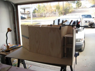

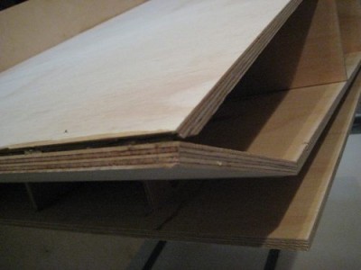

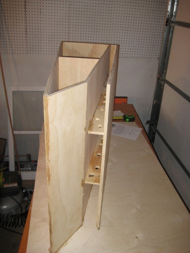

More build pics and work area pics

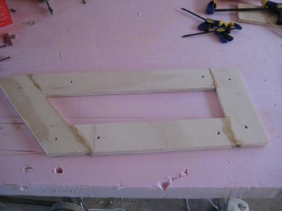

Made my braces too big, or put them in too tight. Should have used a square and guideboard
My gorgeous work area
This insulation foam has been used for everything on this build. I just pushed the braces together tightly and drove long screws through them.
Another pic of the freebie workbench with sacrificial top

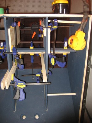

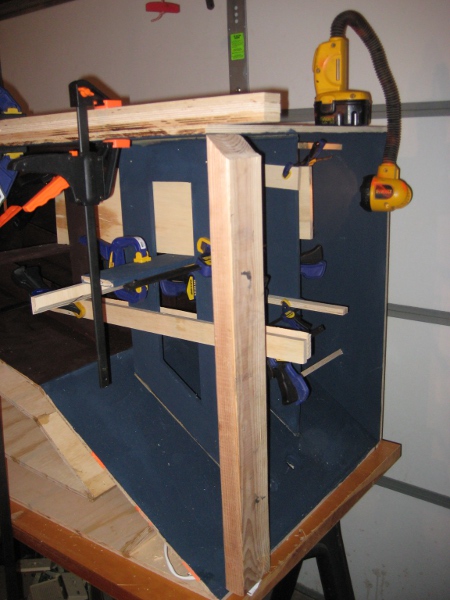

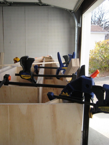

Just a bunch of mouth bracing pics

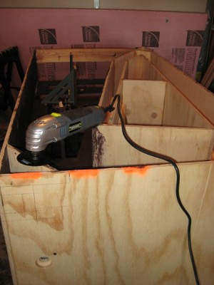

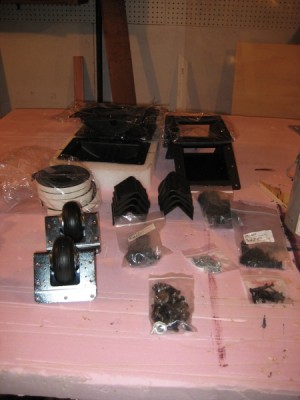

LeLand at Speakerhardware.com FTW

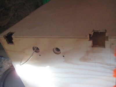

This burned the wood more than I thought it would but no biggy, less duratex
Holes cut for casters.

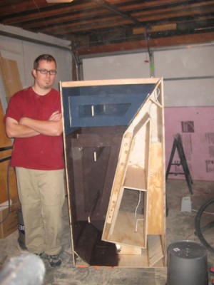

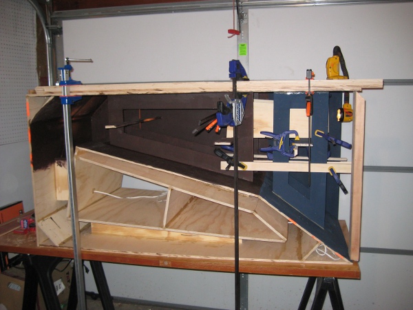

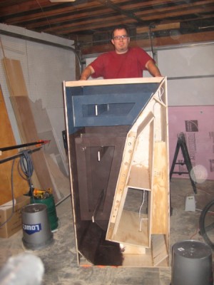

So here should be the last pics prior to closing The Ark up.
The wood at the top of the mouth is a 29" 2x4 I had laying around. It was the key to squaring it up last night during my mock up clamping session

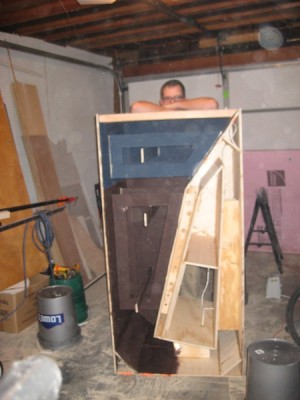

Reality check on size.
Luckily I can still man handle it myself without handles build in yet so it is not too large for me @ 5'10" 220lbs.

subharmonic wrote: Holes cut for casters.
Are those your speakon inputs on the bottom of the cab? I would reconsider putting them in the front mouth so that you can utilize one of the placement options for a Tuba 60: Bottom down, mouth face up into a corner (stood upright in other words).
EDIT: Looking at your other pics looks like you have put inputs in the mouth as well. Good call if so.

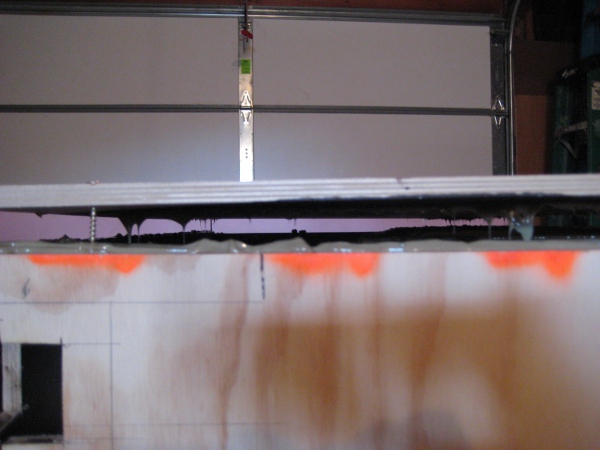

Day 10

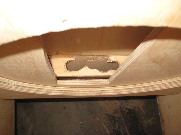

Put the top on, of course didn't go as smoothly once PL was in place like it did during trial fit. Got her as square as possible. It was brought to my attention I put 1 too many braces in the 2/6 area so I drilled like I was looking for oil hopefully will alleviate the issues it may have caused.
More DOTS...
Okay stop dots!

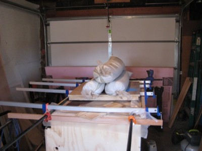

put side up on screw stands I read about earlier. Of course missed one and it landed in PL causing this PL drip you see in the pic
Applying pressure and heat, will check for a diamond in the morning.
