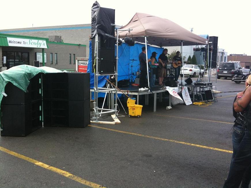

From the other side. 4 T48's (30") and the other Otop stack of 5. Notice the bucket and mop used to clean off wet stage.

That is one hell of a rig for such a small stage, I can imagine your band mates were happy
I was in your area this time last year, would have loved to see and hear your rig.
The scaffolding for the stack of OmniTops looks impressive, but also seems to me it could be a bit wider on the ground, it doesn't look comfortably stable to me with wind or people bumping into it. But then again I know nothing about scaffolding and stacks of cabs.
Re: Hamilton, Ontario Sunday, Aug 8 - The Big Rig is unveile
I took a close look at the scaffolding and it seemed very solid, also it appeared he lagged the feet to the wood on the ground, improving the footprint. It was quite gusty at times and it seemed stable. I didn't yank on it to verify though.AntonZ wrote: The scaffolding for the stack of OmniTops looks impressive, but also seems to me it could be a bit wider on the ground, it doesn't look comfortably stable to me with wind or people bumping into it. But then again I know nothing about scaffolding and stacks of cabs.
More later.
WB is correct. The scaffolding was solidly bolted to the two 2x6 by 4 foot pieces of wood to expand the base solidity. I tried it without and the stability was still good but because it is a safety issue I have no problem with this minor overbuild. I did give both towers a good shake and they felt very solid. It would certainly not blow over in a wind. I didn't want to fly any of the equipment because that level of engineering is beyond me. As is the cost, the time to setup and the overall complexity.

I wouldn't be too sure about that. You have a large sail area suspended high over a realtively small base lever. Without doing calculations I can't say what wind strength would indeed topple them but wind is a force to be reckoned with.fvodo wrote:It would certainly not blow over in a wind.
G East B.E.(hons) Rtd.
Wind is indeed a factor above a certain velocity. I was VERY comfortable with the stability up to at least 35MPH wind. We did not have that kind of wind on that day. The extra wooden base did give an increase in stability that moved me from "It's pretty good" to "No problem!".

Could you elaborate on the Scaffolding for the PA? I like the look of that setup and have spent considerable time trying to figure out a small footprint system such as you have there. Plans, details etc. Thanks....

Seriously, that is some shonky footing for a tall stack. Far better to space the columns out to a good footprint. Footprint is key to countering overturning, but it needs to be capable of resistance to the overturning moment of the wind.
The way the scaffold tree is set on planks there can be no serious resistance to a real wind beyond the capacity of the tree itself. Those are "pin" joints in the even of a blow. They may well be stiff enough to feel very solid with someone yanking on the tree at 5' level but that's the end of their usefulness.
If you wanted it to stand up to scrutiny a metal base would need to be triangulated onto the tree. It could be done without a lot more metal in the scheme of things. You could get clever and make it with arm adjusting side so it could be set up on sloping ground.
Some $$$ for certified engineering but not much more for the fabrication.

And depending on your latitude, you will most definately want to account for the Coriolis Force.
I apologize for the ensuing scaffolding discussion. Thanks to you and WB for sharing, very much appreciated. Still impressed, I wish I could have heard your rig and performance.
