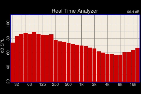

Update of David Stereo Floorstanders..
One of my inspirations for building The Davids was having listened to a set of vintage 1976 "Goliath Corner Horns" for several months last winter while refinishing them for a friend. Several days ago I went to my friends home to re-audition the "Goliaths", as to compare them to The Davids. My conclusion is that the Davids are just as superb as "The Goliaths". My friend concluded that The Davids sounded "sweeter", he thought his "Goliaths" sounded "tinny" (they do have metal horns, mid and tweeter).
I made an unscientific reading with RTA (Studio Six Digital app) on my iPod Touch and the graph is below. (microphone is not calibrated). I am biamping using a subwoofer amp so there is massive amounts of bass even with the gain set very low.

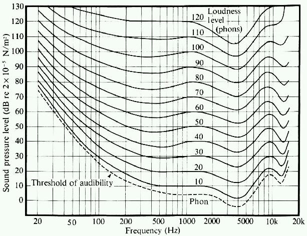

Re: David Stereo Floorstanders... "I Broke The Plans"
Hey Tom...
My buddy has McIntosh Stereo Equipment which has an equalizer of sorts... Low, Mid and High adjustment knobs. I adjusted his midrange down a notch and now he sounds sweet. It's just the equal loudness curve of the ear and brain, a dip around 4000hz to sound right.

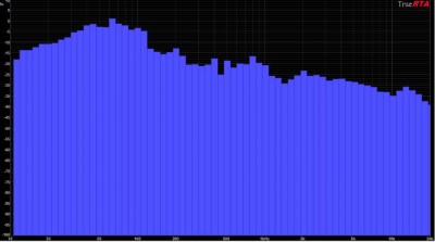

I did some TrueRTA testing today of my "David Stereo Floorstanders". They are corner loaded in a 20x28x8 room and have Tang Band woofers. (I used TrueRTA, Behringer ECM8000, and M-Audio MOBILEPRE USB)
The RTA below is from my listening position, about 15 feet from The Davids, the album is Pomp and Pipes by Dallas Wind Symphony.. The piece is "The Vikings" and is played on a giant pipe organ.
The Davids have no problem going flat to 10 hz. If the music has deep bass The Davids will play it ! They are truly amazing !
CH

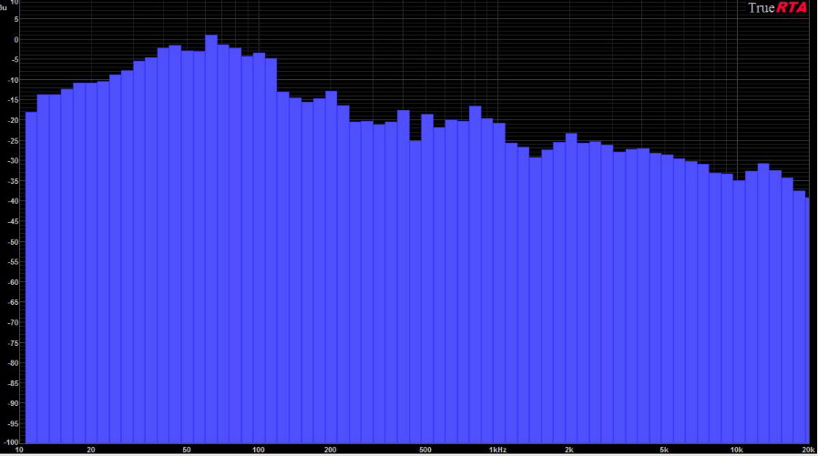

Davids are still running sweet after a year...
Pink Noise in room RTA "Theater Mode" ... http://imageshack.us/f/833/davidtheatermode.jpg/
