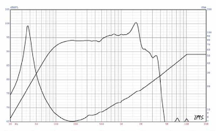

If the 2x Titan 39s slims (16" or 20" depending) fit after I do a mock setup, I'll build them but I have a question about the driver. I first thought about the DeltaliteII 2512's because of their SPL chart and comparing them to the Kappalite-3012lf everyone is recommending, I have to ask why the 3012lf is better than the 2512 if the decibels in the 2512 are higher over the 20-5k hz range?

The Deltalite II 2512 is not in the plans as a recommended driver for Titan 39.
It is however recommended for the OT12. I opted to use the kappalite 3012HO in the OT12 as an "insurance policy" to have a little extra gas.
ahh. Ok. For some reason I just figured tops and bass cabs could have identical drivers. I'll stick with the recommendations and make sure to order the plans.
Thanks to Sydney and netwerks for clearing it up.
