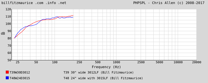

That's arguable. The 24" T48 still beats the T39 from 60Hz+ by about 2db is my guess. The wider T48 like I'm running will beat it all the way down to 40Hz. The 3015LF will also move more air than a single 3012LF will ever think of moving, so the final output of the T48 will be higher as well. That's if I understand everything correctly, which I think I do.
Since you have to reproduce a tone at 45hz 7db louder than a tone at 70hz to percept it as as loud any sensitivity advantage in the upper part of the passband is quite moot since nearly all power goes to the low end of the passband anyways. I suspect your 30" wide T48 will be on average 1db louder or so than a 30" wide T39 above 45hz. As seistres pointed out any advantage in Vd is pointless if you don't need any output below 45hz since both the T48 and the T39 are restricted by power above that frequency.
Below 45hz the T48 is king but since brodave2 hasn't commented on any advantage in extension that the T48s has over his double 18" cabs I suspect that he doesn't need a lot of output below 50hz and since that is the case the T48 loses it's point.

I'll wait for Bill to step in and smack me down, but my understanding of Vd was that given the same or similar sensitivity, it was the final answer in maximum output. Vd is Sd*Xmax and the increase in xmax also increases the Vd and allows a 3012HO to generate about 3db more output than a 2512 in an OT12 despite essentially the same sensitivity. If Turntablist and SiesTres are correct in their assertions, I'd expect both drivers to produce the same max output. 15" drivers have roughly the same Sd, so xmax alone can often be compared, but Vd is more useful when comparing drivers with different cone sizes. Larger Sd will typically equate to higher sensitivity in a driver's operating range.
Wattage, in terms of output, I always understood to be specific to the driver and largely dependent on xmax as well. A driver with 6mm of xmax and 600W of power handling can simply take more heat than a driver with 9mm of xmax and 450W of power handling. Higher power handling does not always equate to higher xmax as far as I've seen, and I'm not sure that 300W always equals the same excursion on drivers with similar sensitivities.
Posts: 28967
Re: 2 OT 212, 4 titan 48 photo
#28 Post by Bill Fitzmaurice »
SeisTres wrote:if sensitivity is the same for both, and they both take the same wattage, it doesn't matter if it's a 10" or a 15". .
That's a big if. How much power a driver can use is almost always determined by Vd, not Pe. The recommended maximum voltage for the 3012LF and 3015LF is not the same, for this reason.
